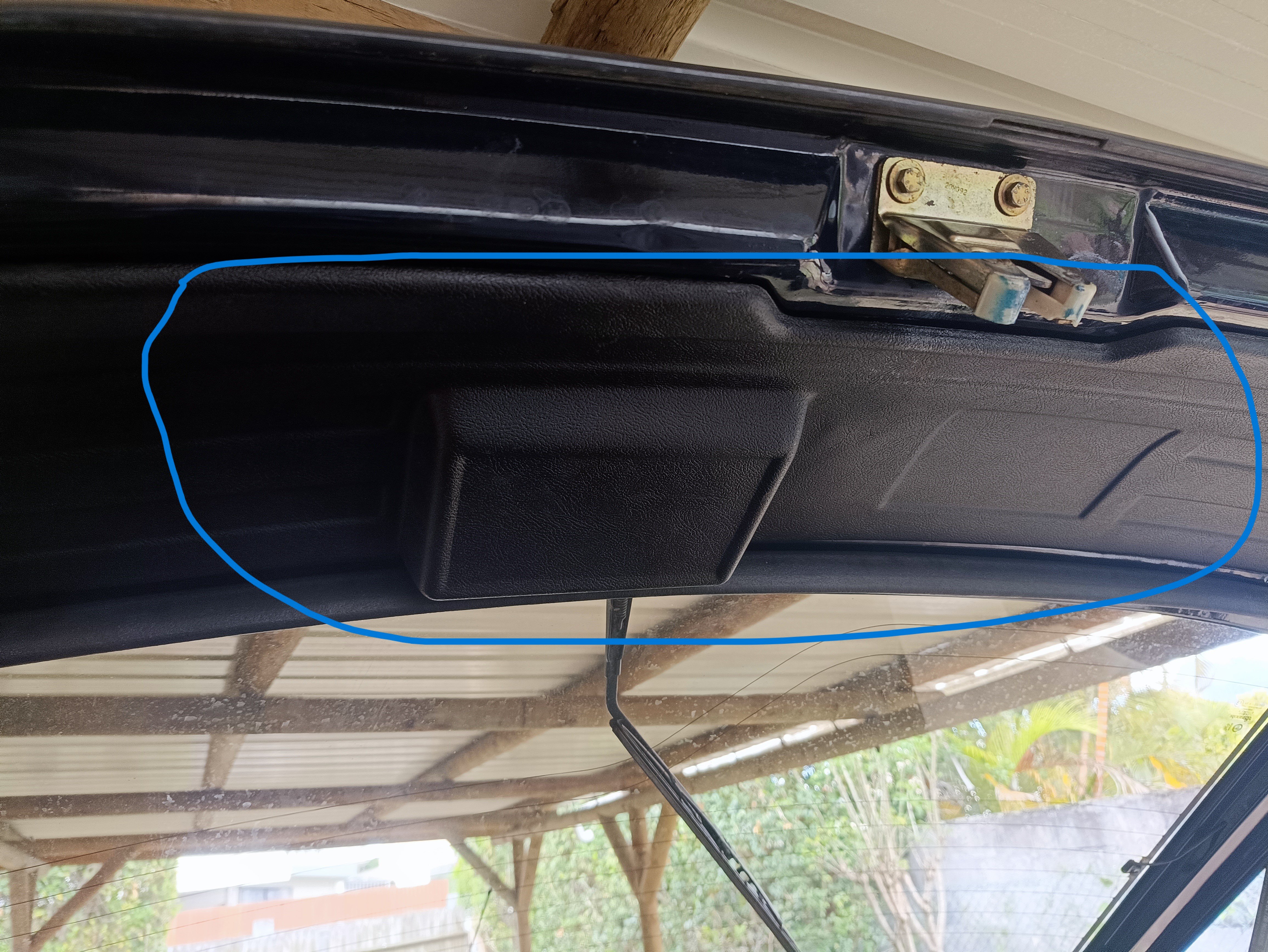

AndreMUR 0 Posted November 15, 2022 Can anyone help me figuring out how to remove the inner boot cover? (to access the rear wipper motor) Thank you Share this post Link to post Share on other sites
Steve205 14 1 Cars Posted November 15, 2022 It is held on by plastic fasteners. There are about 9 holding it on. Gently prise out the corner with a flat screwdriver or something similar. Fastener will pop out. Follow all way round. Be gentle though. Stephen Share this post Link to post Share on other sites
Gohn 62 Posted November 18, 2022 you dont need one but get yourself a panel clip remover, makes it easier Share this post Link to post Share on other sites
