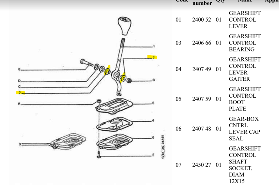

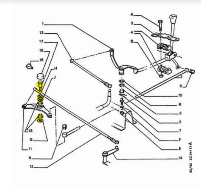

pugfrank 14 1 Cars Posted July 11, 2022 (edited) Hi all, Just looking at the Baker BM kits to rectify sloppy gear change, Dont suppose anyone can tell me which item numbers they are on service box please? Looking at getting 205 BRONZE GEARSTICK PIVOT BUSHES and 205 BRONZE L-LINKAGE PIVOT BUSH KIT plus GEARCHANGE RODS (3-ROD KIT) Thanks in advance. Edited July 11, 2022 by pugfrank incorrect mark up on image Share this post Link to post Share on other sites
pug_ham 240 3 Cars Posted July 11, 2022 The usual main cause for a sloppy gearstick imo is the subframe pivot (#9 in the graphic) being loose. You've highlighted the correct bushses for the gearstick #7 but the L Linkage pivot bushes are item #18. g Share this post Link to post Share on other sites
pugfrank 14 1 Cars Posted July 11, 2022 3 minutes ago, pug_ham said: The usual main cause for a sloppy gearstick imo is the subframe pivot (#9 in the graphic) being loose. You've highlighted the correct bushses for the gearstick #7 but the L Linkage pivot bushes are item #18. g Thanks G, Remarked image correct. Share this post Link to post Share on other sites
Tom Fenton 1,524 Posted July 12, 2022 Rather than ordering blind I'd have a good check round first. Often it is the link rod ball joints worn out as well as the bell crank as Graham mentions. All small amounts of play but it all adds up. Share this post Link to post Share on other sites
pugfrank 14 1 Cars Posted July 12, 2022 6 hours ago, Tom Fenton said: Rather than ordering blind I'd have a good check round first. Often it is the link rod ball joints worn out as well as the bell crank as Graham mentions. All small amounts of play but it all adds up. Thanks Tom, Yes that was the idea to check all the areas to ensure I locate the wear and tear on the components and ensure im getting bits I need from Baker BM, the 3no kits from Baker comes to circa £100.00 Share this post Link to post Share on other sites
