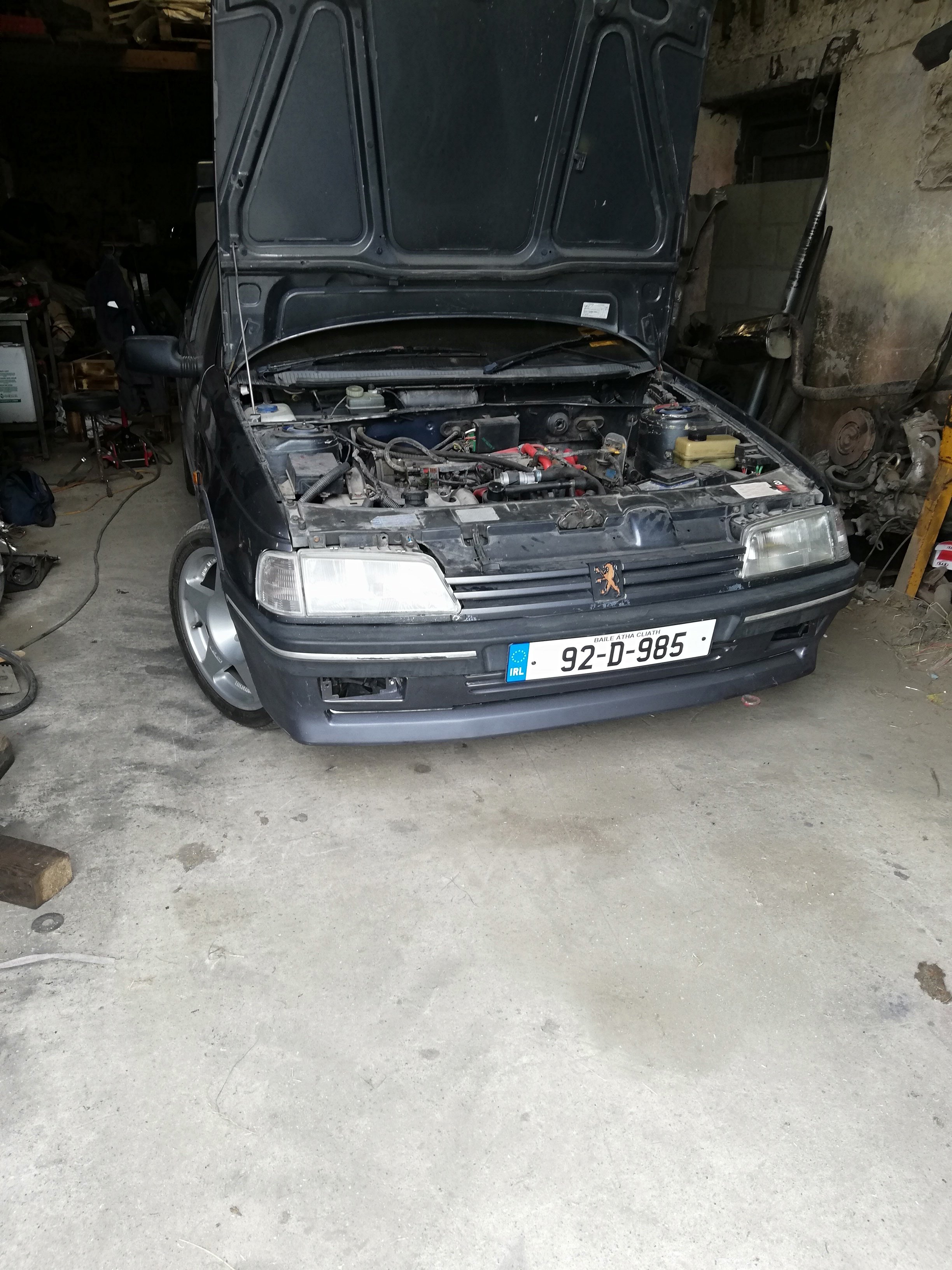

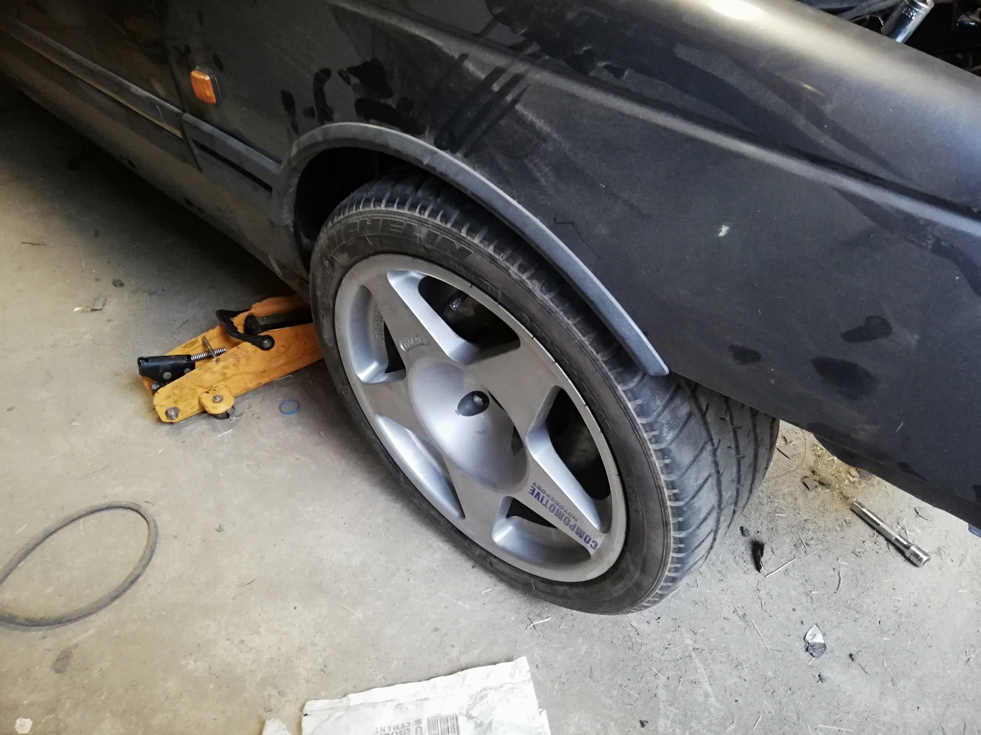

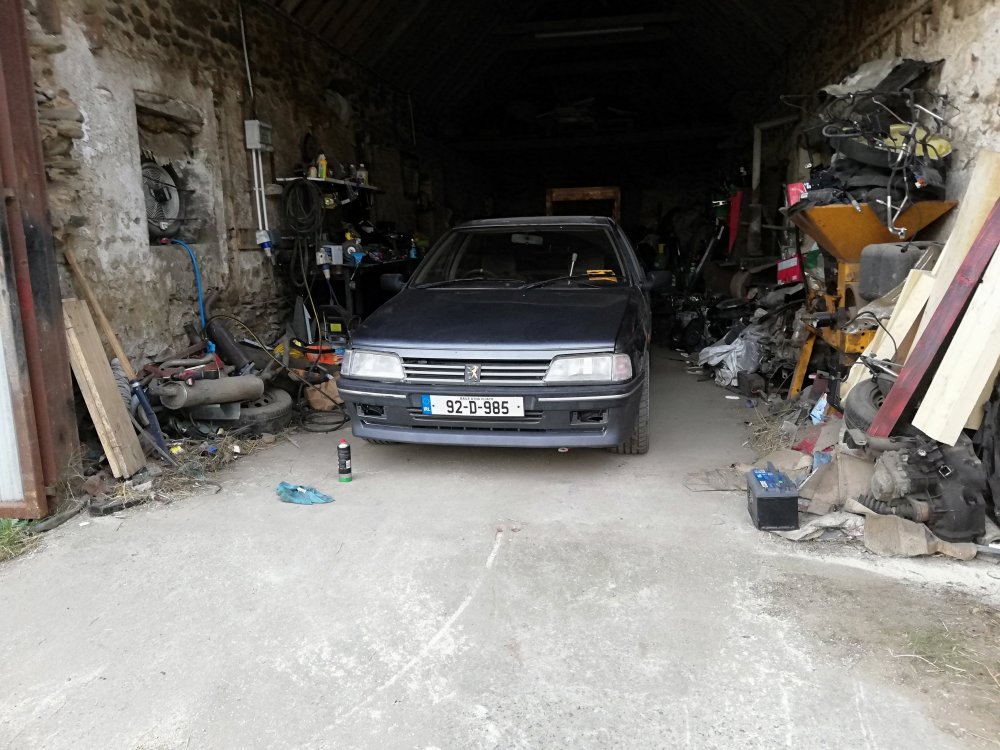

IRISH_MI16 2 Posted February 4, 2022 My 405 mi16 as it could be seen at the start of 2020 around February I think. For a better understanding it had went through it NCT in October 2019, following that life got in the way yet again. December 2019 I jumped ship from a s*itty relationship and met my partner now (turns out a unsporting drain on your life and finances is not good for project progression) Roll around to March and the world goes into lockdown. So I bring the mi16 to my best mates shed to pull the engine and fit a 4 branch pug racing manifold... Well that was the intention Share this post Link to post Share on other sites

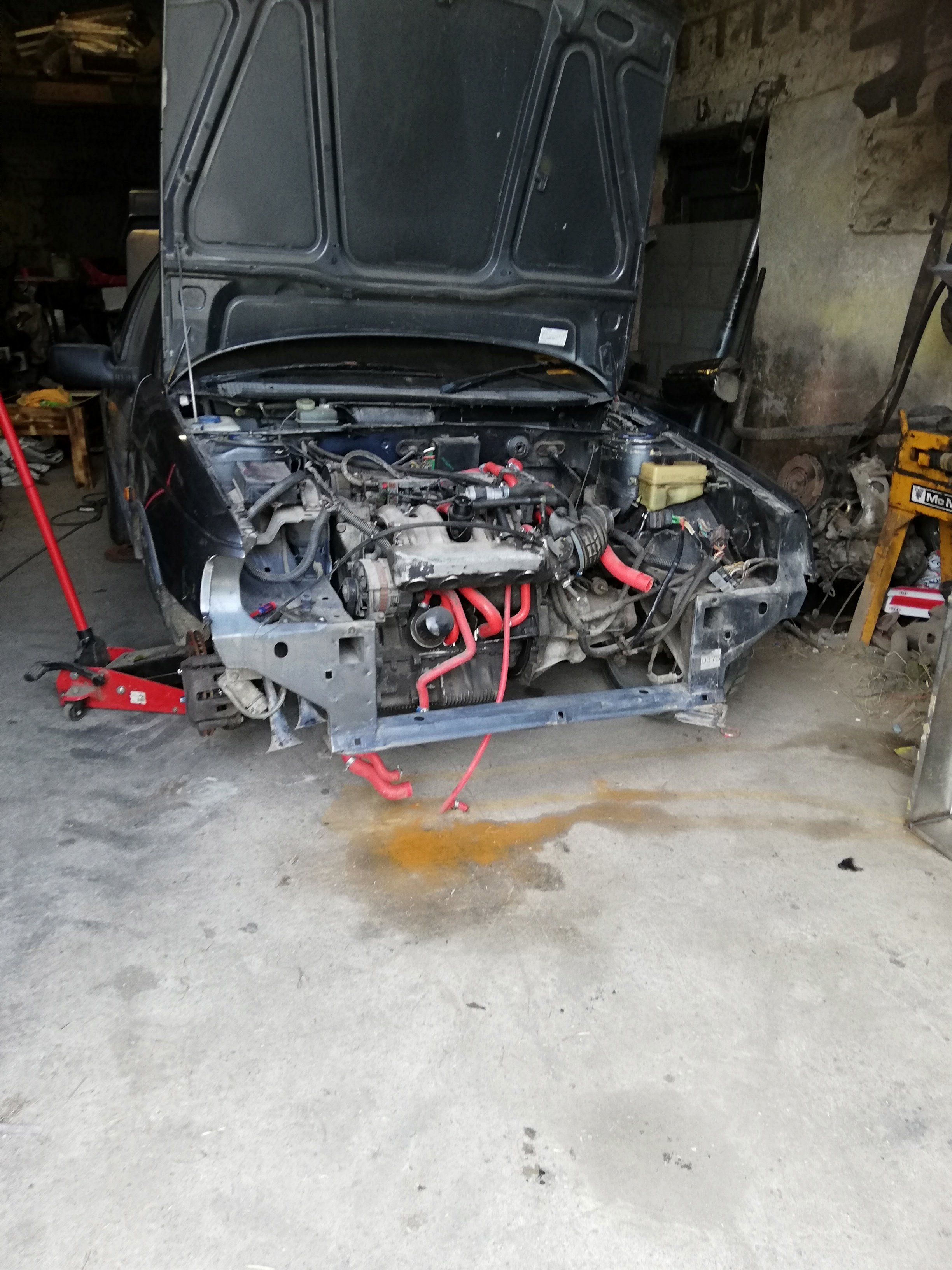

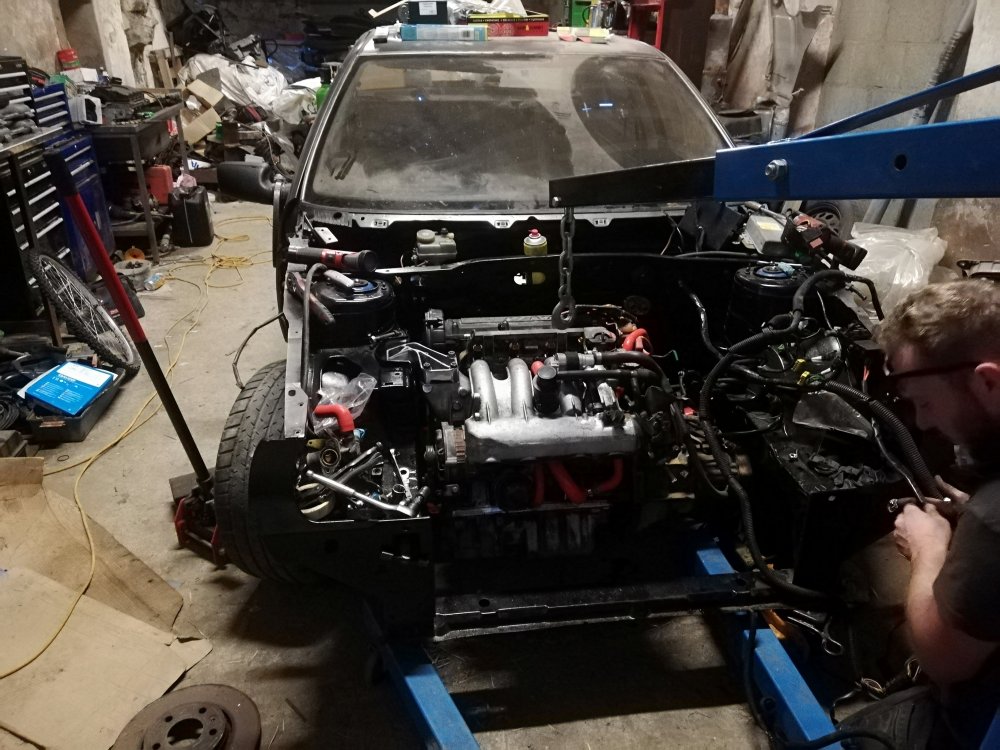

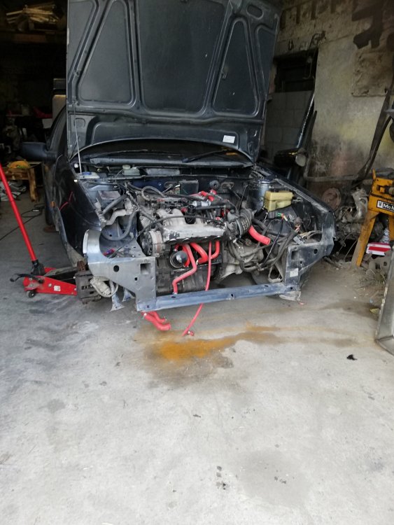

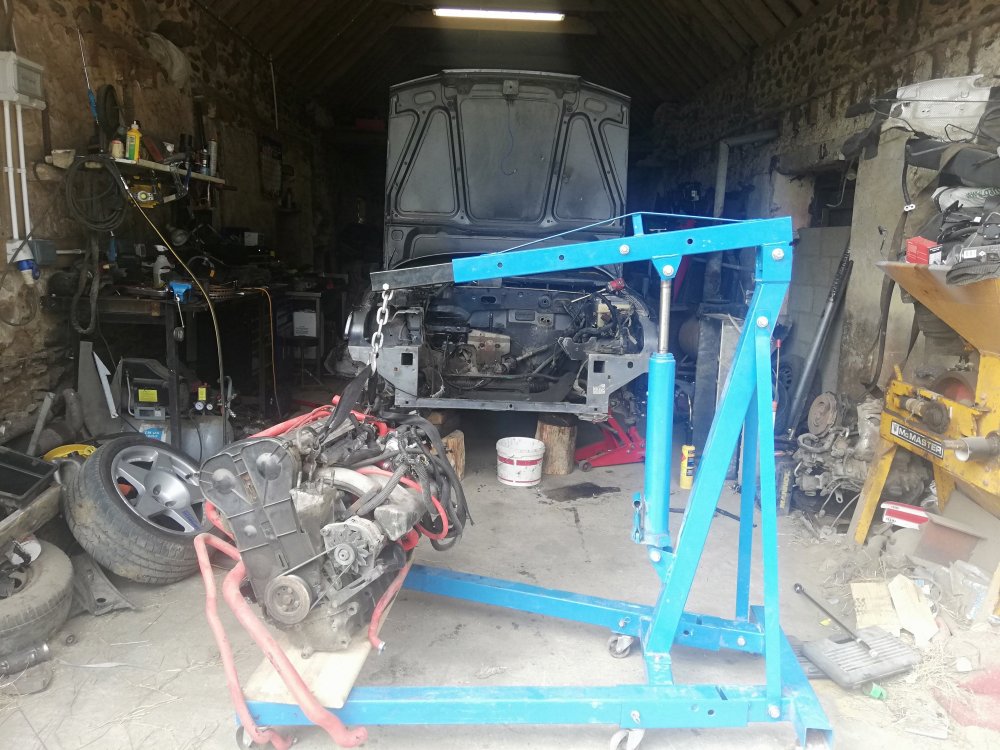

IRISH_MI16 2 Posted February 4, 2022 Down to my mates shed, we had the engine out in 1 hour 20 minutes, It took alot longer to make room for the 405 in there to be honest. Word of warning this will be a fairly picture heavy forum Share this post Link to post Share on other sites

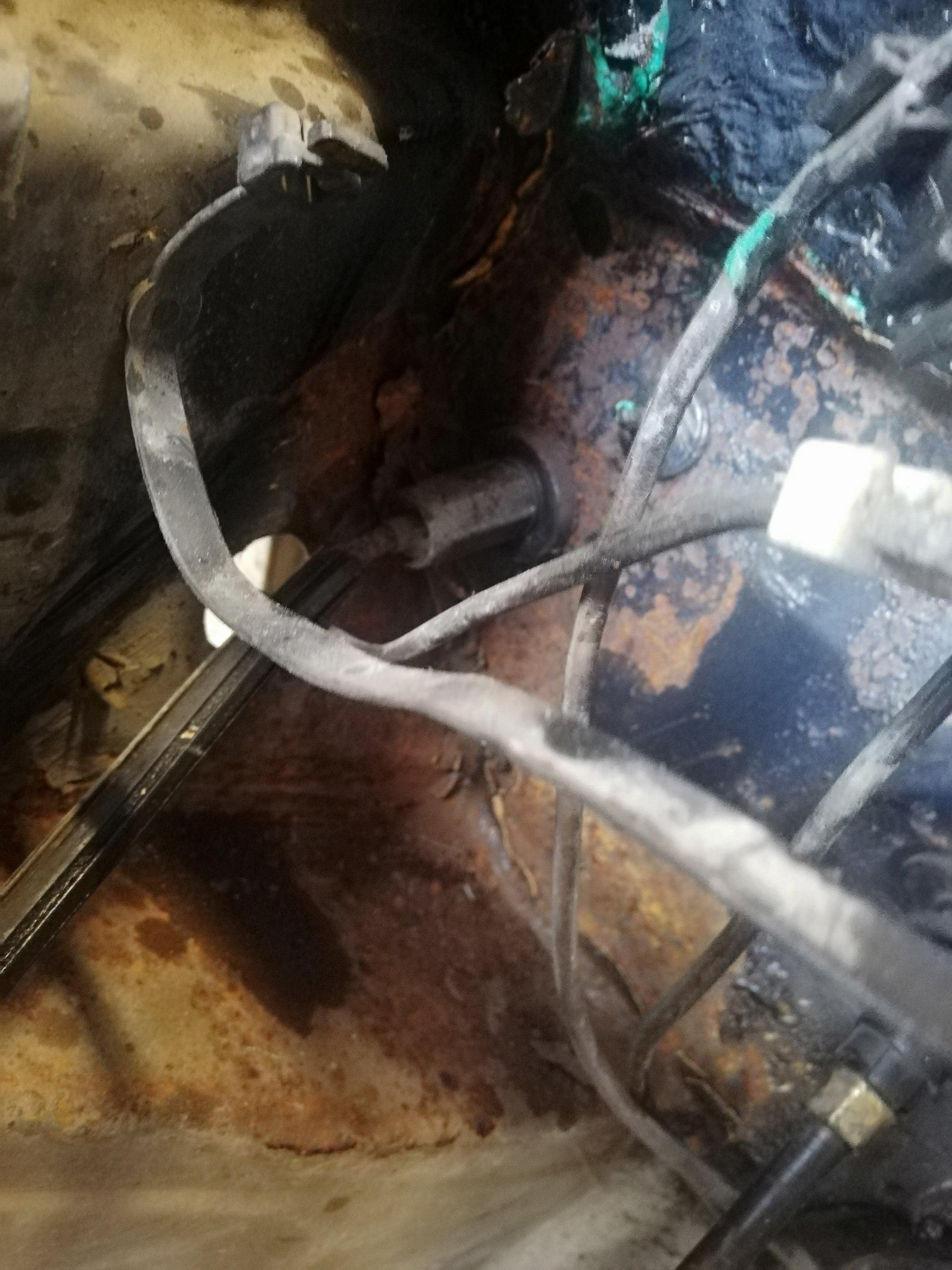

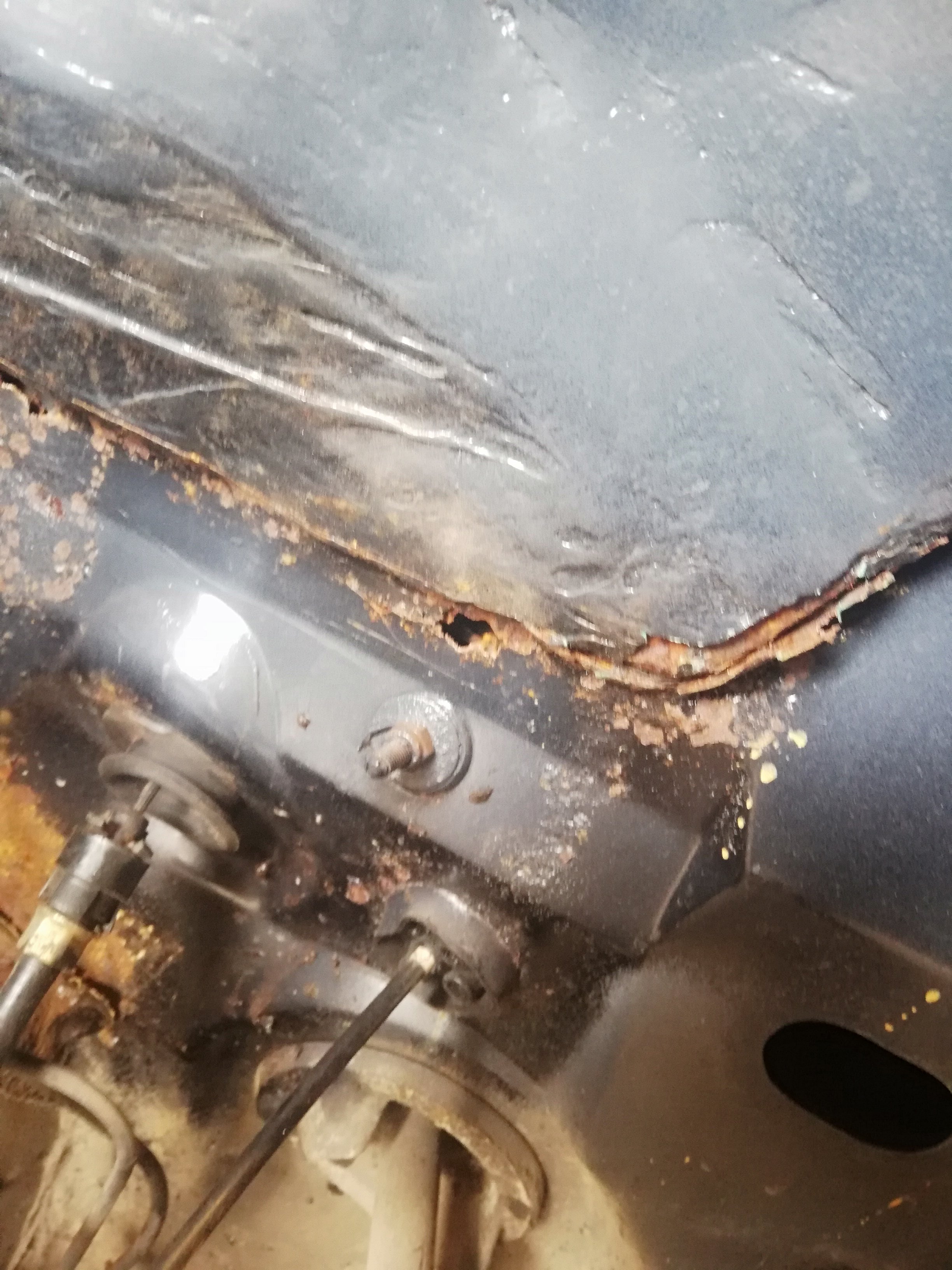

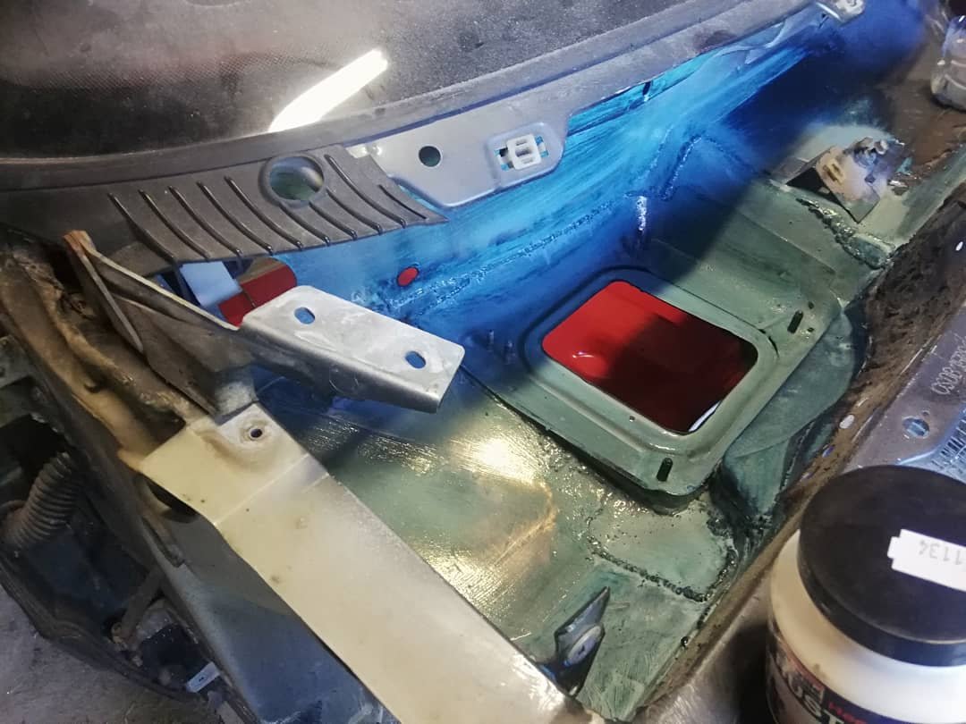

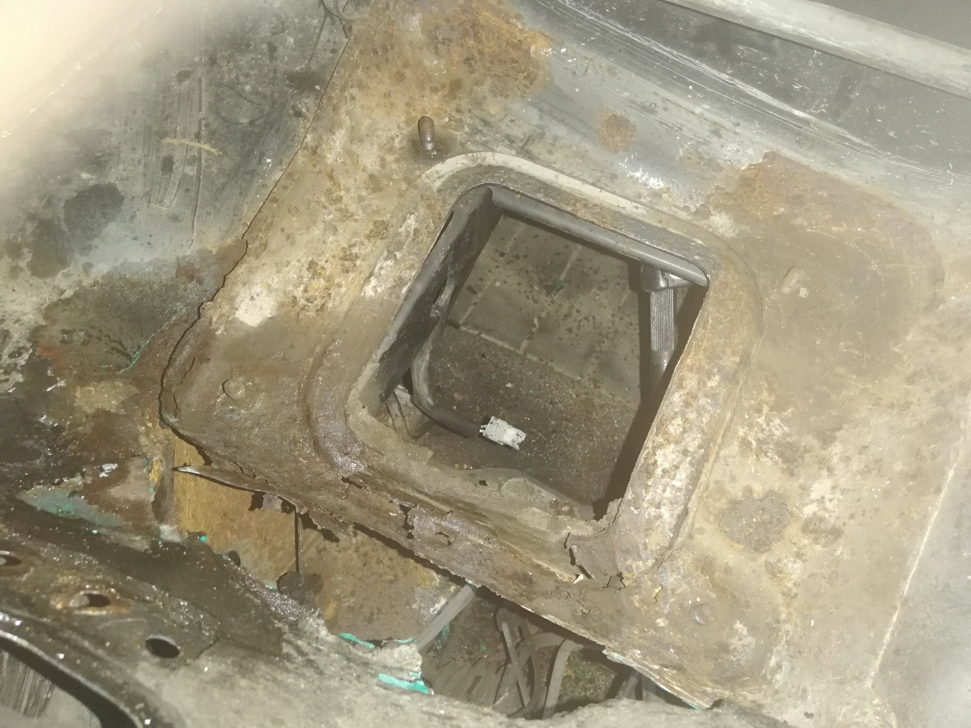

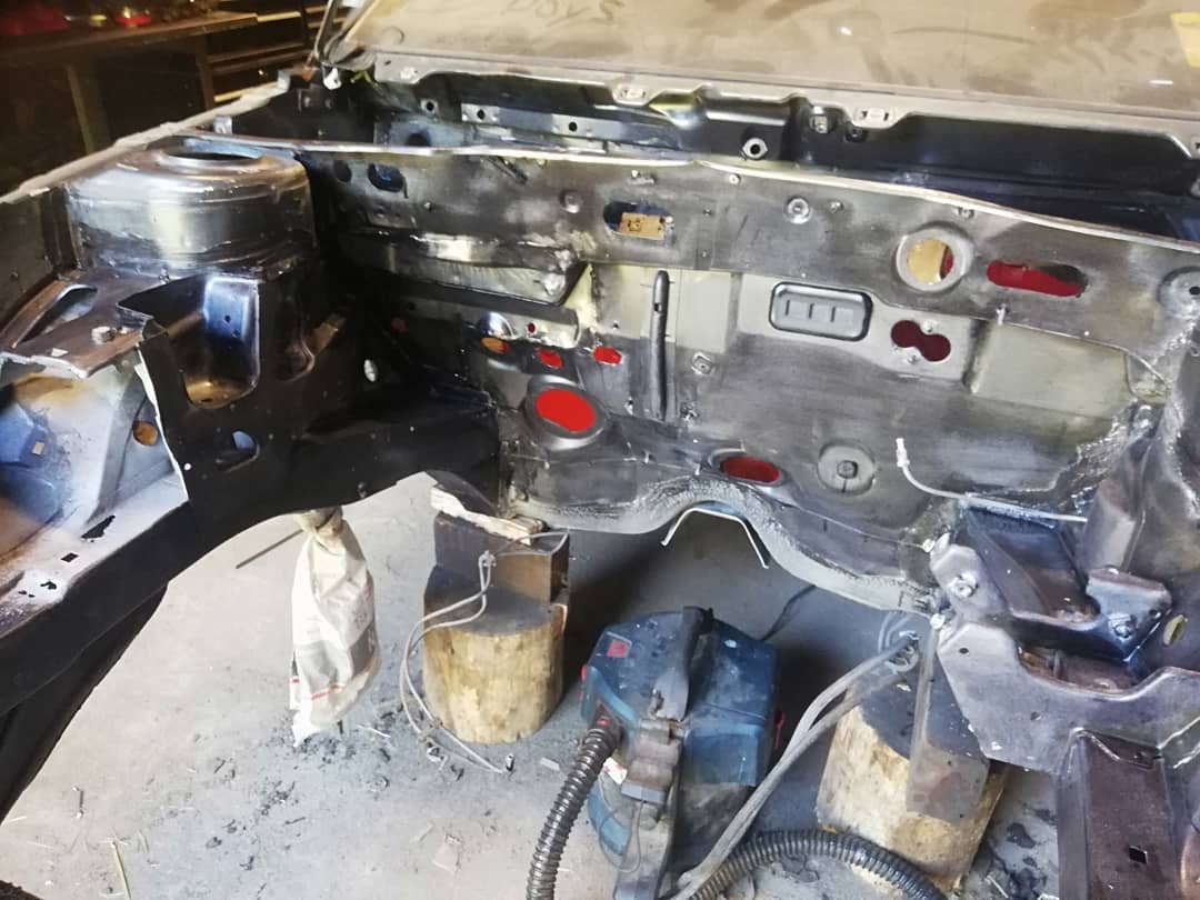

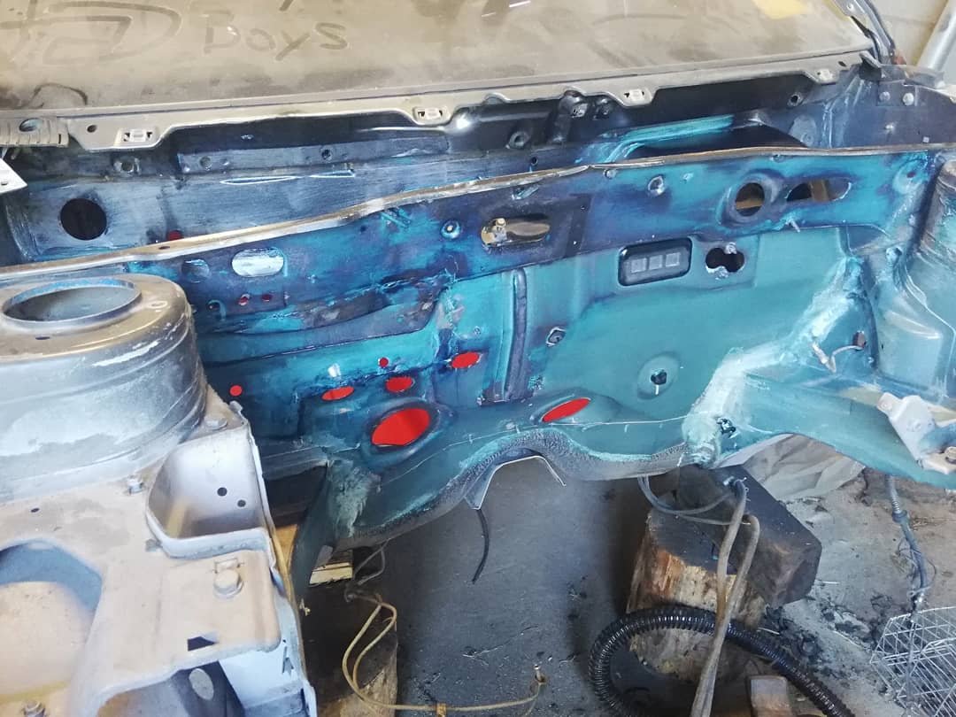

IRISH_MI16 2 Posted February 4, 2022 Then we discovered the horror of what was waiting for us. I'd given the car to a mechanic in 2016 to get it test ready and repair some rust in the bulkhead/firewall. Turns out all he had done was stuff it full of filler and paint over it. This discovery changed the whole trajectory of what I had planned on doing. Que what essentially was a full strip down bar the roof lining and back axle. Share this post Link to post Share on other sites

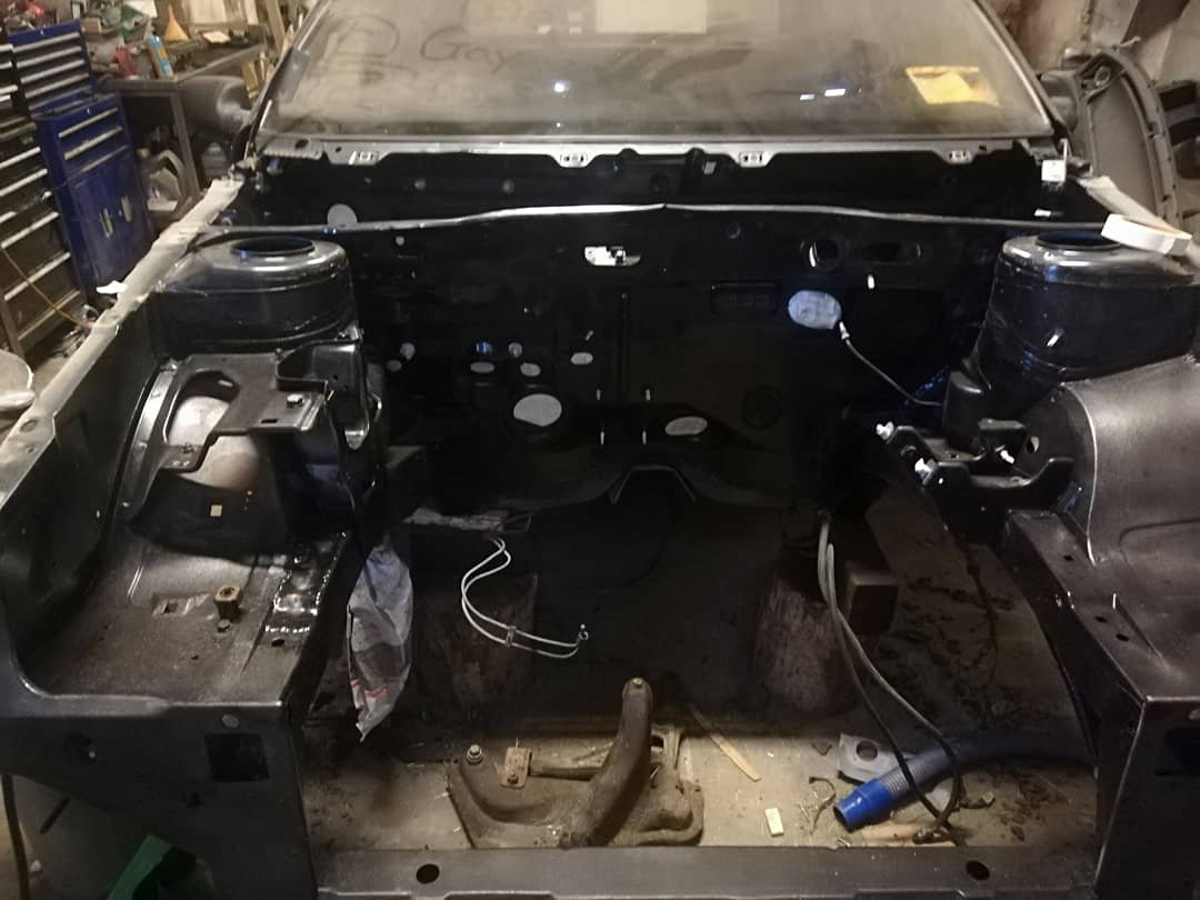

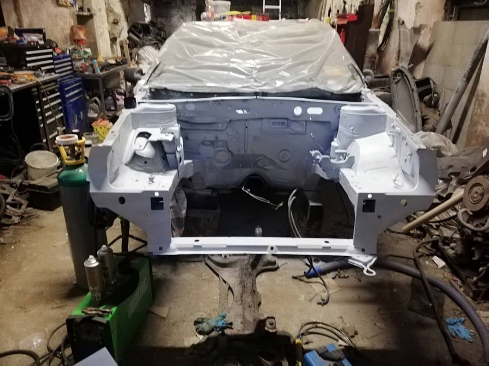

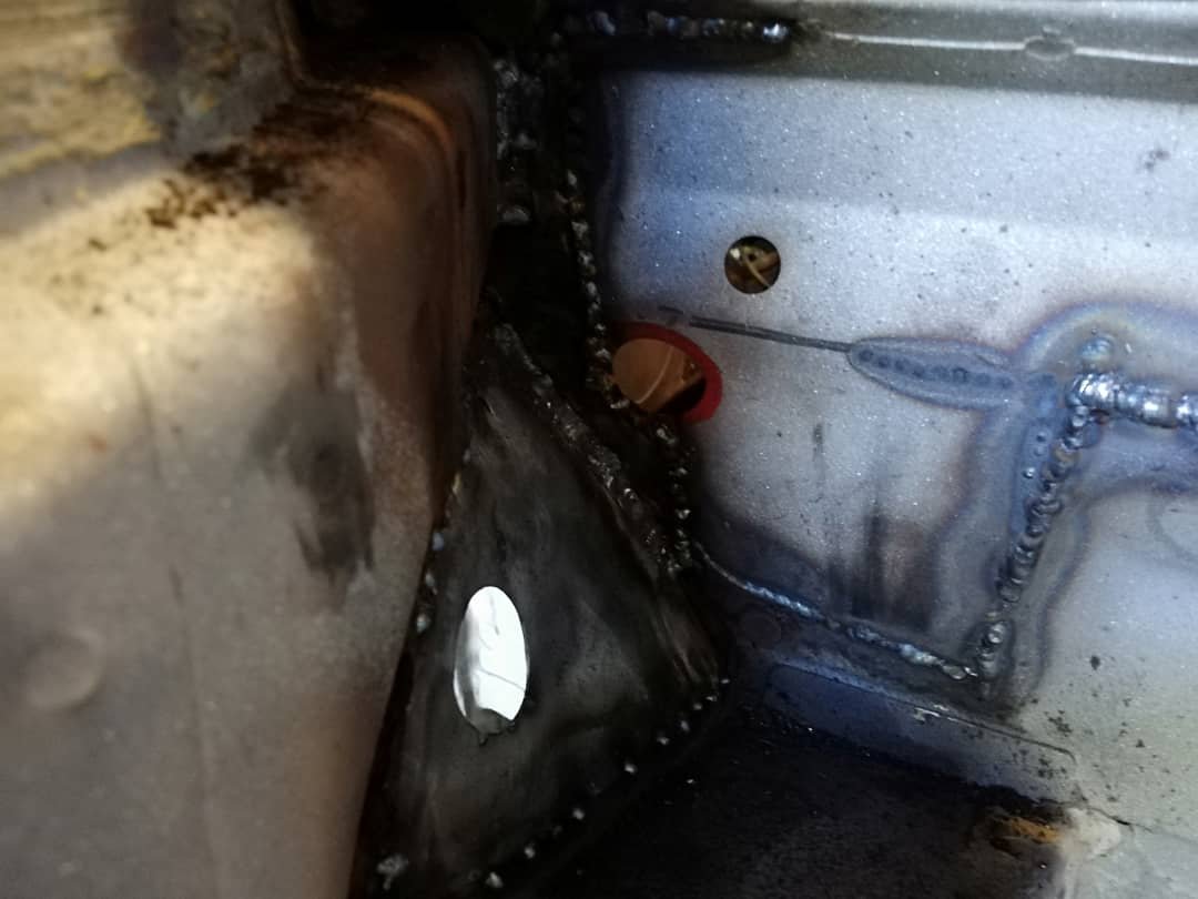

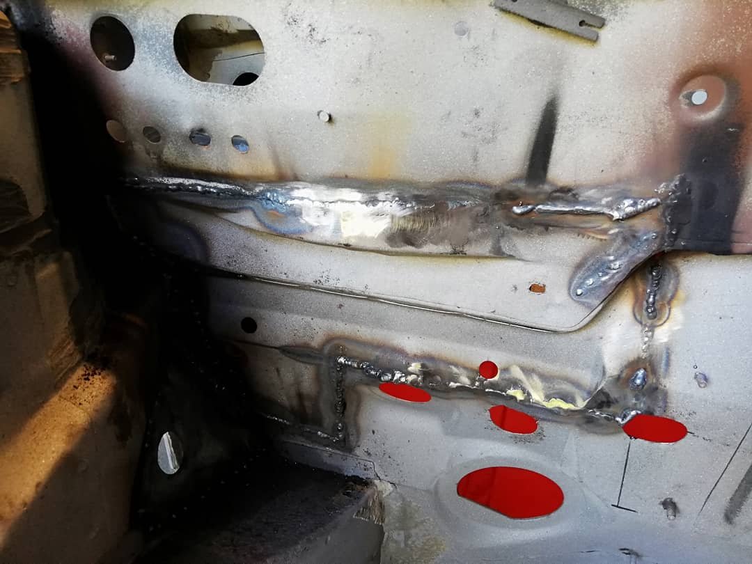

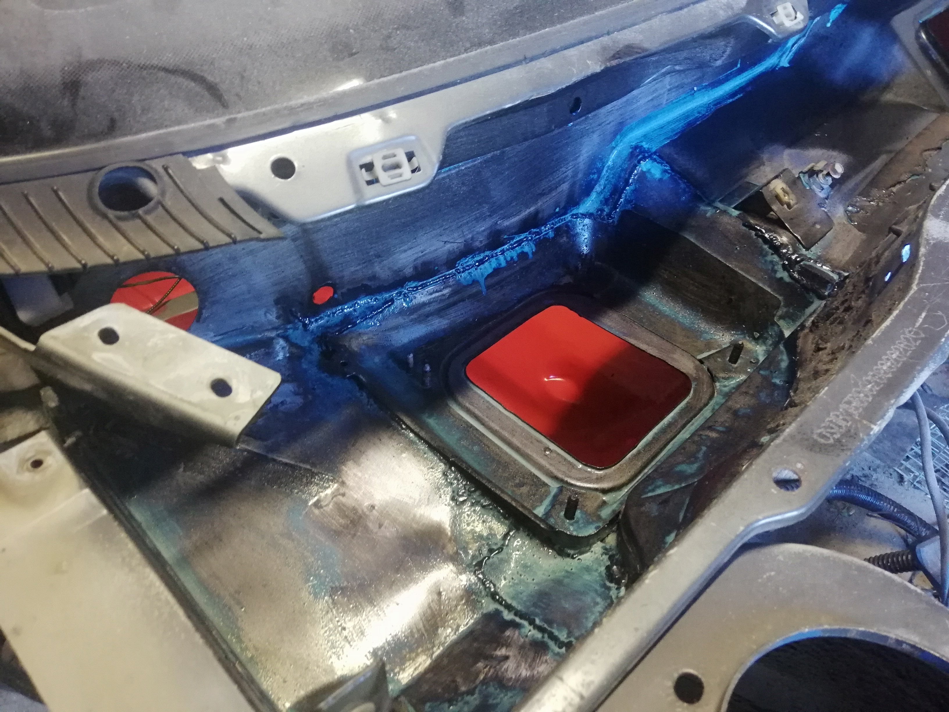

IRISH_MI16 2 Posted February 5, 2022 Thankfully Bryan is talented with a welder and took on the un-enviable task of welding my car back together and making it safe to drive. But firstly I had to get the interior out of it and sandblast the engine bay. Then Bryan got to work welding Share this post Link to post Share on other sites

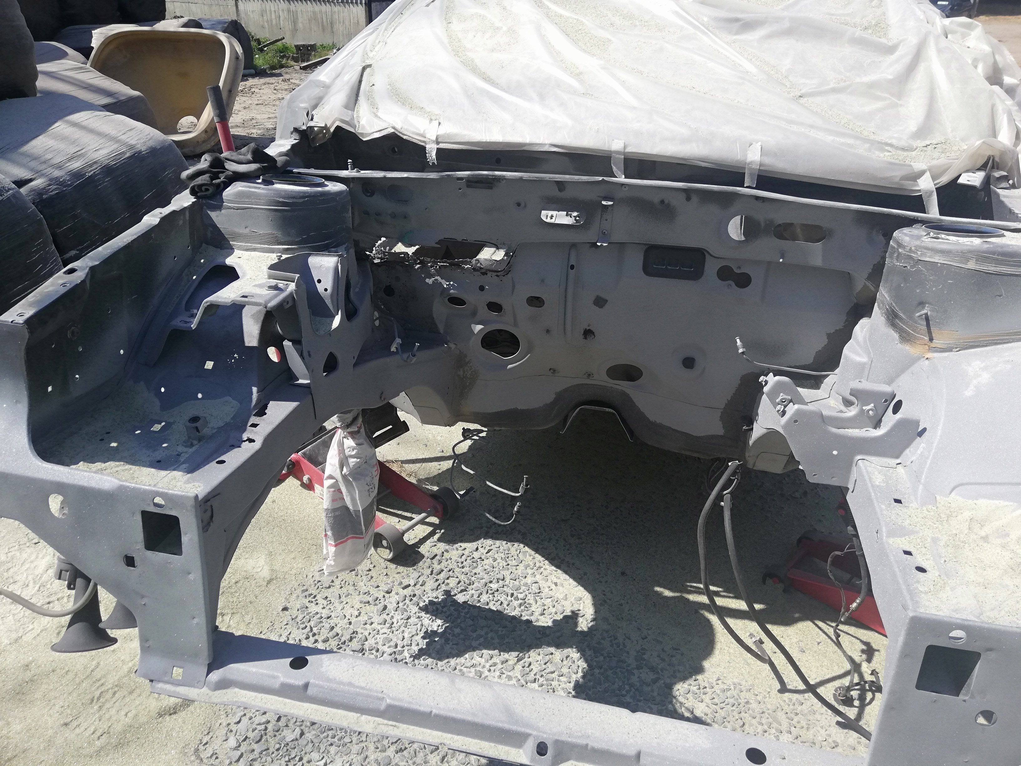

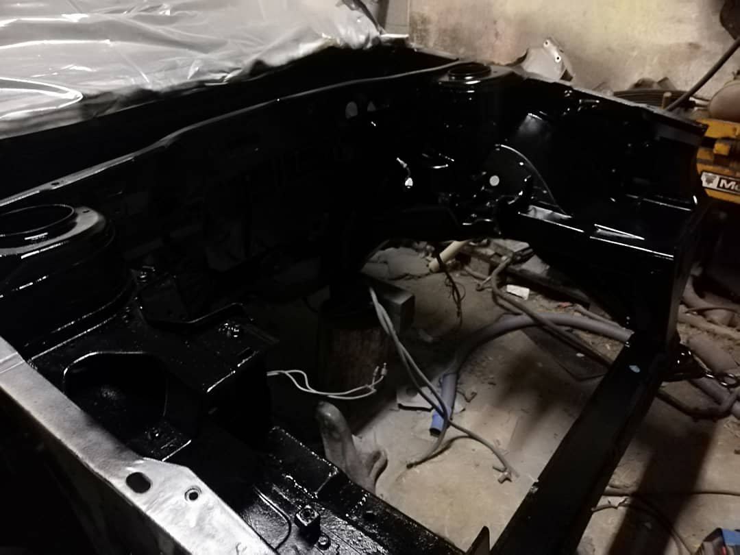

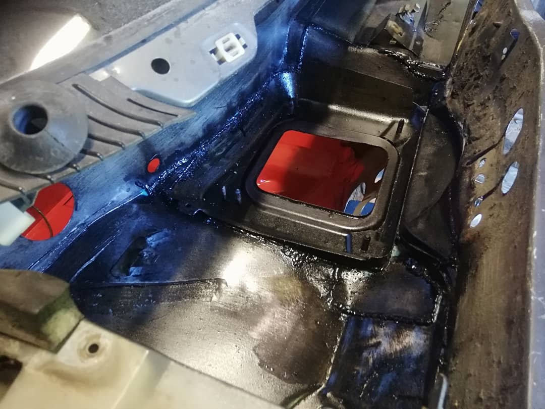

IRISH_MI16 2 Posted February 5, 2022 Can't give him enough credit for putting it back together. He wasn't overly happy with the welds but they are strong so I'm happy. Once welded I set about doing some rust prevention measures as the engine bay had sat as raw unpainted metal for about two weeks. After some searching around locally I found Granville rust cure. Worked pretty well. Then a few coats of primer, and 6 coats of gloss black then a few coats of clear Share this post Link to post Share on other sites

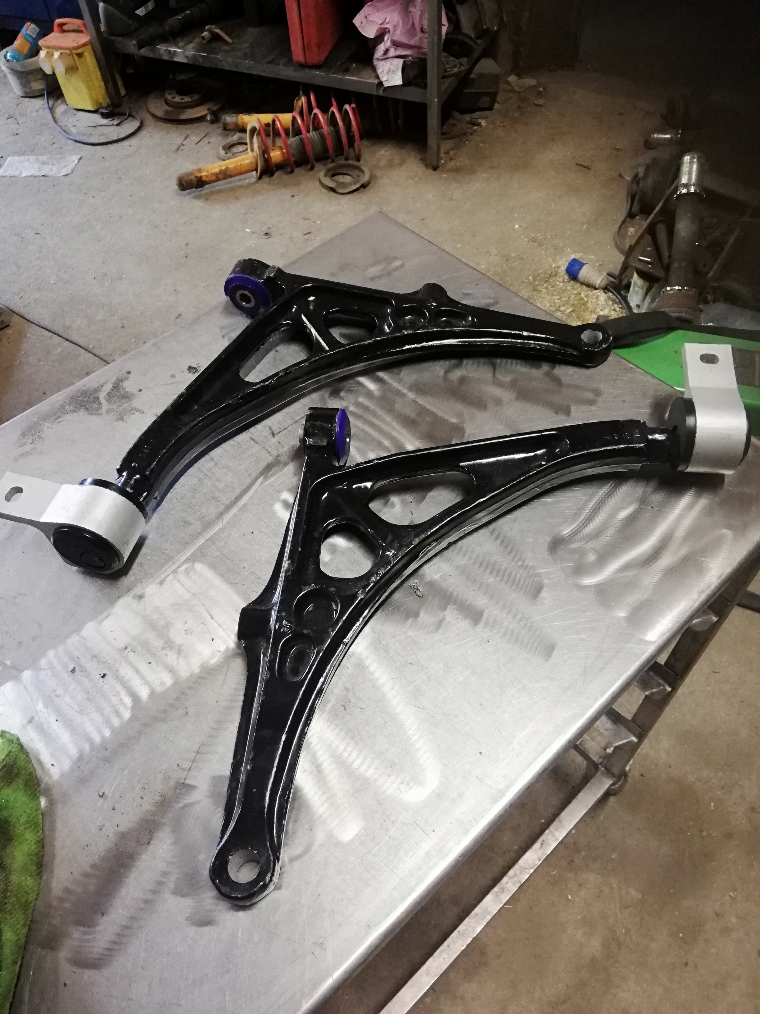

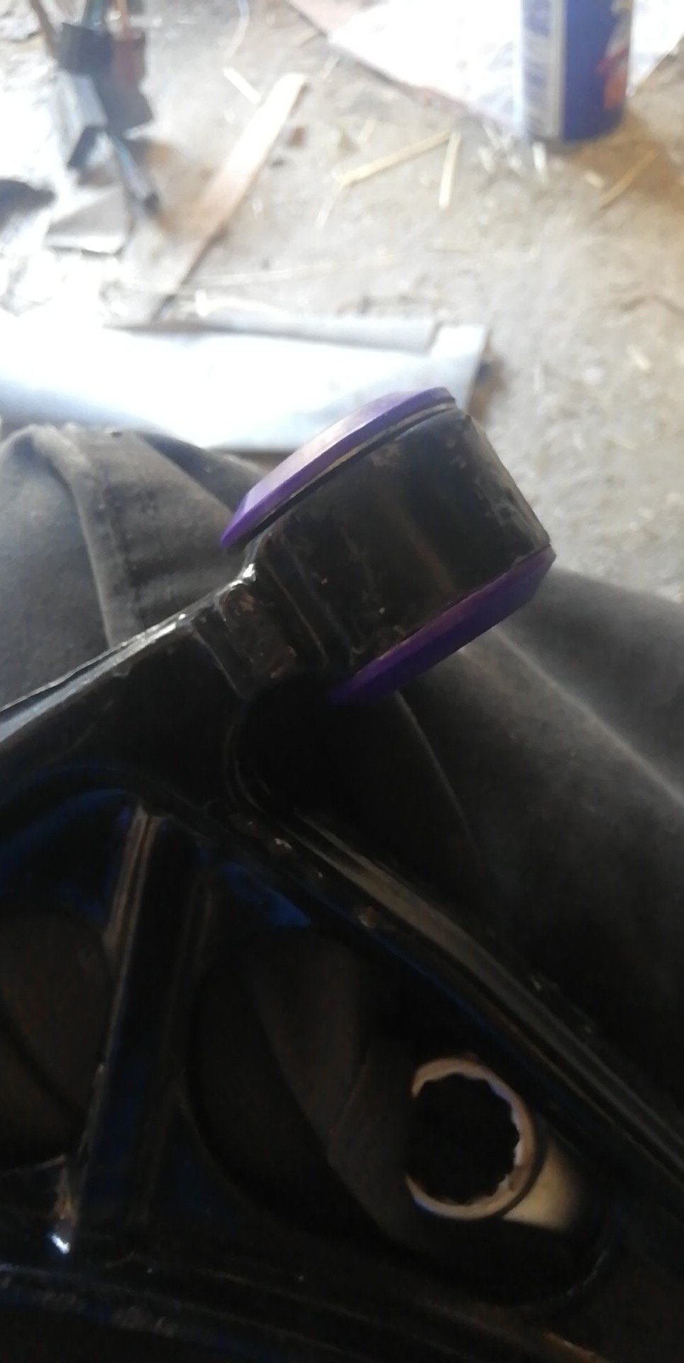

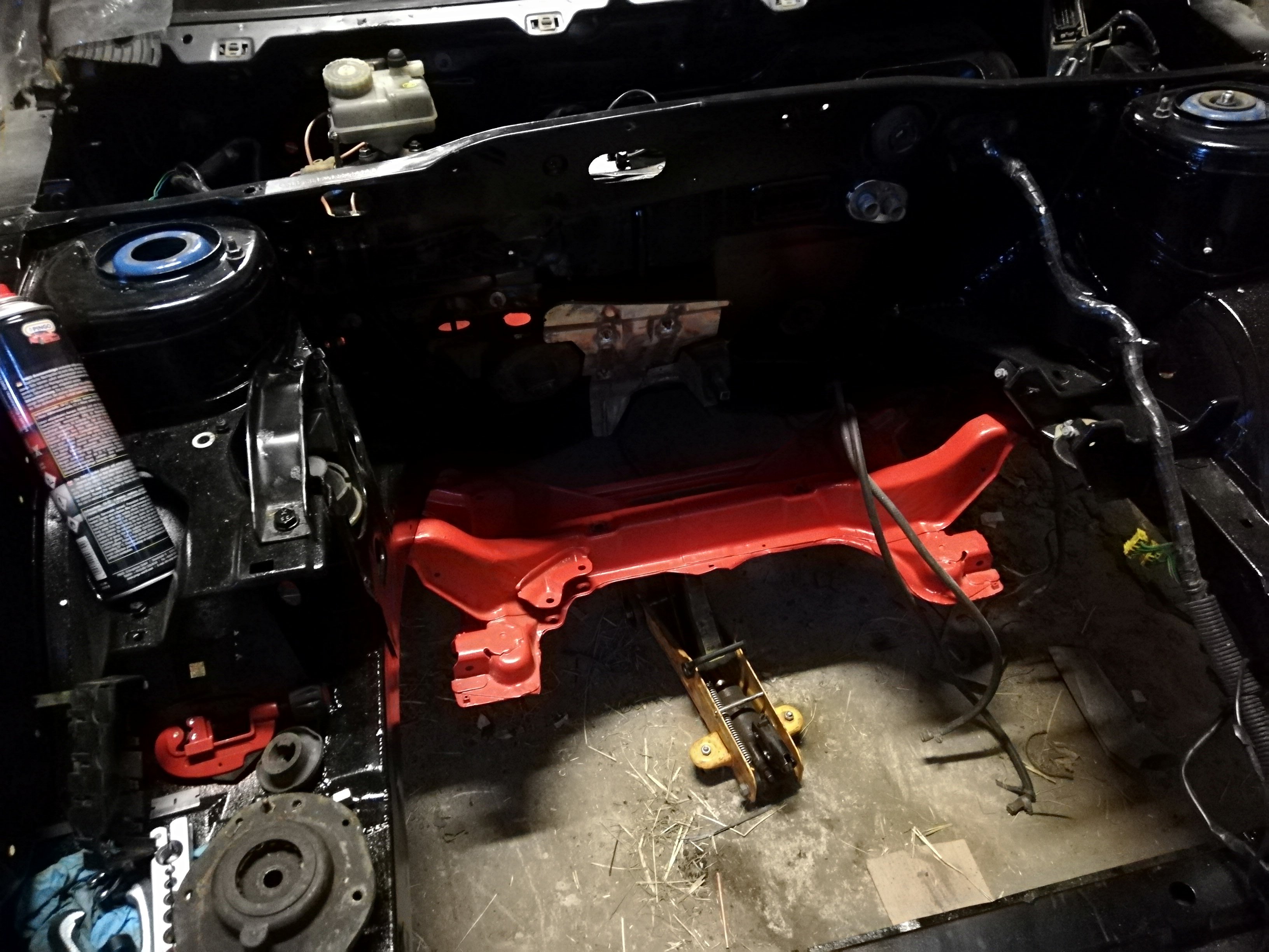

IRISH_MI16 2 Posted February 5, 2022 After paint I got refitted the front subframe. Since there was no powder coaters open at the time I used traffic orange rust paint, looks good and will keep it protected for the timing being. Then onto the wishbones, Cleaned painted and fitted with powerflex 306 polybushes. Share this post Link to post Share on other sites

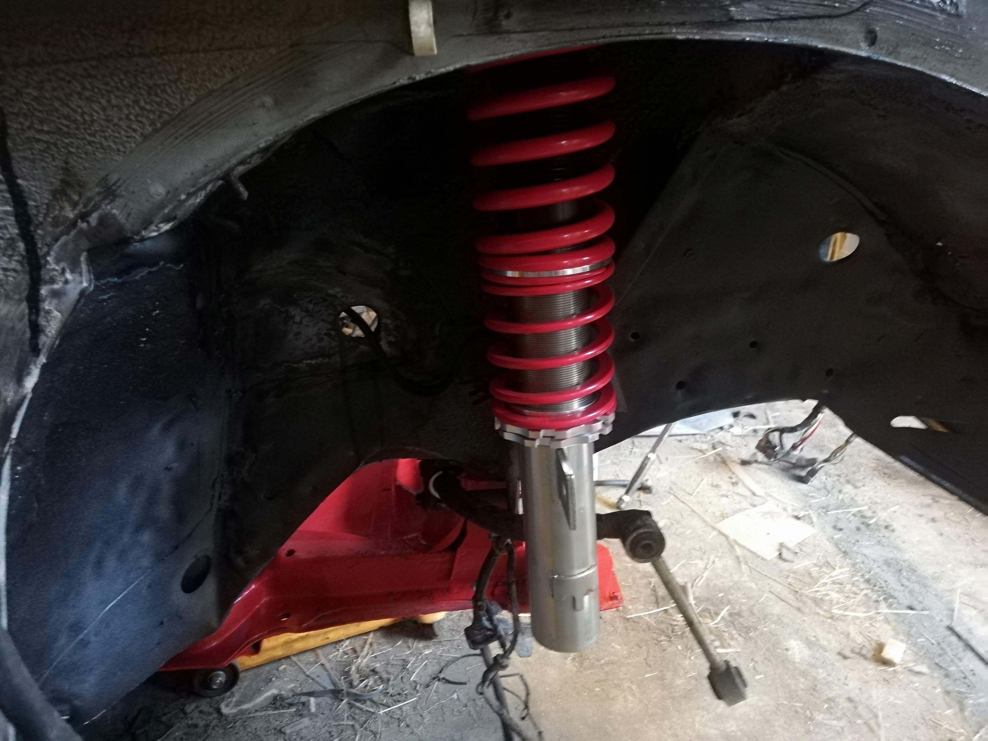

IRISH_MI16 2 Posted February 5, 2022 Temporarily fitted the front coilovers, budget TA Technix from a 306 to get it rolling. Also had new wheel bearing fitted and new brake lines made. In between all that I get the floor of the interior cleaned up and painted and a new (20k mile) interior loom fitted too Share this post Link to post Share on other sites

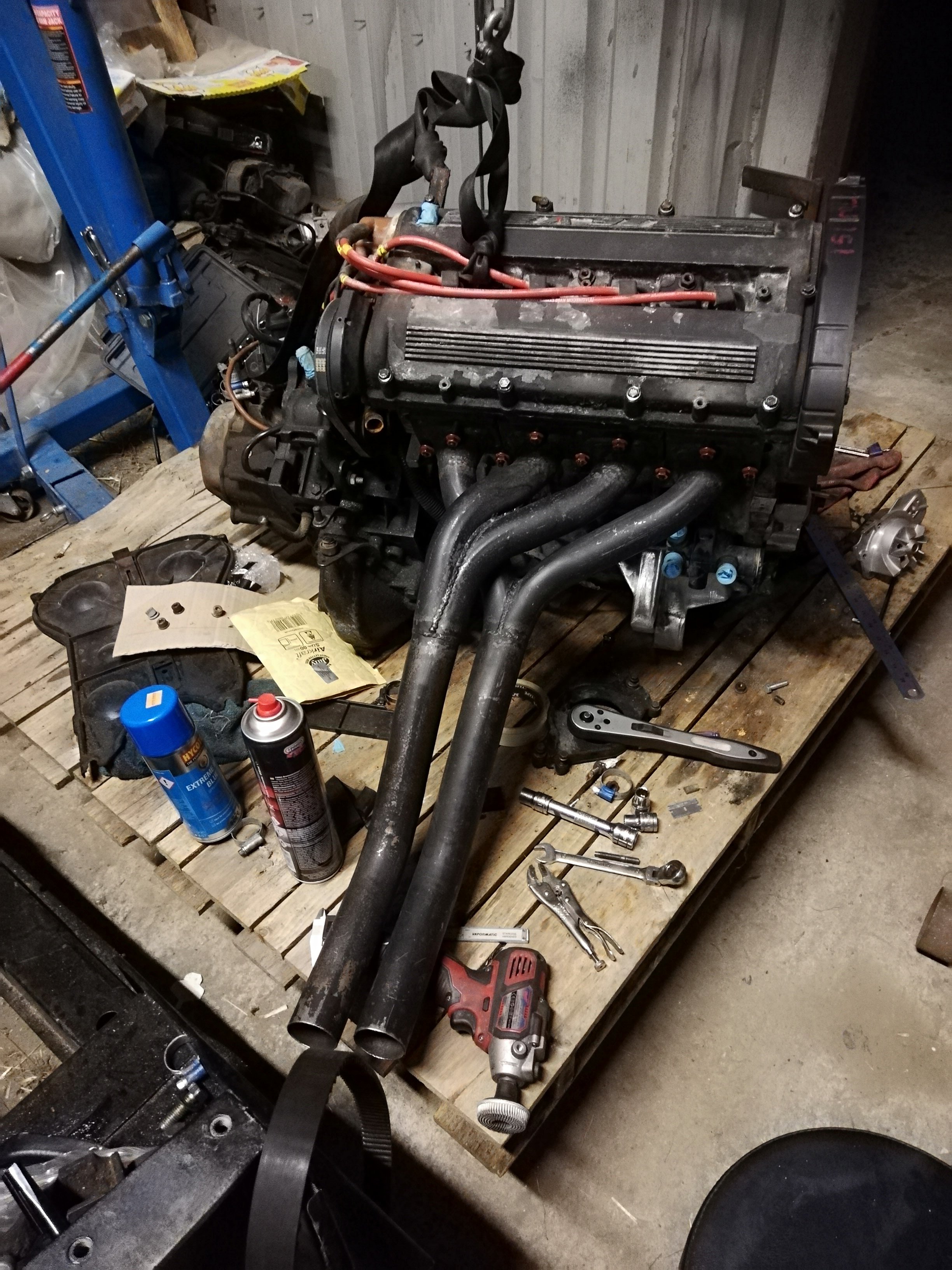

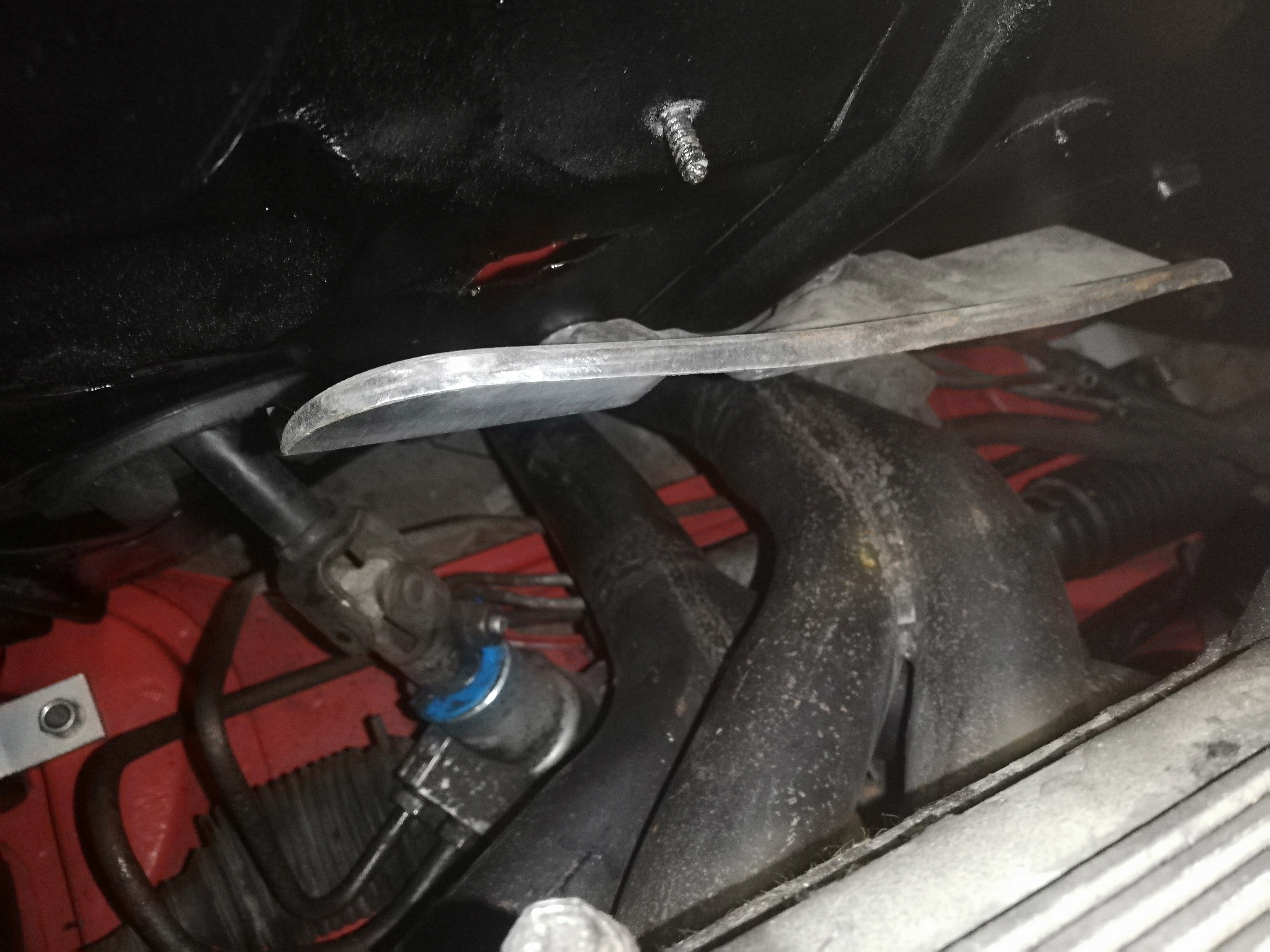

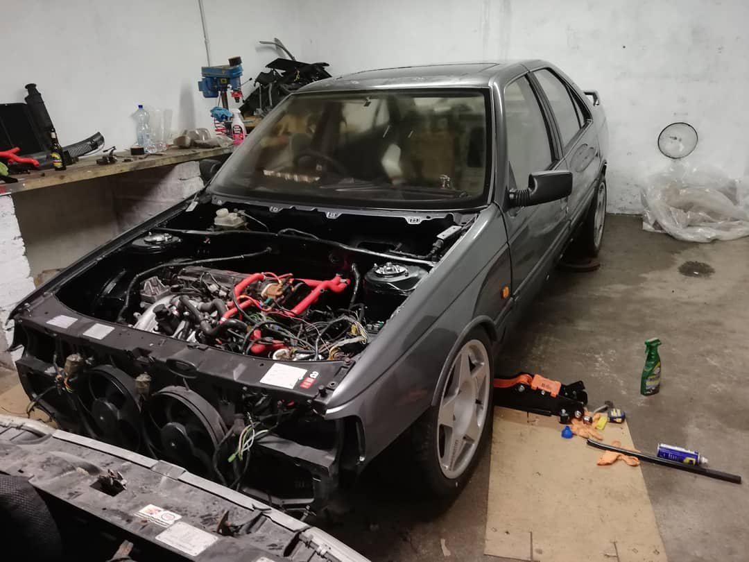

IRISH_MI16 2 Posted February 11, 2022 Next up was fitting the 4 branch exhaust manifold dropping back in the engine The manifold is a great fit as to be expected from Miles. Share this post Link to post Share on other sites
IRISH_MI16 2 Posted February 12, 2022 In-between all that work I got the interior floor painted, subframe painted, wiring loom back in, and lots of other little jobs. Also got the engine fairly well plumbed up Share this post Link to post Share on other sites

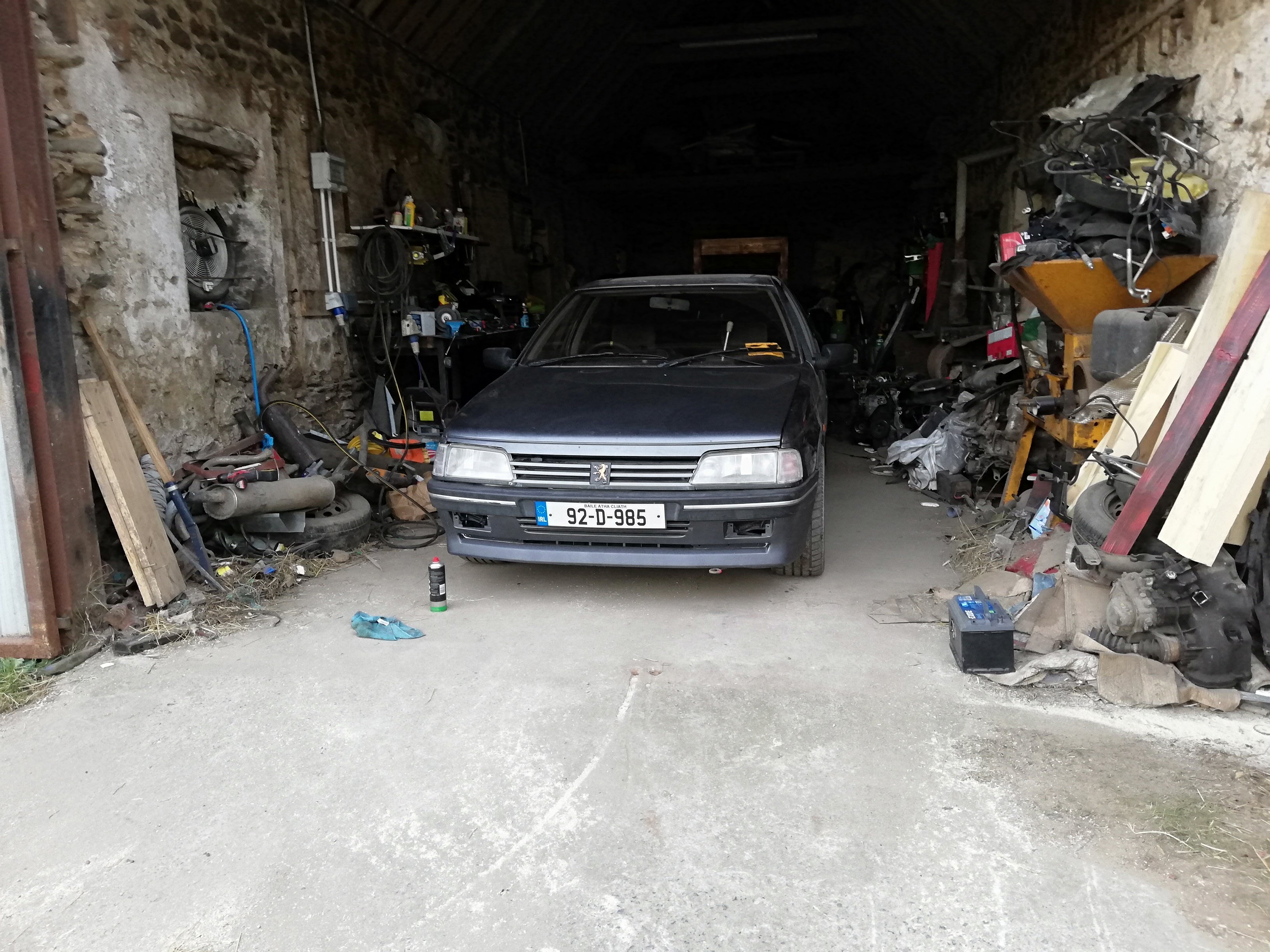

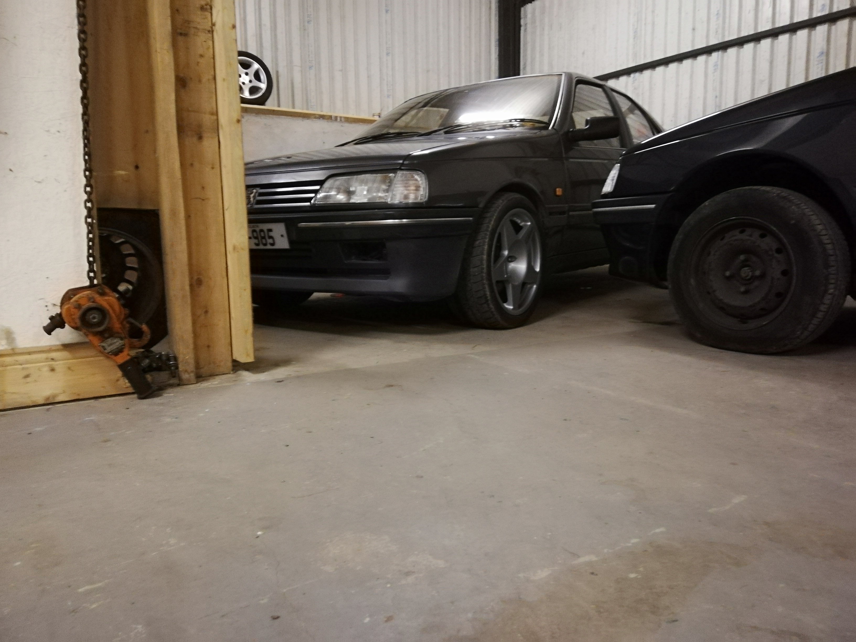

IRISH_MI16 2 Posted February 16, 2022 To my shed it went and the end of 2020 before I went to Deutschland to visit the missus. Before it got there though, I had to clean up the place. Thankfully there was a skip conveniently in the yard and a powerwasher in my shed. Share this post Link to post Share on other sites
