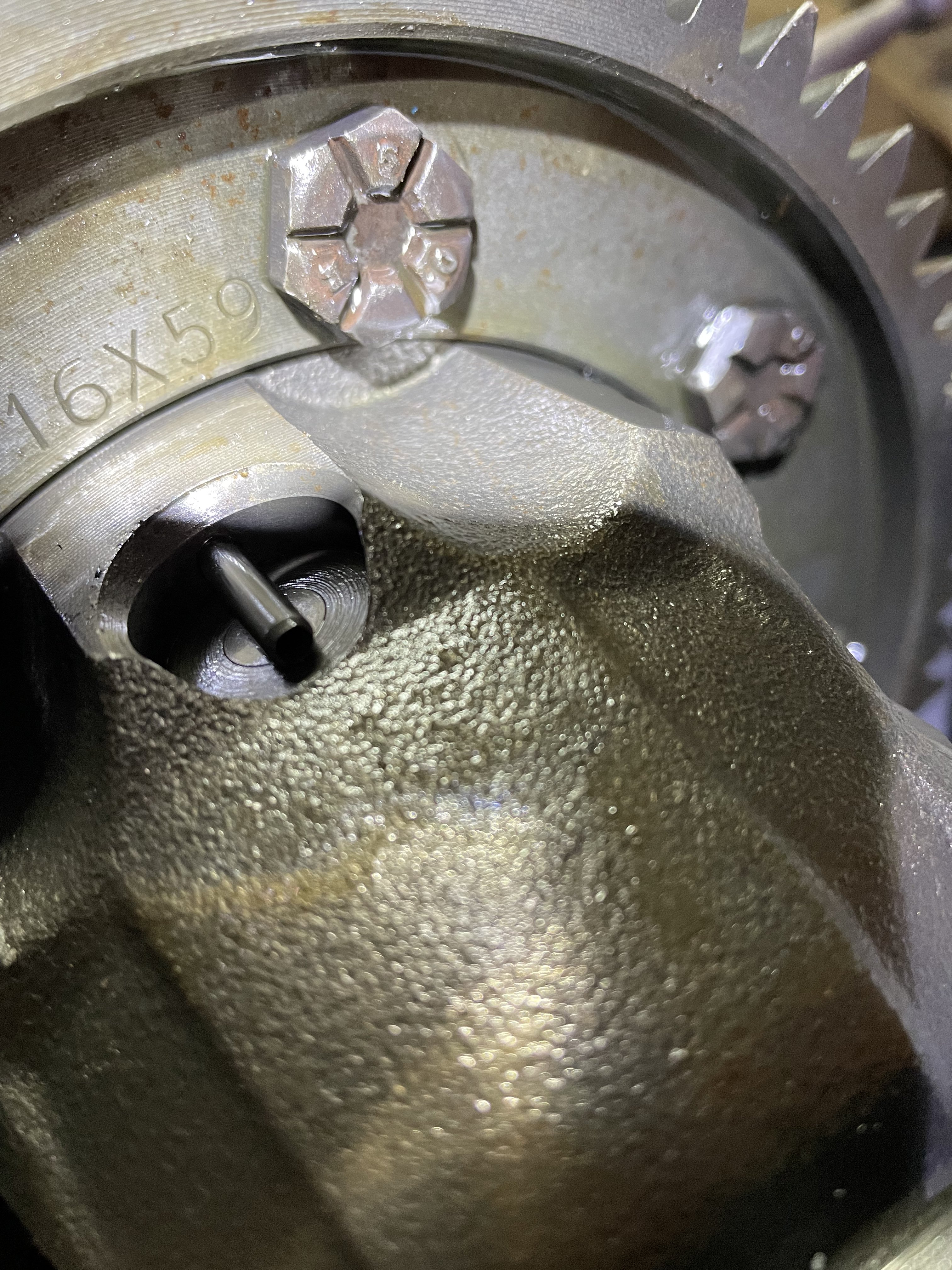

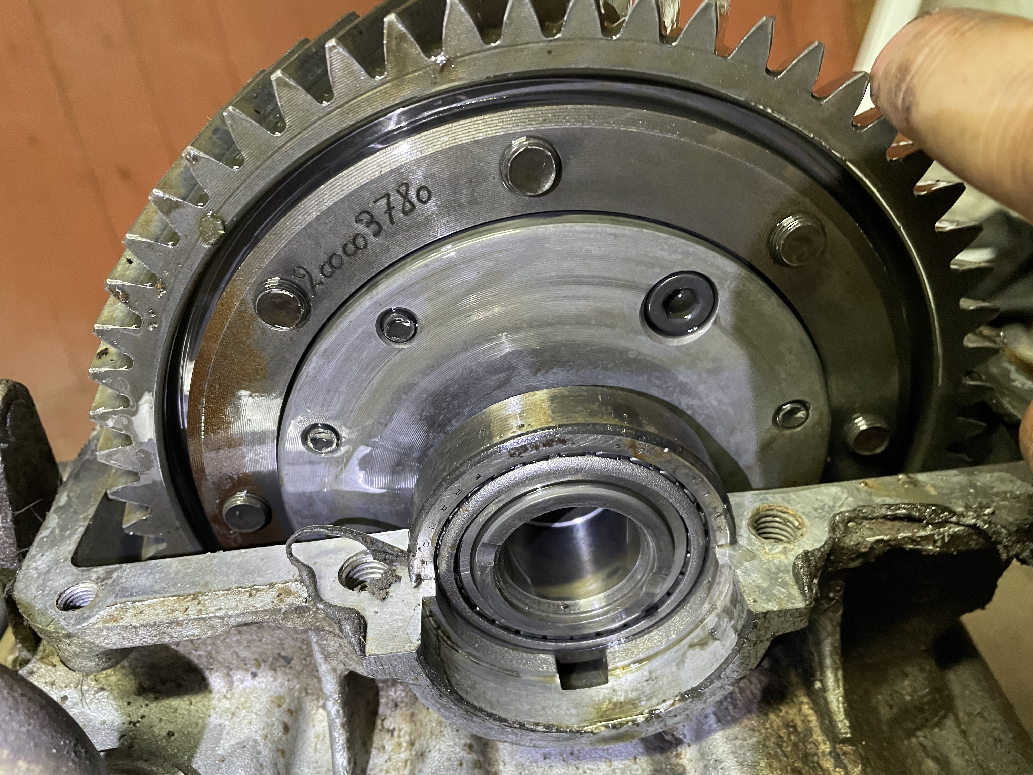

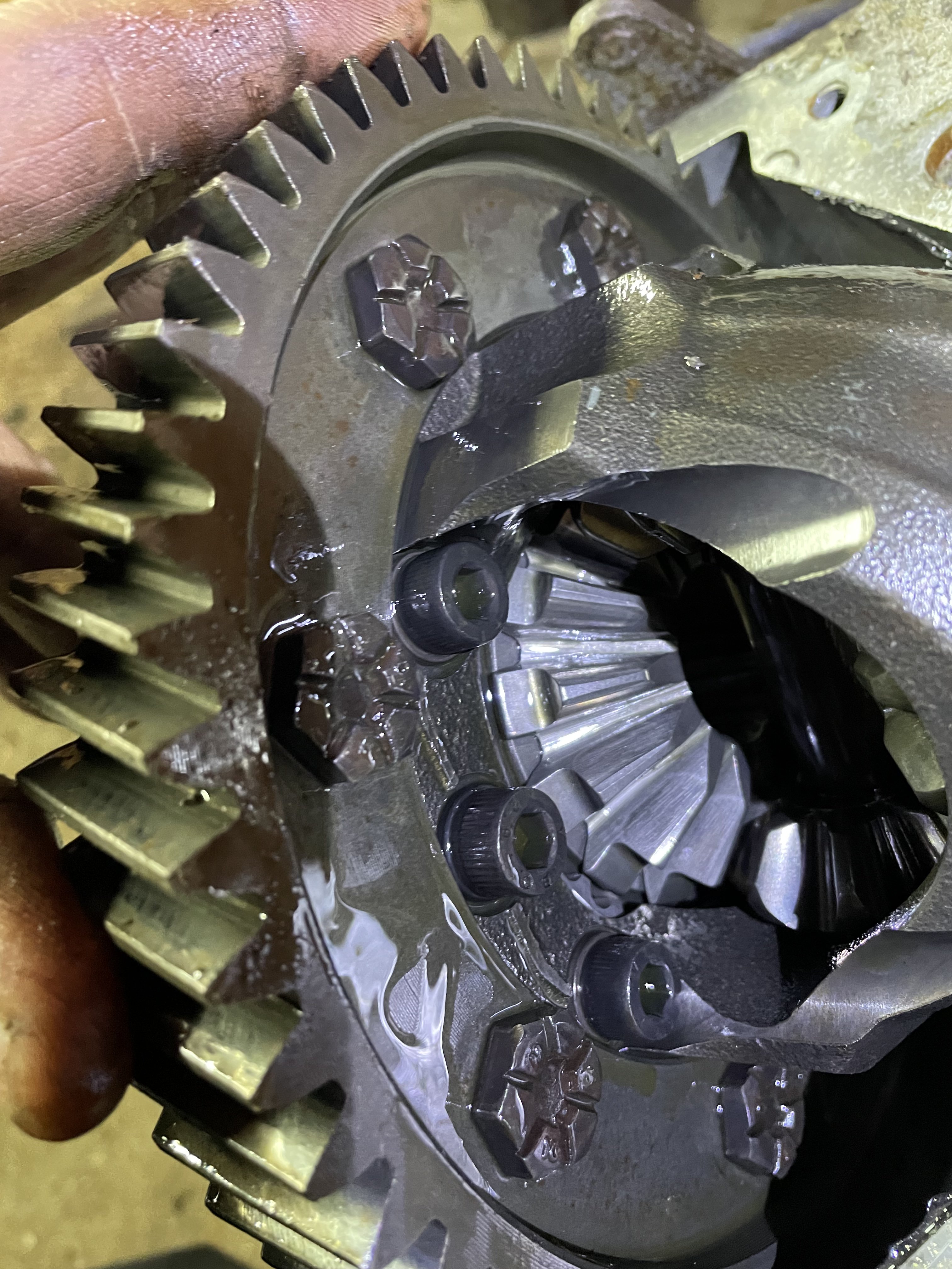

Hi so my spare box from my 205 I decided to open it up and see what was in it and have come across 16x59 on the large gear on the diff which will be its final drive but also it doesn’t look a standard diff as when you turn 1 shaft the other shaft turns the same way have added a couple pics to let everyone see and get some sort of idea. Thanks

Looks like a FAM limited slip diff, probably lifted from a Partner Ushuaia.
It's not as good as a true race diff because it's simply intended to help traction in mud or snow but it's cheaper to produce.
Dangel also made one with a cone instead of discs:

Ah right yes because I know what ever way it’s set up just now it’s locked pretty tight as the grip it has is great but it’s not very kind on drive shafts
