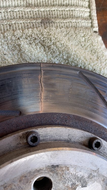

woodymi16 24 2 Cars Posted September 23, 2021 So at the end of a full on track day at Oulton Park Monday the pug started juddering under braking which I ignored as it went away after a couple of applications, probably not the brightest decision I’ve ever made now my question is, I have cooling ducts exiting on to the inside of the disc but none going on to the outside, is this difference in cooling causing the disc to crack as there are no signs of fatigue at all on the inside. To keep some perspective, the discs are three years old, so I’ve had good use out of them but just asking for constructive opinion based on other people’s experience. The discs are 283mm with CL pads and AP four pot callipers. The car has a high boost Rotrex conversion. Share this post Link to post Share on other sites
welshpug 1,619 Posted September 23, 2021 the vanes are on the inside, so it would be pointless directing air at the outside if it were possible. do you have a tube and a duct on the wishbone itself or just a hole in the valence? Share this post Link to post Share on other sites
