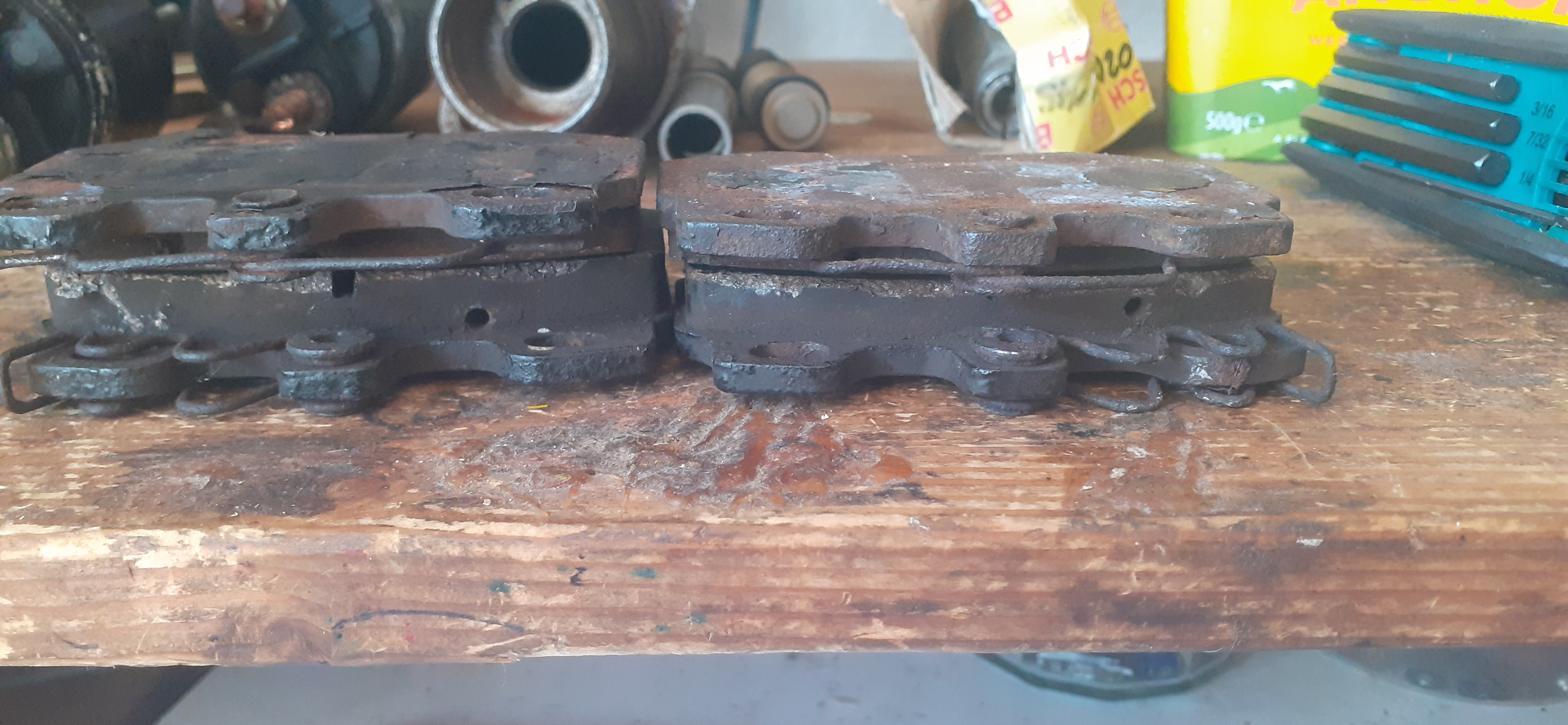

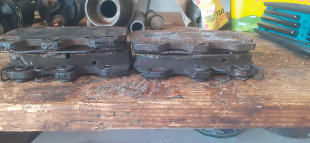

I found some of my old brake pads. I attach pics. I have the girling type calipers.
Looking at them again I now noticed that I have also got uneven wear on these old ones.
So on these I think the "outside*" pads on each side are more worn than the inside.
I think this is the same as what you are saying is happening with DBA bendix calipers?
I am not sure now which is nearside and offside - and in the posting - I'll just check that again in a minute.
*so for me Im saying the inside pads are next to the caliper pots. The outside pads are the ones nearest the wheel.
I know that on these pads the anti knock spring - I think it's called - is on the inside on both sides
ie next to the brake caliper piston(pot)
The see saw type spring is on the outside on both sides - ie next to the caliper "g clamp" body
I did a video on the brake calipers working a few weeks ago as I just was interested, and looking again I noticed that the inside pad is doing 95% of the movement.The pads are sliding along two pins on these girling ones.
The sliding part of the caliper doesn't seem to be moving. That I mean which is connected to the strut - there
are two seem to be movement covers for the whole thing to move back and forward relative to the strut.
Just interested to know if anyone else is having the same wear patterns? Is this normal and is this how these all work? I'm not a pro. mechanic so I don't see these coming and going day in day out.
Could be this is normal wear and this is how they work generally on all calipers?
