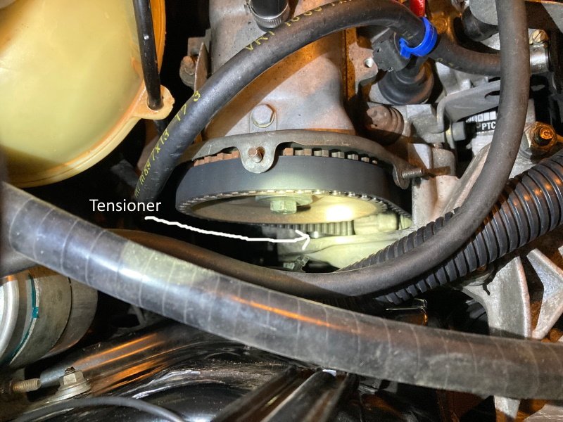

Hi all, still struggling with this. Only runs well after a run on the motorway. I paid 65 euro to get my datacard from l'adventure Peugeot and found I have the original motor (yay, but doesn't help) , but I am still trying to figure out which timing belt tensioner I have as it dictates the number of teeth on the belt. I have removed the top cover, but I still can't tell if I have the eccentric or non-eccentric tensioner. You barely see it from above like in the photo. How much else do I have to remove to be able to see this damn thing ?
Thanks

metal top cover means it should have the pre 15/01/1992 sprung sliding tensioner, post 15/01/1992 has a plastic top cover and eccentric tensioner.
if this has been changed why are you asking?

Thanks, WP. They guy I took it to to change the water pump and timing belt said he had a hard time getting it to run right. The timing belt kit (German) came with the belt, the pump and the tensioner. He didn't replace the tensioner. He couldn't say why he didn't (it is what I have to deal with because no one here will touch Peugeot). So I took it to another shop (old Volvo's) and asked them to do the shimmed drill bit line up of the cam timing and they found it to be off. I called the original guy and he said it wouldn't run right in that 'correct' alignment, Currently it idles perfectly, but stutters on acceleration. Subsequent to a 'hot' run on the motorway, it seem to run fine and accelerate fine.  Without expertise to reconcile what is happening, I am basically screwed. So I thought I would start from the basics. Since my datacard says 5/1989 as manufacture date and the fact the timing belt cover is metal, then I must have the slider tensioner and therefore the correct timing belt. Since the mechanic that will touch the car said it wouldn't run correctly in the 'aligned' mode, if I ask the Volvo shop to align it, I am not sure I will be doing anything but pissing money away. At this point, I guess I can live with only driving it subsequent to a hot run on the motorway, but it would be nice to use to pop out for dinner or something, but I need to get over that I guess and consider it runs well at all without my limited abilities to diagnose.
I imagine he put changing the tensioner into the "too difficult" bracket. Its not actually that hard but is a bit fiddly I suppose especially if you aren't familiar.
The reason it won't run if you correct the cam timing, is because the distributor is driven off the other end of the cam, so moving the cam timing to be correct moves the ignition timing to be wrong, and clearly wrong enough it won't run. The original guy clearly is pretty clueless if he could not figure that out.
