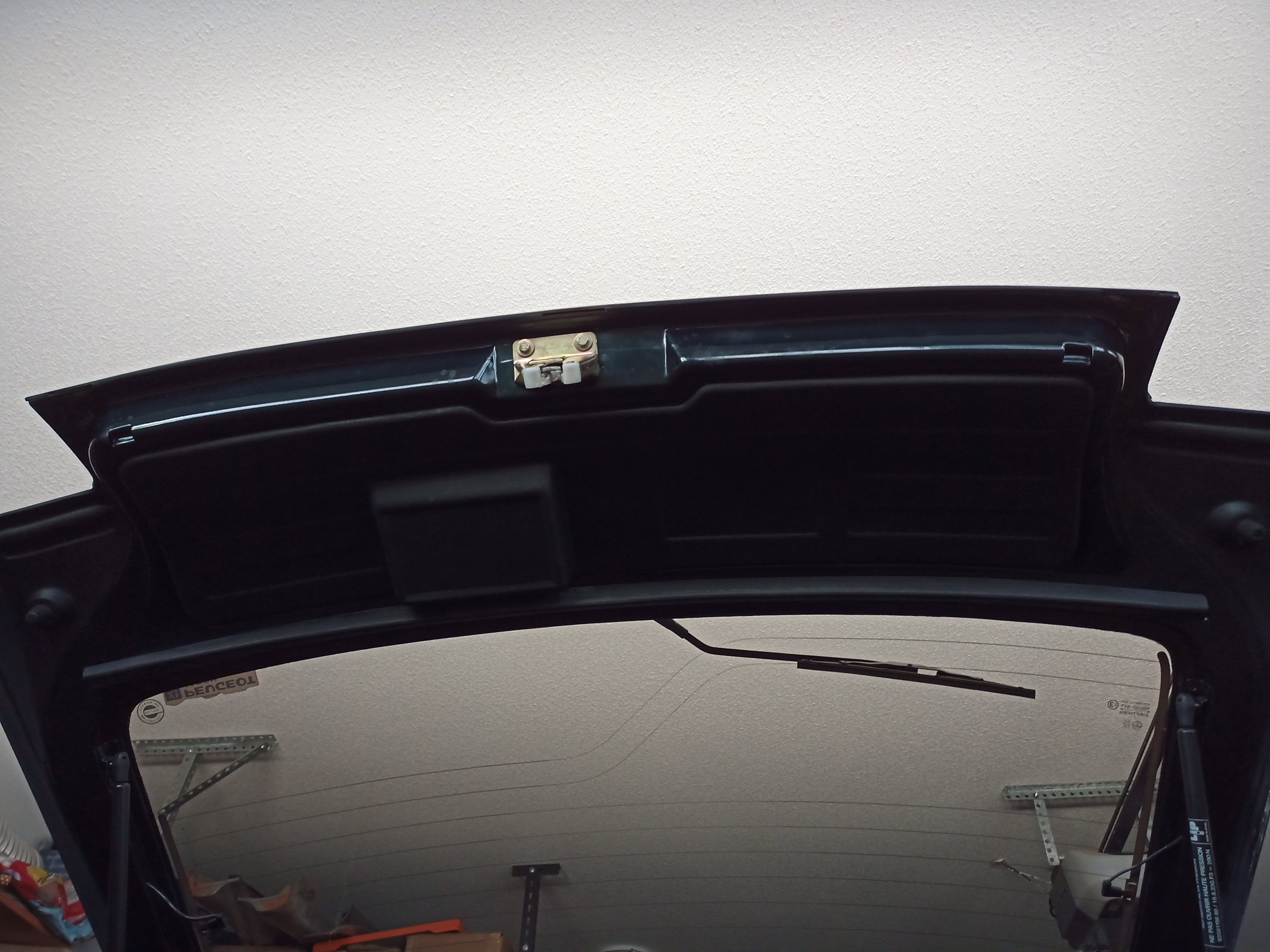

1.9 1993 gti. I tried looking everywhere also using search on this forum, and cannot figure out how to remove the plastic cover over the rear wiper motor. I can see some white clips in the corners and I do not want to pry further and break some unobtainium stuff.
My rear wiper motor is very noisy and I wanted to open all up and clean/grease the arms and all. See photo of the cover.
Let me know the way you have taken the cover off, please.
AlexRS2782

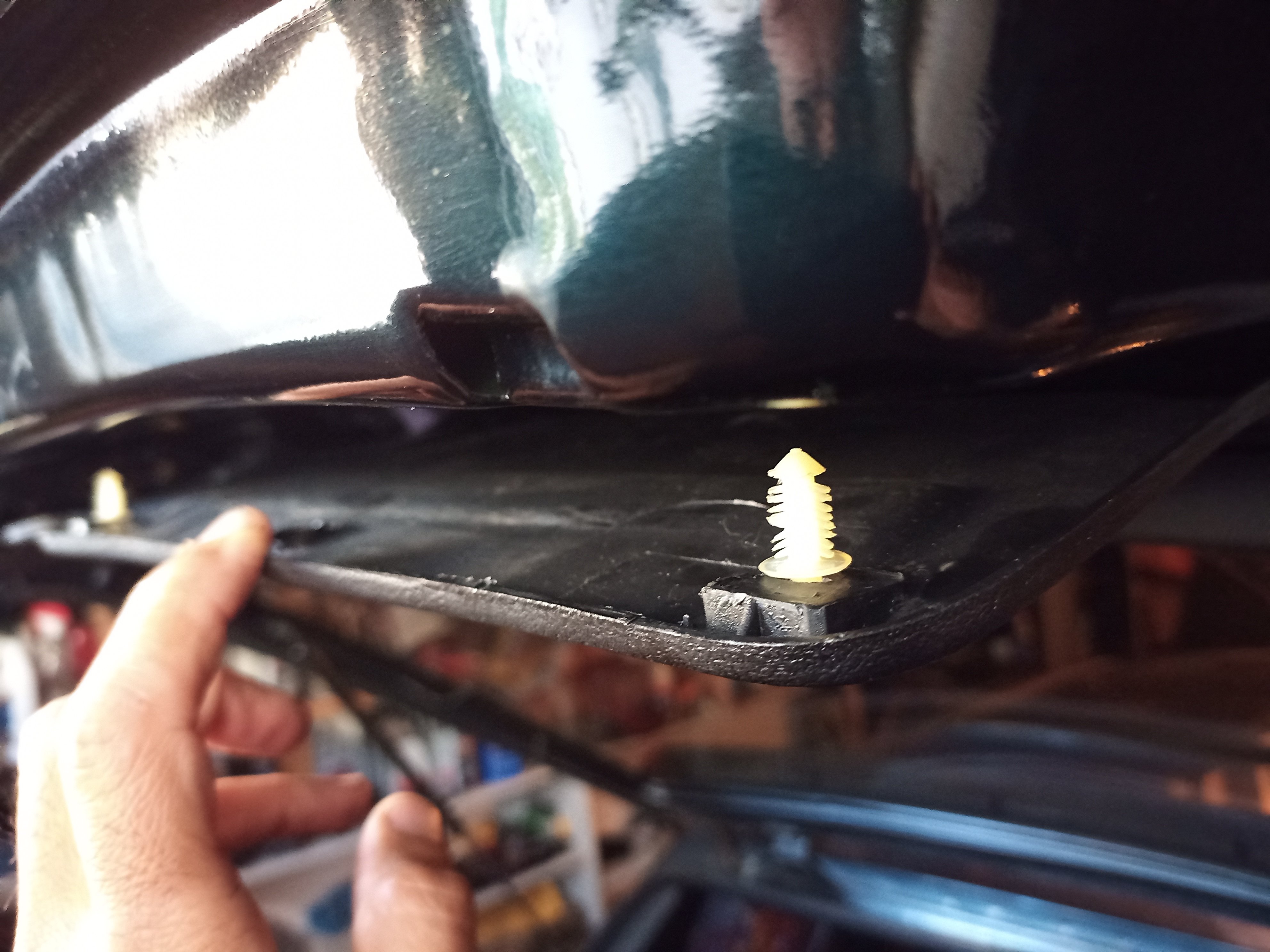

Last year when i removed mine i just eased it off all round by using a panel removal tool and then carefully pulled it down towards me.  Do it carefully and the mounting brackets in the panel itself shouldn't break.
A couple of the white clips might crack / split due to age when removing, but they can be replaced as they're just plastic retaining plugs.

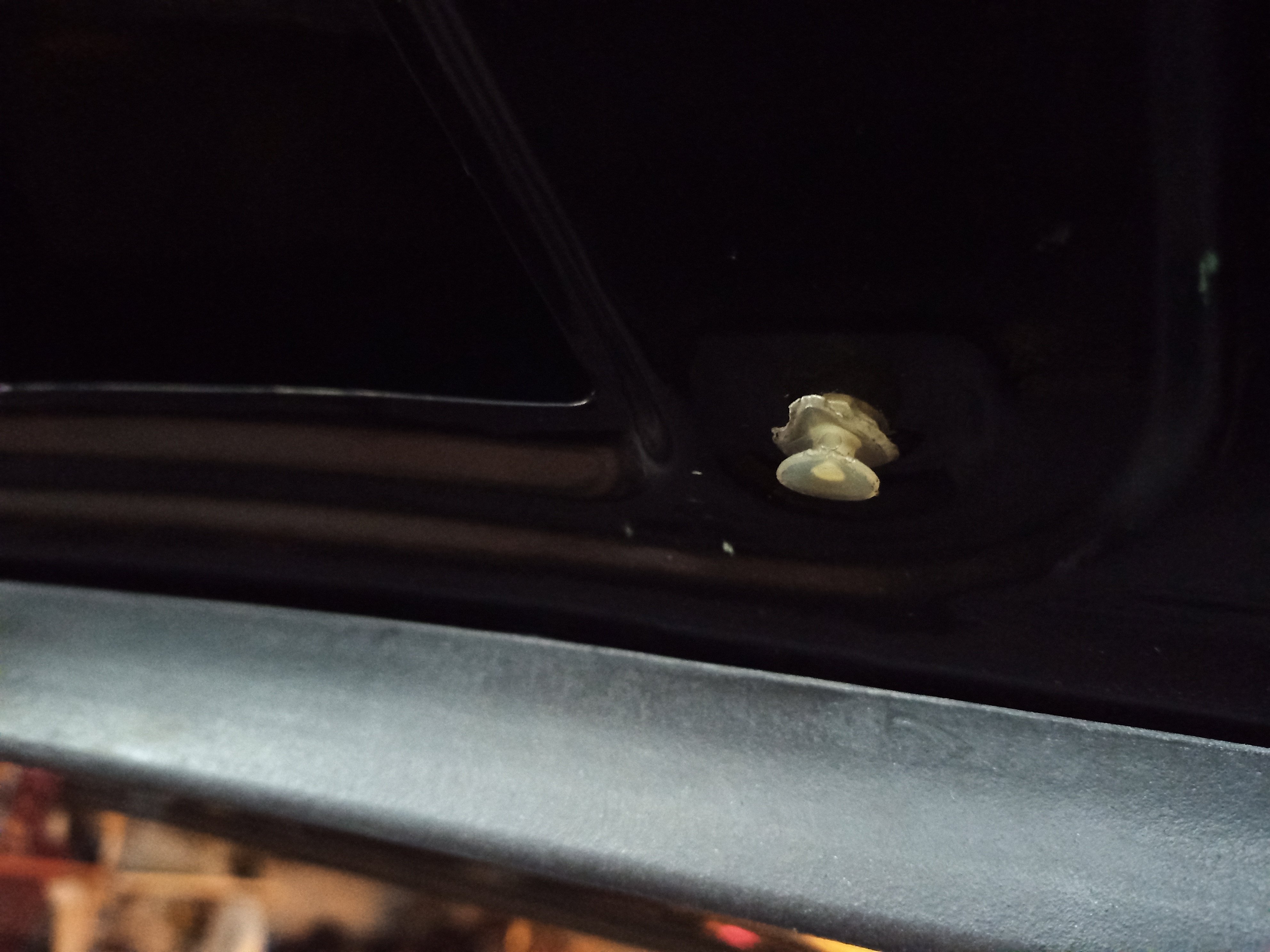

Dimi
Two photos for reference of the clips holding the rear wiper motor cover to the tailgate. I did not brake anything, but the pulling was scary. Now to figure out why that motor/drive grinds so badly and looks like new...
