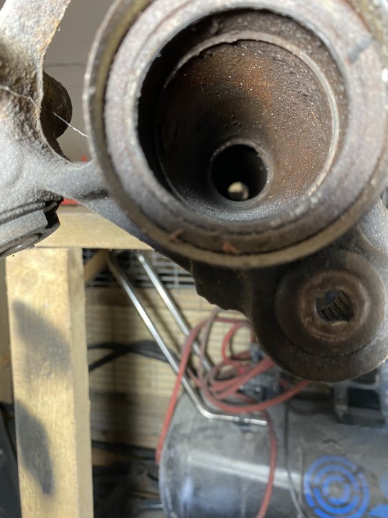

8ballautos 0 Posted May 5, 2021 can anyone recommend someone who can press the 4 bearings in centre tube and the trailing arms. Struggling to find anyone that will help! Cheers Share this post Link to post Share on other sites
Tom Fenton 1,524 Posted May 6, 2021 I can do it for you but I'm in Yorkshire. The beam tube is a bit more involved as you need some press tools which I have. The trailing arms are easy though, and anyone with a normal workshop press should be able to do it for you. Share this post Link to post Share on other sites
welshpug 1,621 Posted May 6, 2021 as you're in Dorset you won't be far from Stefan Golesworthy. Share this post Link to post Share on other sites
8ballautos 0 Posted May 6, 2021 Cheers guys. The tube bearings are now out so I will tidy up the tube and get the new bearings in, the only job now is trailing arm shafts .... can they be beaten out ? Share this post Link to post Share on other sites
