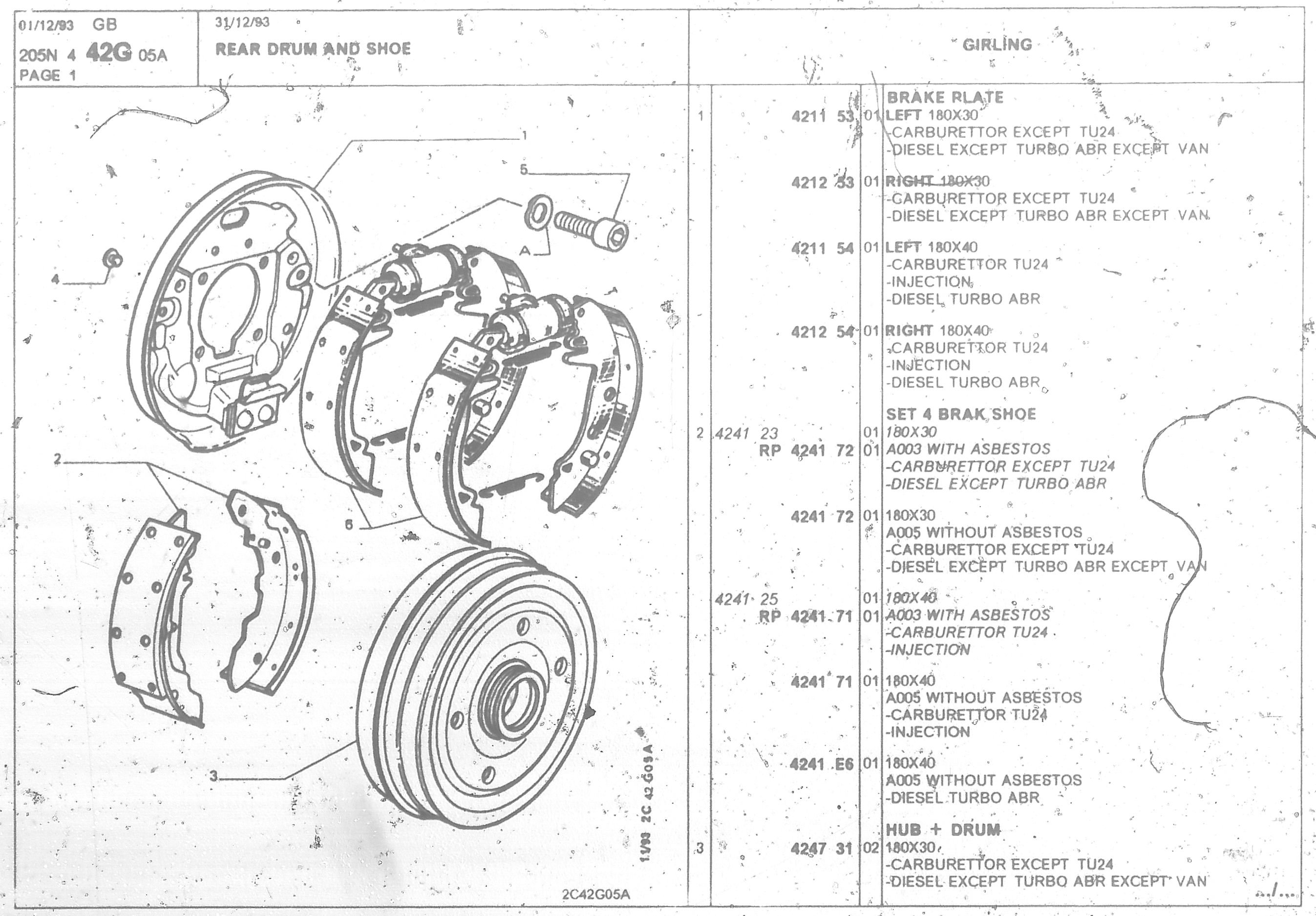

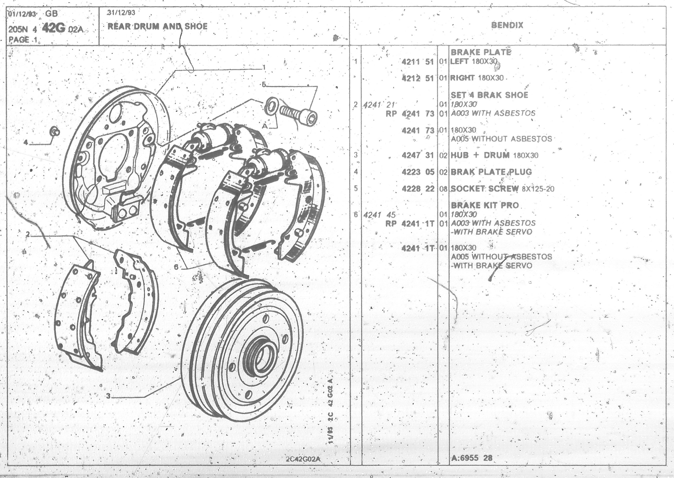

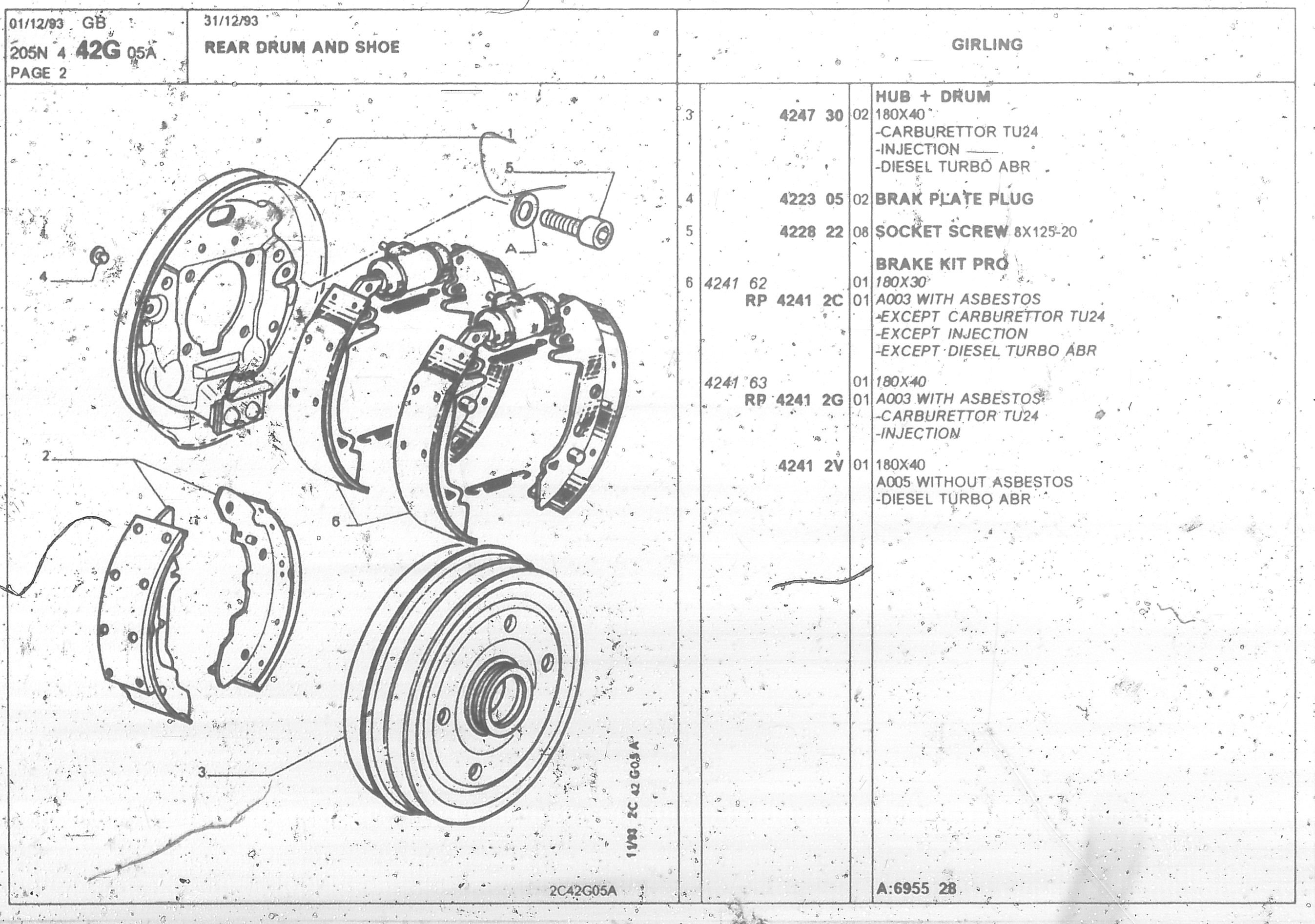

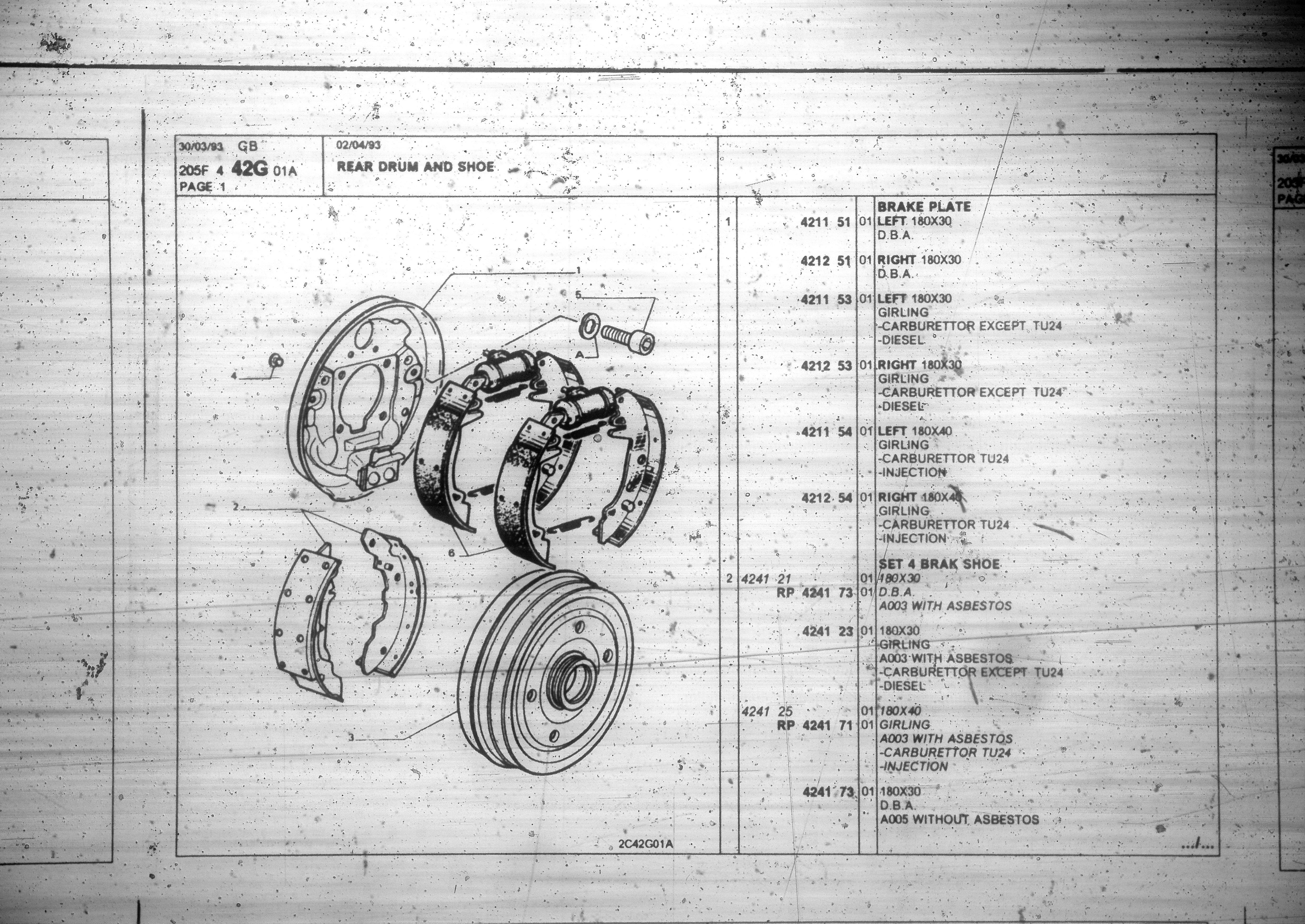

Gohn 62 Posted March 7, 2021 at the risk of just confusing the issue i've attached the part catalog pages but you seem to know what you're after (think maybe the rallye gets the TU24 spec drums) Share this post Link to post Share on other sites
DamirGTI 322 Posted March 7, 2021 Proper euro TU24 Rallye has 1.6 GTi suspension .. front and rear . D Share this post Link to post Share on other sites
