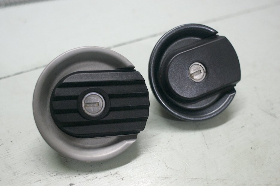

Has any bod removed one of these fuel cap trims ?
I'd like to remove the flat GTi version and put on the sawtooth standard one but I've never done it before and don't wanna break anything

they are a direct swap, the cap with the flat GTi trim used to have the sawtooth trim on it originally

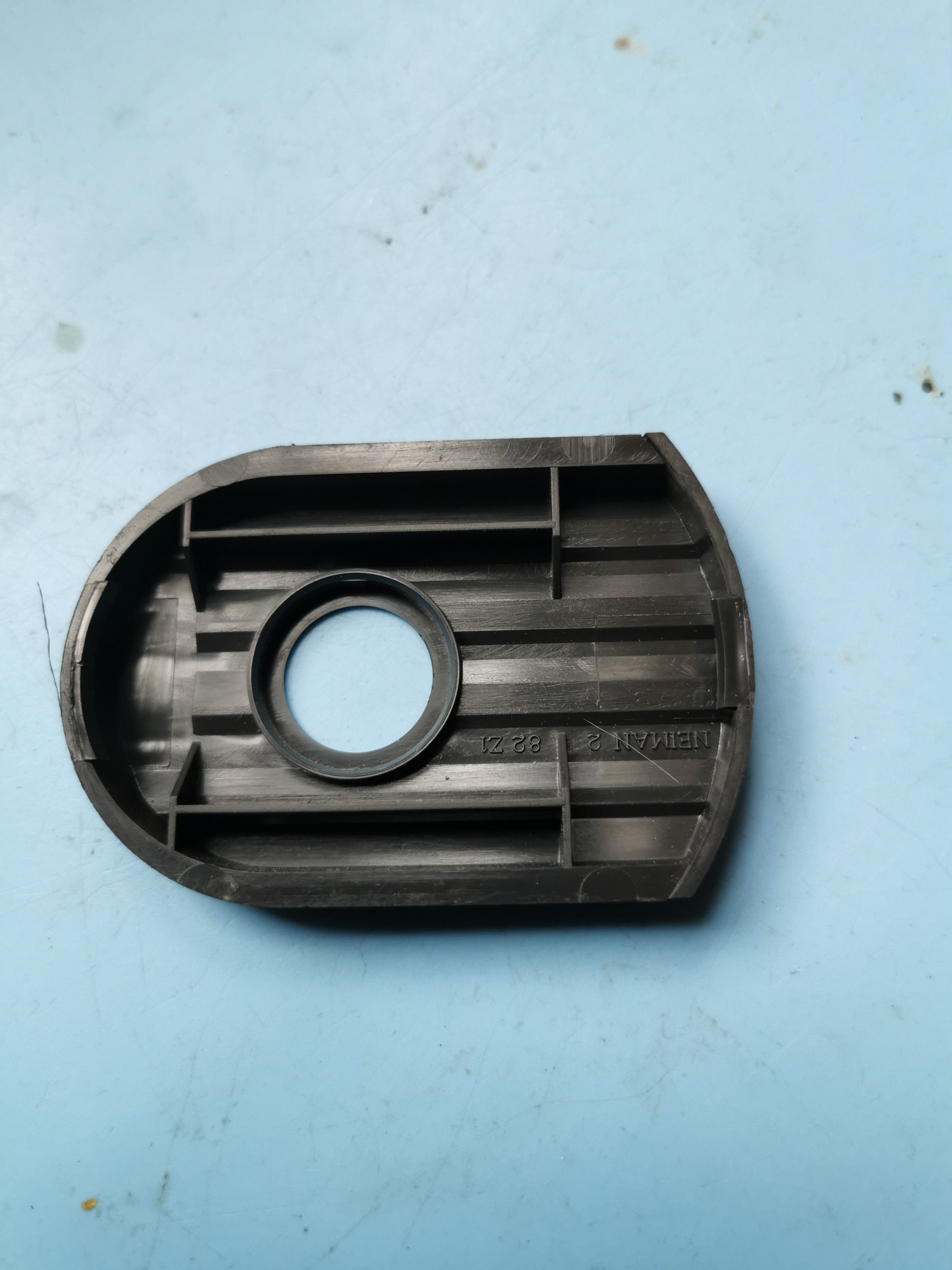

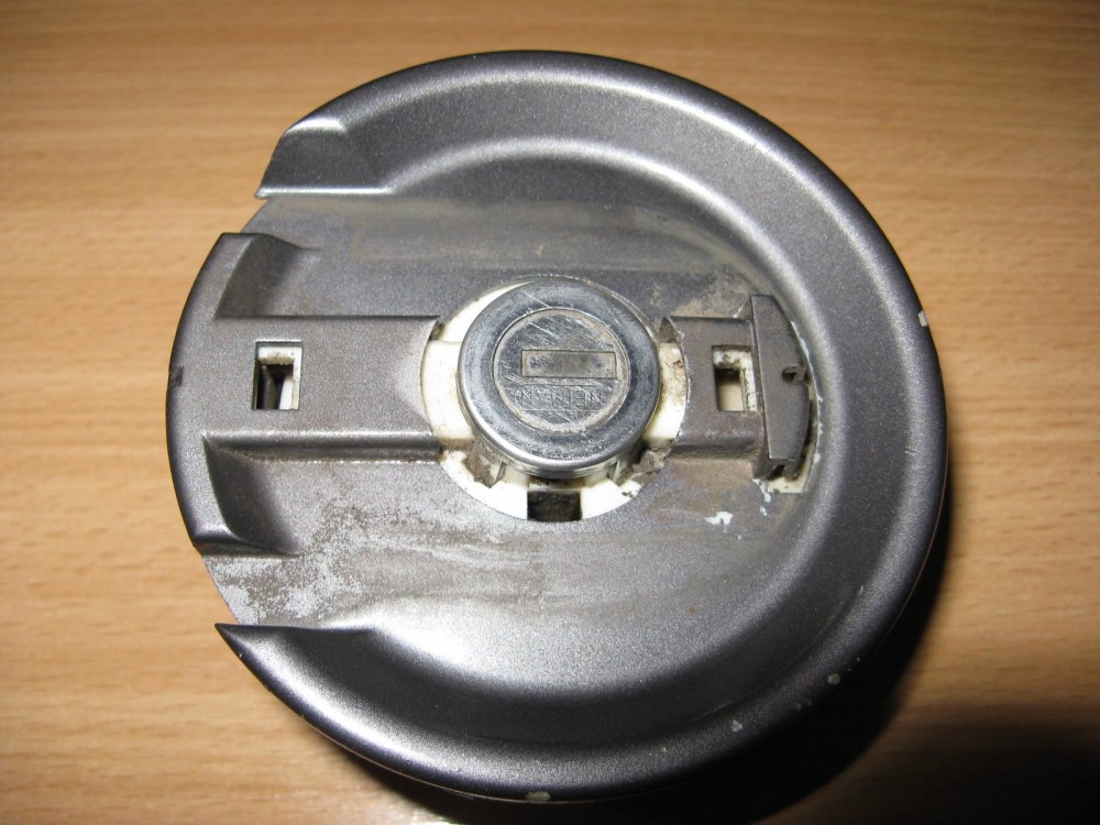

I might have a few of those with the trim removed , will see if i can find one for photo sample .

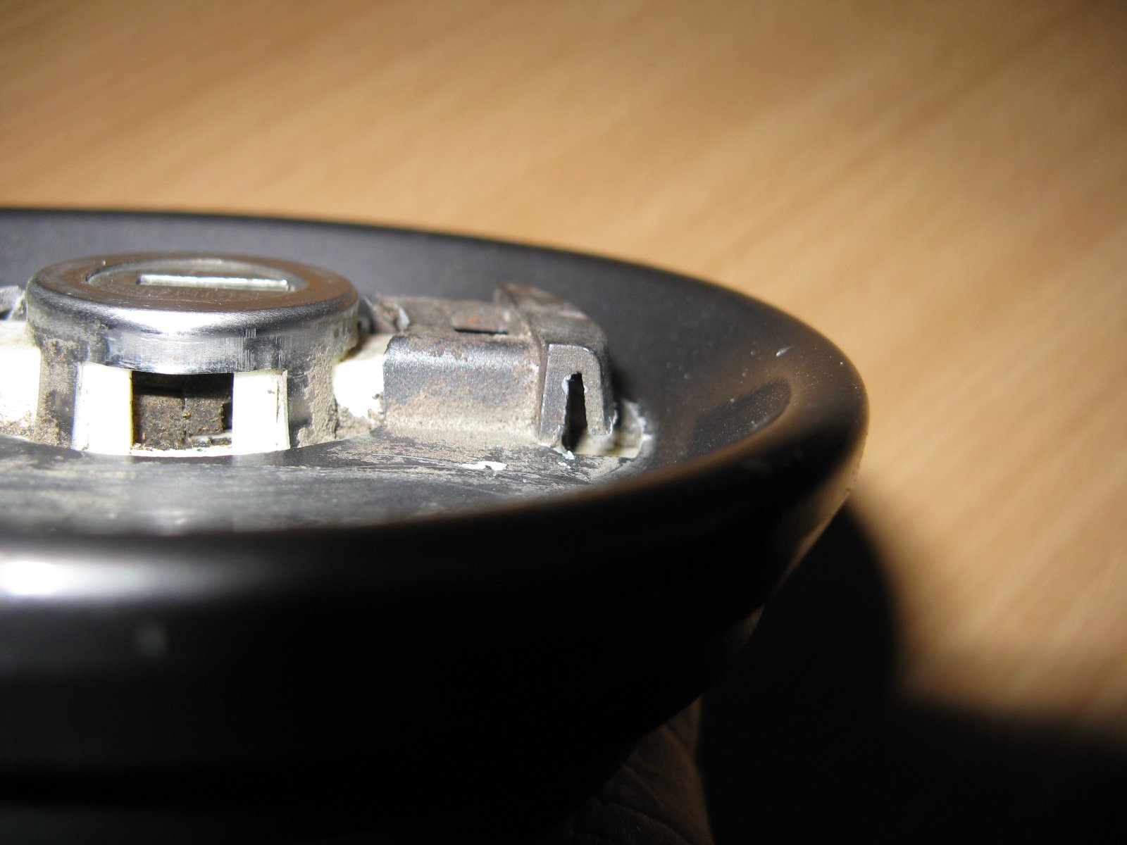

DamirGTI

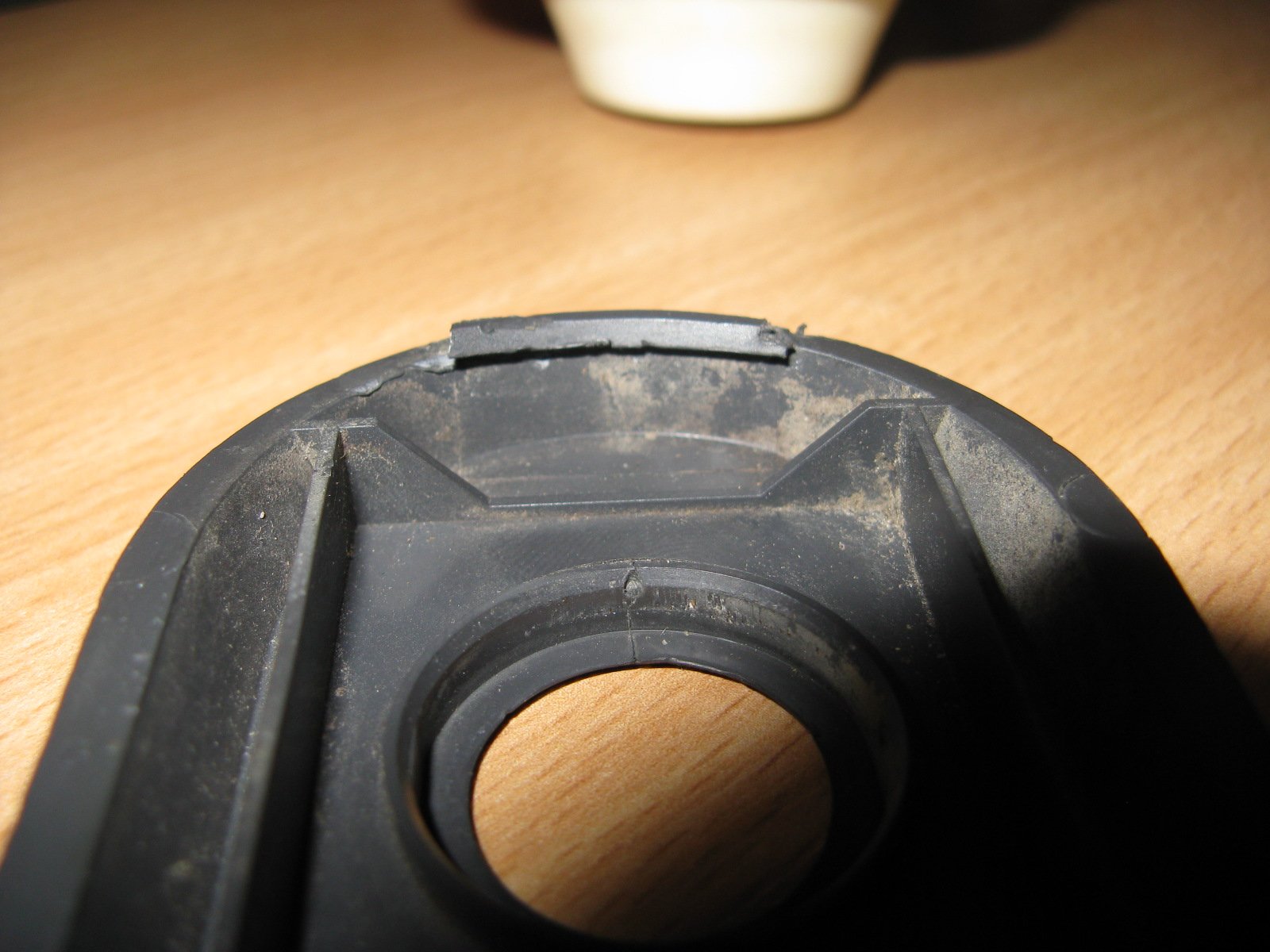

Start from the back , unclip and lift up , then push forward and with an small screwdriver work around the front side locking tab and it'll release .

I've had success, of sorts
encouraged into having another go ..

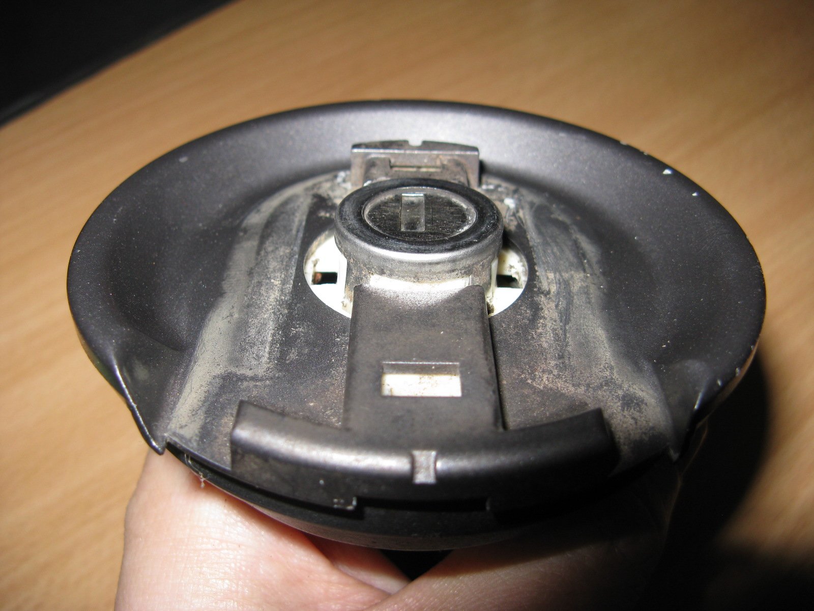

the caps both came off really well
pushed the little front underside tab (pictured) out and then back
once it clears the rim it was easy to just push the trim toward the back of the cap until the rear tab was unhooked

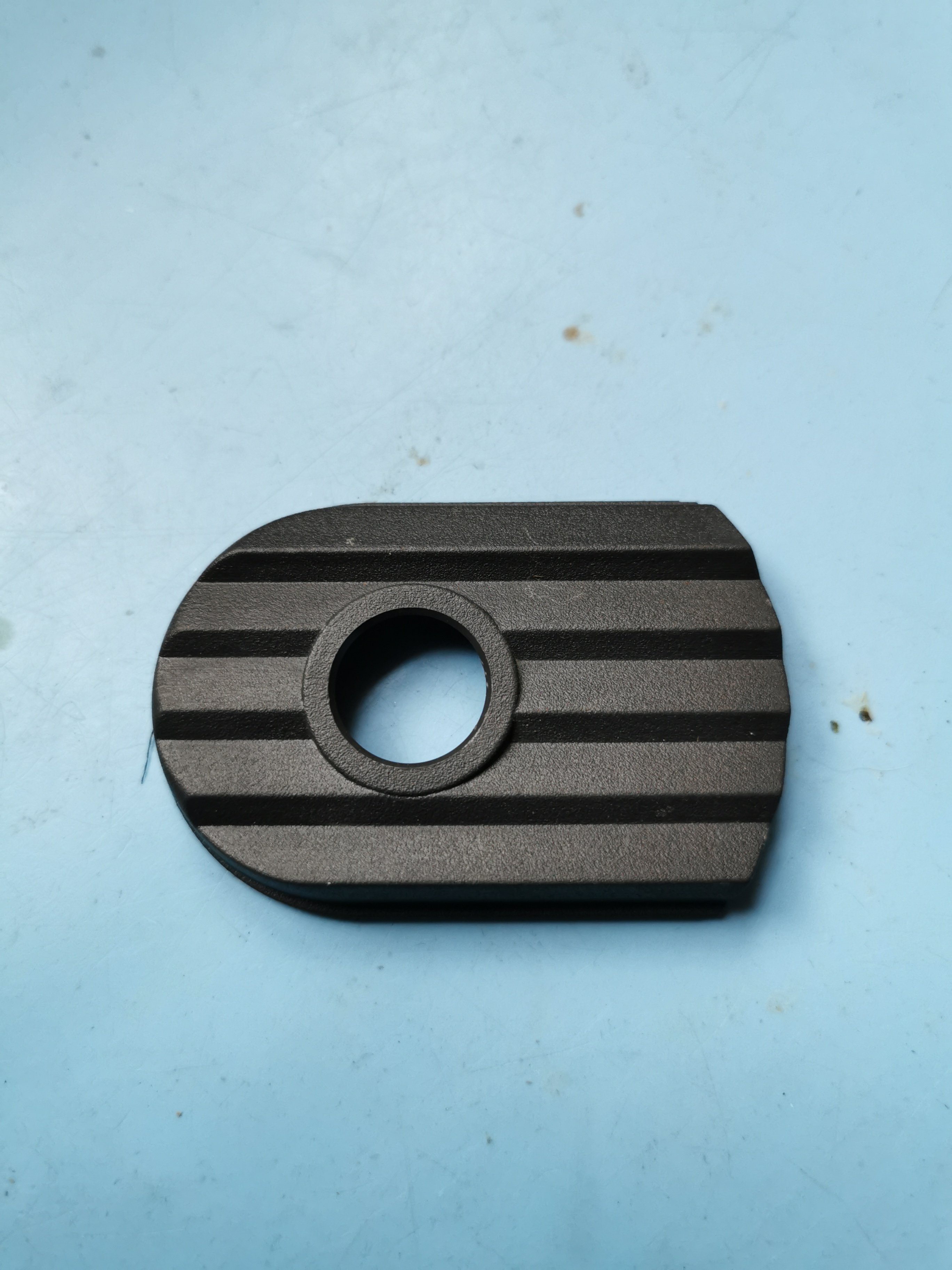

jj007205

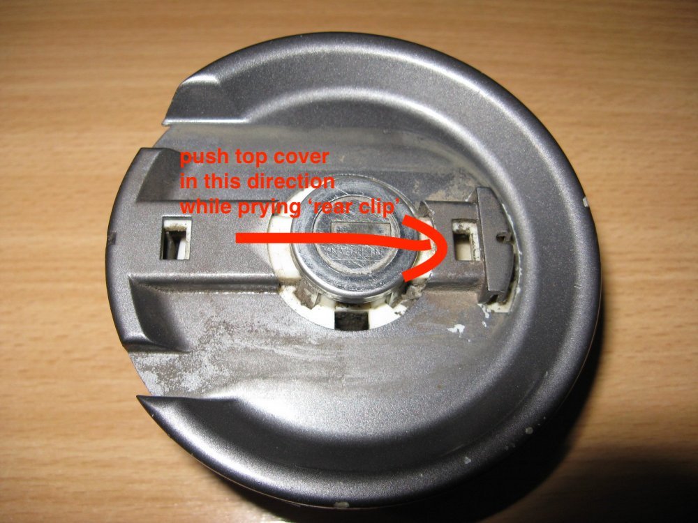

Key is to get it warm and as above, start with the rear outside clip of grey cover while pushing slightly inwards. Once you slide/remove that, the painted part can be unclipped. A set of picks and/or tiny screwdriver helps.
jj007205
From @DamirGTI pics above. This is what works for me.
