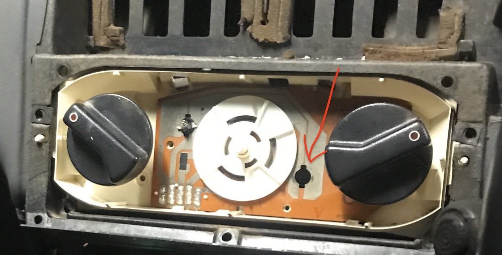

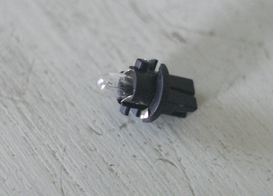

jj007205 0 Posted February 17, 2021 (edited) Thanks for that. Pardon me for being daft. Trying to replace this light (Arrow) hence appear to need to remove the 'backing plate' to fix 'missing light' holder? Or perhaps the globe fits in with holder? Looks like it does? Will swap and verify with other when I can get to it. Edited February 17, 2021 by jj007205 typo Share this post Link to post Share on other sites

DamirGTI 345 Posted February 17, 2021 (edited) I blame technology ! these days , just one wrong connected cable or an active short is enough to trigger you're entire PC database into - now you see me now you don't . Problematic that is , if you don't have practice making other means of your data storage/copy other than simple pile up on the HD . Photography was my family job for years/decades , until the digital came along Back on the subject ... a bit unfortunate find . Yes , the bulb holder will need to be installed at the back of the backing plate .. for which you'll need some contortionist skills . It is doable without dismantling the other parts of the dash , but very fiddly .. you can push the upper part of the backing plate inside till the two small white pointy tabs on the sides clears the outer black dash housing , and then carefully push+rotate the backing plate inside the dash so that you have it at an angle and you'll be just about able to slide the bulb holder at the back and lock it on the base plate ... Thin arms or good needle nose pliers will make it easier . Also , when you tilt it at an angle see if its more convenient/easier to insert the bulb holder from underneath trough holes in the dash central part for the switches . What ever you do , be very careful , as this "operation" is likely to end up with some dash plastic cracks as a result . Don't tilt the backing plate at an too much angle , as there's locking mounts for the heating control cables at the back of the backing plate as well as the plastic cog wheels . D Edited February 17, 2021 by DamirGTI Share this post Link to post Share on other sites
DamirGTI 345 Posted February 17, 2021 If it turns out to be too complicated or you end up frustrated to the point of breaking surrounding plastic parts in order to reach the back side , simply solder the bulb directly onto the heater control board without the bulb holder .. and apply some hot glue afterwards so that the vibrations cannot loosen it off . I've done them interior/dash bulbs like so on some other cars makes/models and - all good , no problems . (mainly because some are "fancy by design" with special bulbs and bulb holders , often than not prohibitively expensive supplied trough dealer network only) D Share this post Link to post Share on other sites
