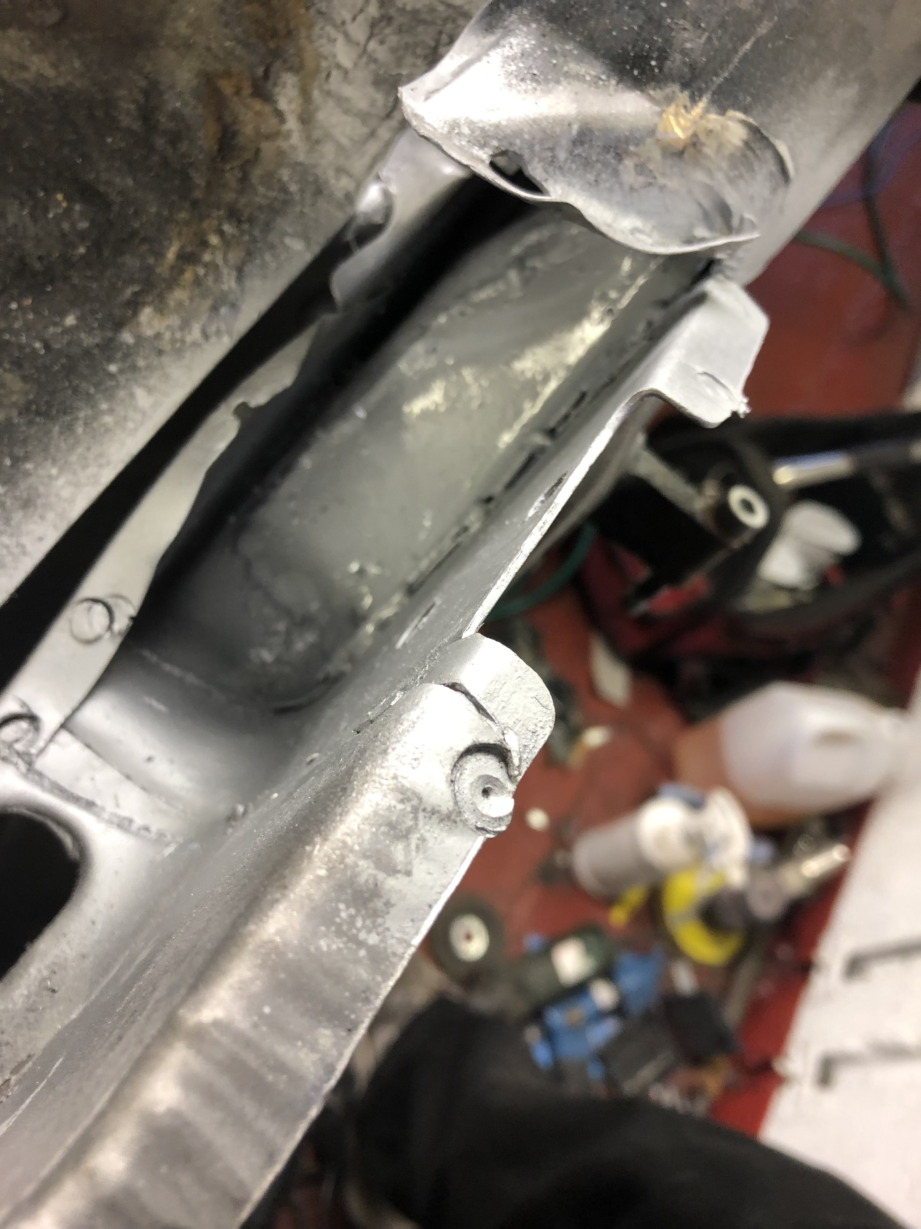

Check the seam sealer on the strut top mount in the engine bay as this is the bulkhead seam. Open the bonnet and put a hose on the top mount then check for leaks. they can also have holes in the box section by the bonnet hinge. I have loads of photos showing bulkhead repairs in this area.

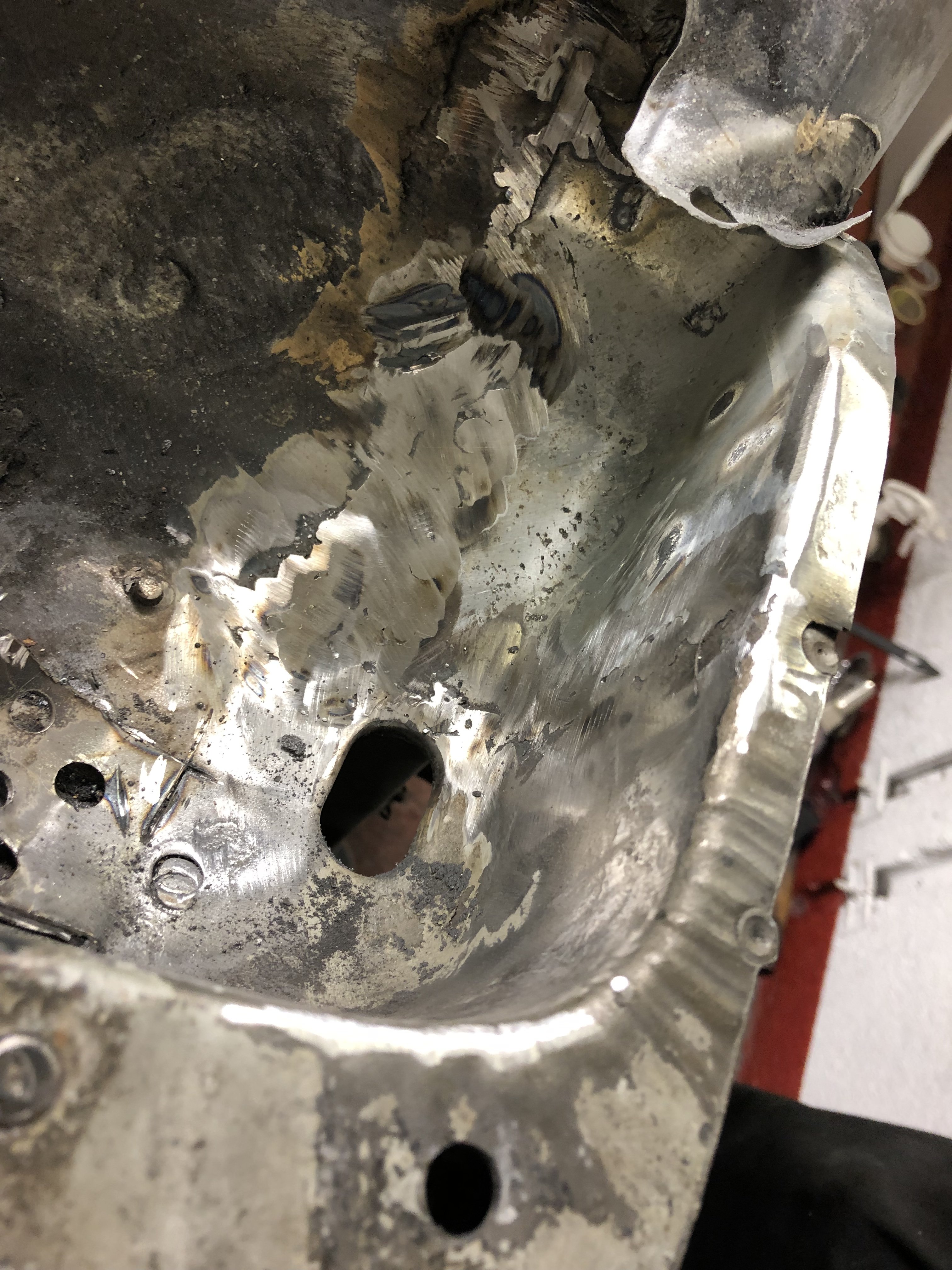

+1 for leaking from the spot shown in the photos. Mine was like Swiss cheese in those areas. You can see pics on my restoration thread. Search Rust rust and more rust

Its worth noting that in the scuttle panel area on either side is a 'pad' of sealant.  I found that below this sealant the metal had developed tiny rust holes.   when the area got suitably wet it leaked here. The holes could not been seen until all the sealant had been removed.

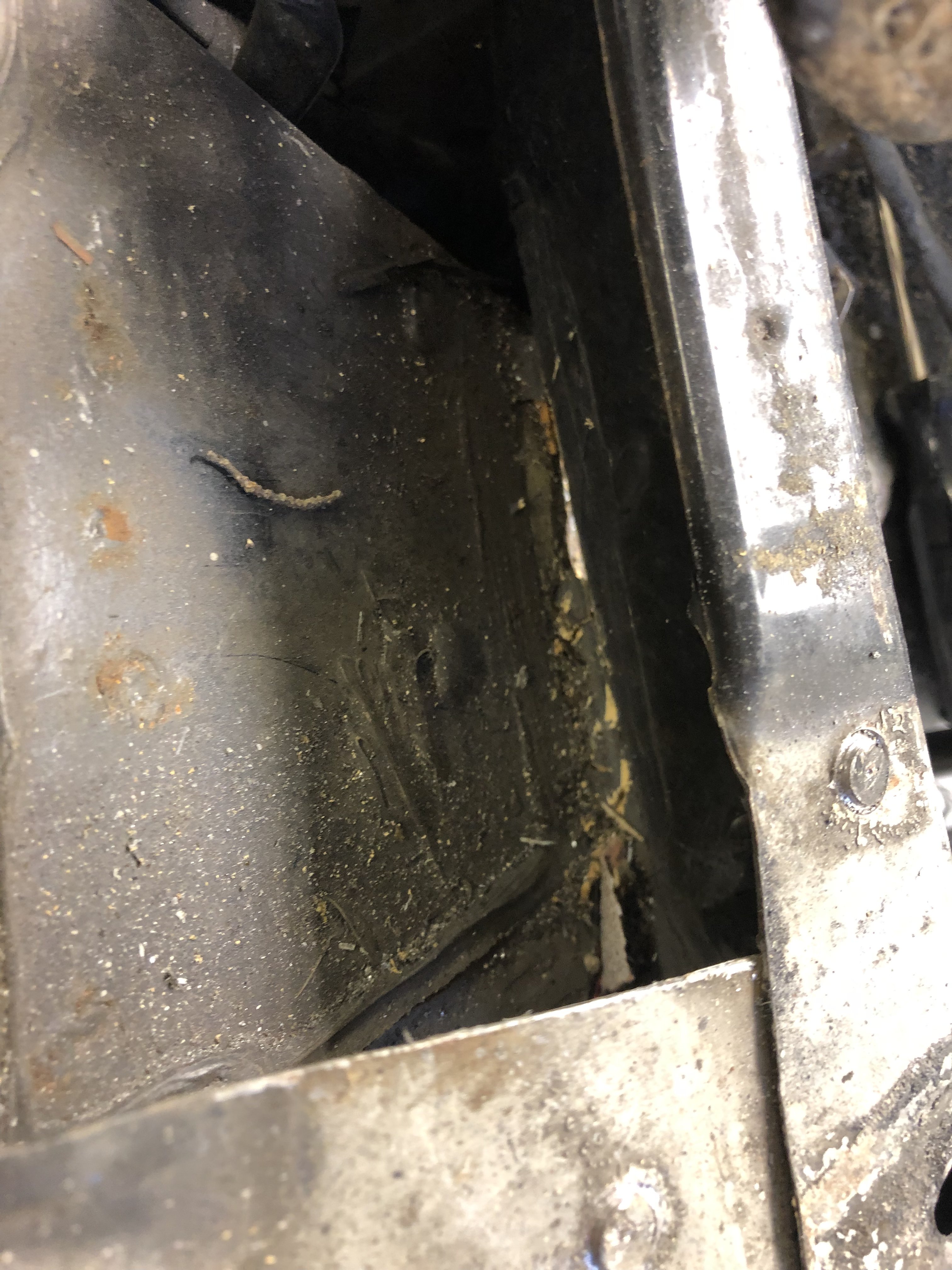

Well, been to it last evening. The bracket piece thing under the wiper motor is at the same spot as the steering coulomb bracket underneath. So it's a sandwich in that area. The upper bracket is from pic 2 no more. What do you think; is is necessary to make a new bracket for structural integrity?
139823322_3681327971946302_7311899824097140031860_3681328161946283_7995197471437140385831_3681328018612964_7315081722081140036386_3681328098612956_7649604725114140202699_3681328131946286_5536786071054
Yes I would be putting it, or something to replace it, back.
