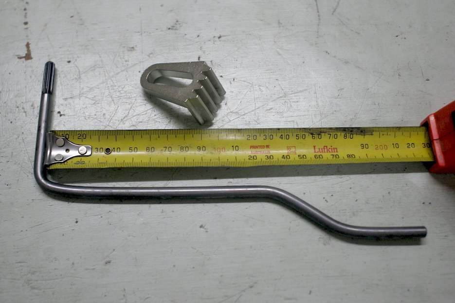

after I got that little flywheel lock, it motivated me to finally make up my own timing lock for the flywheel
this locks the flywheel thru the timing hole in the block, and if you've got the tool you dont have to take off the starter motor to get to it
one less job is a bonus
you can buy these too, same as the flywheel lock above, but this one is easy enough to make with almost no tools
like most things peugeot, its an odd size

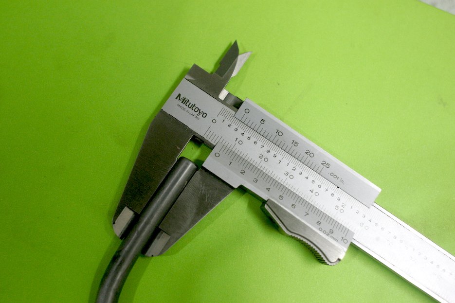

M7 outside diametre
most metal suppliers will only have 6mm or 8mm, and even if you can find it at some special metal place, they're gunna want $30 just for the blank
but your local metal scrapyard should have a few, (or if they're as popular there as here - bloody hundreds) of whipper snippers/line trimmers
look for the longer straight shaft ones and the japanese ones have the best steel
get one with a 7mm centre shaft that runs inside the outer aluminum pole
the centre shafts are made of high carbon steel and the first one I looked at was 7mm with a hollow core to save weight !
once I had the shaft, I hack sawed off a piece of about 300mm and was able to bend it to the shape by hand just with a small vice
no heat required - this would compromise the steel's strenght anyway
I made the tail a bit longer than what you'd buy (its still got the spline in it) which makes it easier to use
