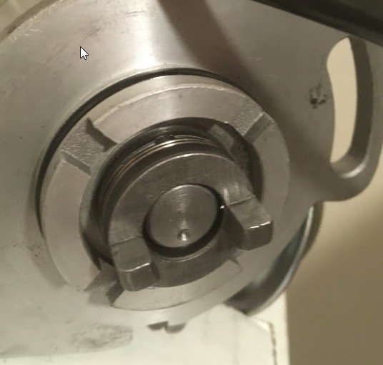

I bought an ultraspark distributor last week and went to install it today. It didn't work, but I think I know why and wondered if anyone could advise me. I noted the position of the rotor when I removed the old dist. When you place the dist in the engine, the gear below
only goes in one way. If you were to rotate the gear 180 degrees, it won't go in.
The problem is that the rotor copper end
on the old dist., when the gear is all the way in the engine, the copper end as above is at 2 o'clock, when I put the new one in (the only way it will go), the copper end is at 8 o'clock, exactly 180 degrees off.  It doesn't work of course. I put the old one back in and it works fine. Do you think it is possible for me via reassembly to be able to rotate the rotor 180 degrees with the gear remaining stationary or am I fooked ?

Swap the plug leads around to suit on the distributor cap, only takes a minute .
Or, remove the retainer ring, then drive out the retaining pin of the male drive dog, with the appropriate size punch, spin it 180 and reassemble.(voiding any warranty)
The conductive parts of the rotor arm are brass not copper.

Thanks, seems like a dumb question now and a lot of wasted labor.
Ozymandis
Not at all, over the years I have seen a lot of 4 stroke petrol engines with the ignition timed up 180 out with the plug leads re arranged to suit. I'm really old.
