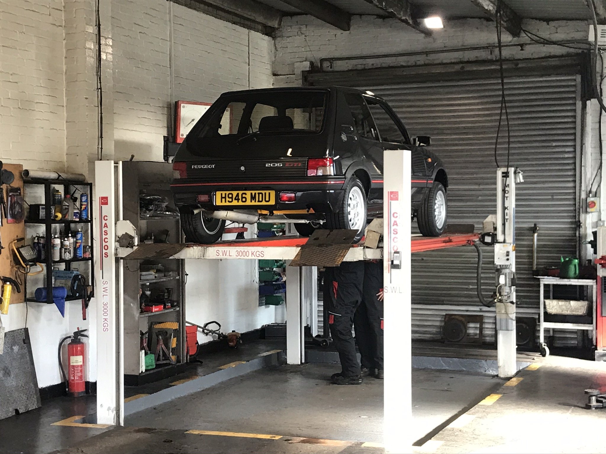

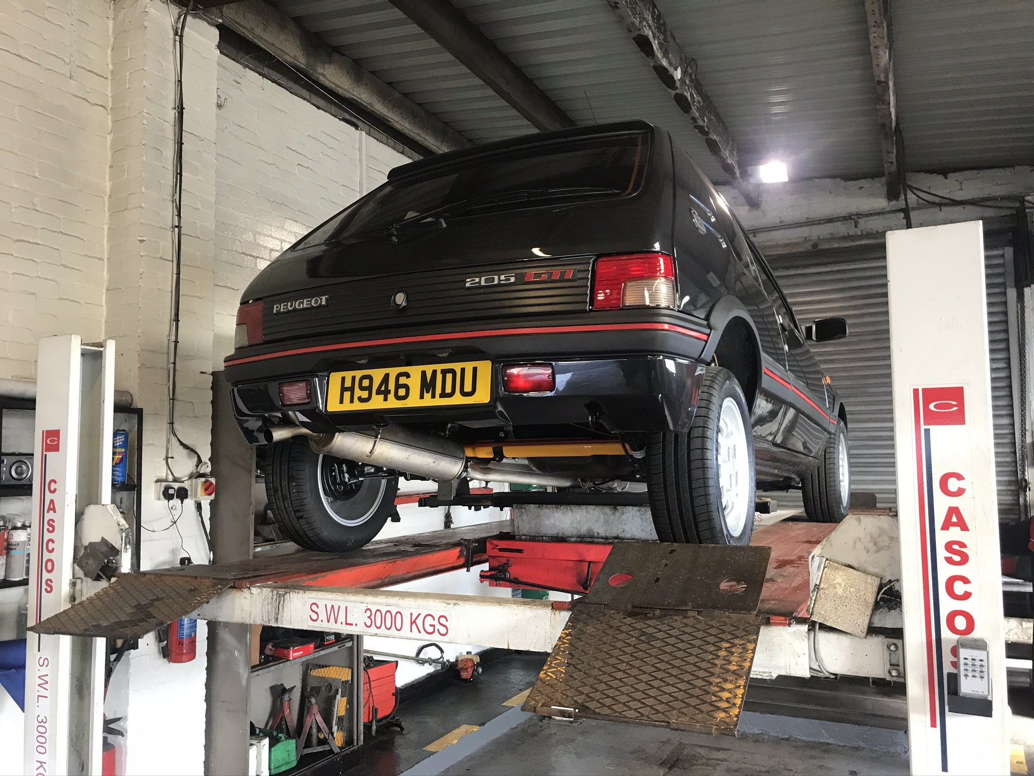

It was a good ending for me today though, car flew through the MOT, the guys at the test station loved the car and were very impressed with the build :D.

Probably just the camera angle- front arches look a little high? this was another problem i also had!
