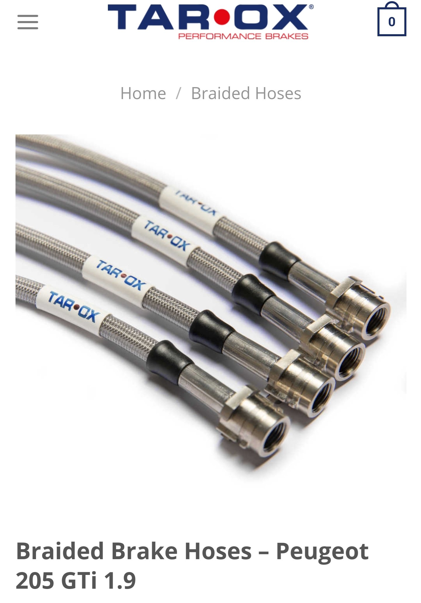

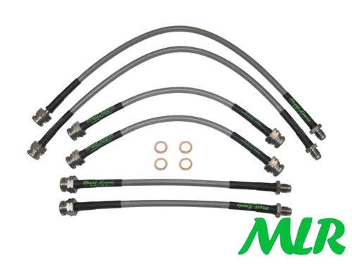

DSYKES5500 22 Posted July 20, 2020 Are they worth the upgrade? No track use, just road. If so which should I go for? These any good? Thanks! Share this post Link to post Share on other sites

Anthony 1,000 Posted July 20, 2020 4 hours ago, DSYKES5500 said: Are they worth the upgrade? No track use, just road. If so which should I go for? Personally, I'm not convinced of the benefits of braided hoses over standard rubber ones on a road car, but I guess it depends in part if you need to replace the brake hoses anyway because they're perished or whatever. If you do, it might be worth paying the extra for braided - I've no experience of the Tarox ones in particular though. Echoing what Tom said though - replacing brake hoses is one of those jobs that should be easy on paper, but often turns into a right pain. Share this post Link to post Share on other sites

Fallowsnz 2 Posted July 20, 2020 I fitted a set of these a year or so ago they've been all good, thankfully no problems at all. Reckon the brakes feel a bit better with them. I needed to replace the front ones and the rear beam needed doing so thought i'd just do the whole set. Never realised they could cause failures in the weakest part of the system but makes total sense to me. Was thinking of getting a set for my xs but maybe best to just leave them alone.. Share this post Link to post Share on other sites
