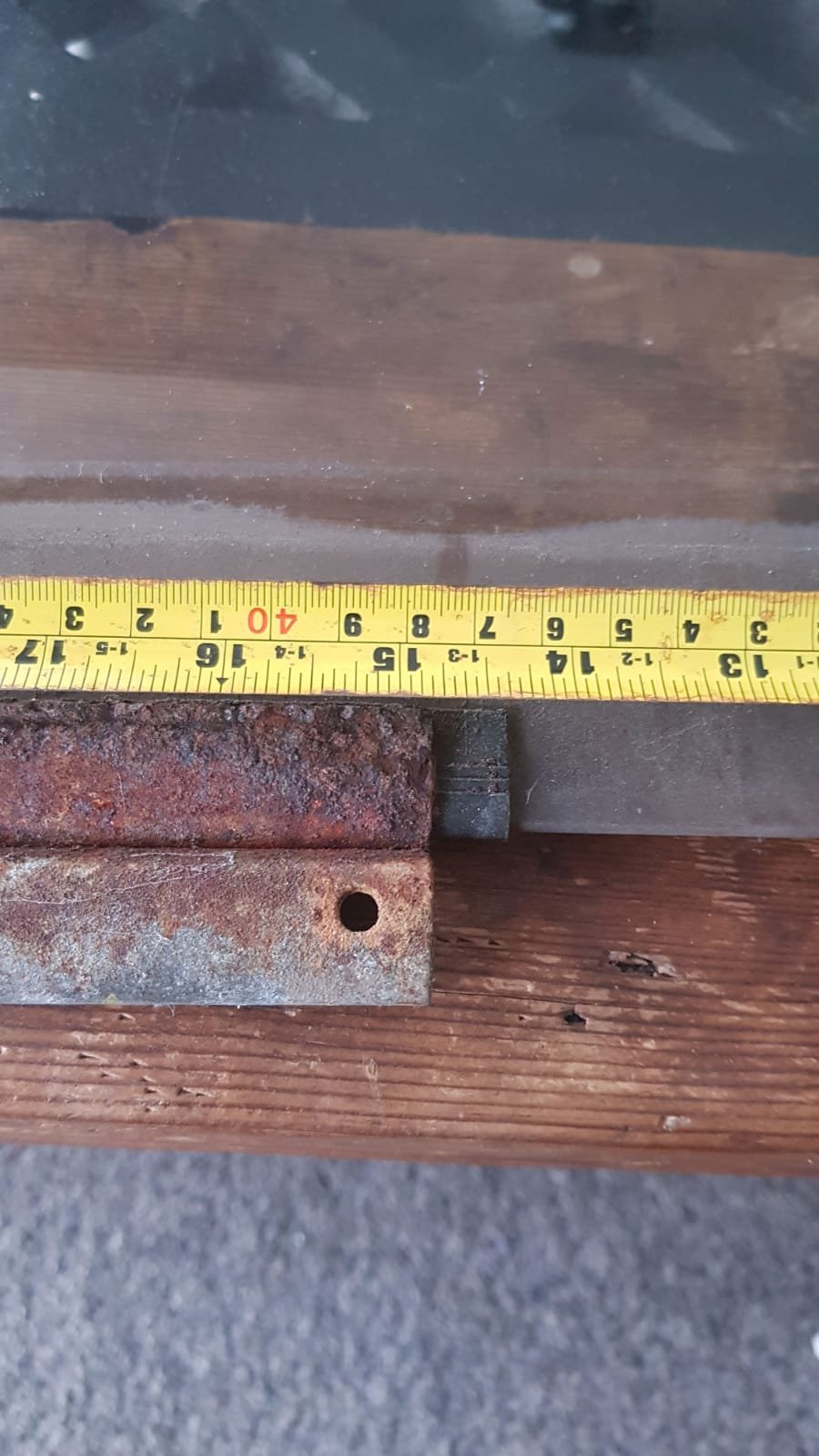

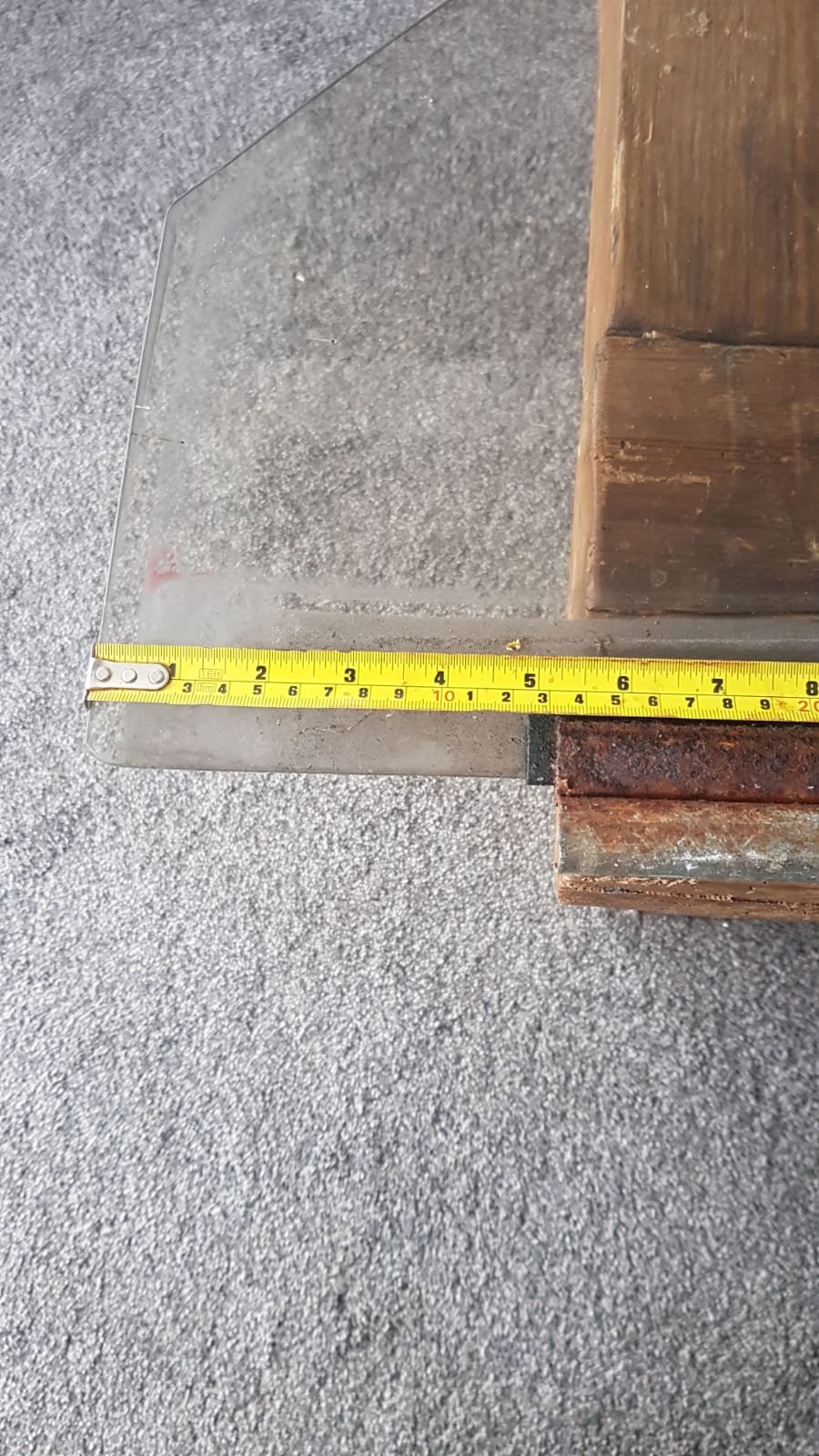

So thanks to Speno who measured the position of the slider piece on the glass for me. It almost looks wrong as it sits a long way forward on the bottom of the glass! But it seems it’s quite important it is correct.
Mine was only about 1/2” too far back, but clearly this was enough to cause a problem. Removed the glass from the door, gently tapped the guide piece to the correct place, put it all back together and it now stays in the rubber guide all the way up. As it should.
Photos of the dims below (thanks Spen). Approx 5 inches from the front of the glass to the front of the steel piece, approx 15 inches rear. Mine was only 1/2” wrong, but that’s clearly enough.
