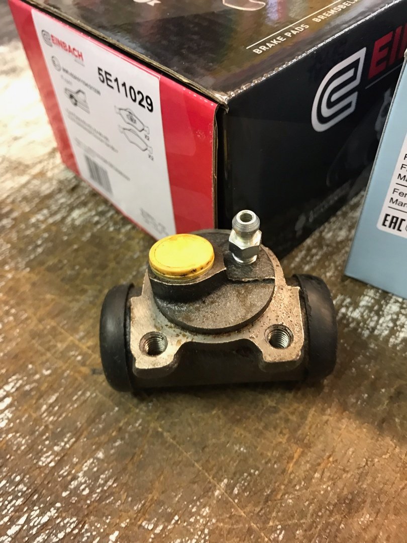

the replacement cylinder is like the one photo'd where the bleed nipple is adjacent to the input (so handed) and NOT above.
is that girling or bendix as i ordered replacement girling shoes but i think they are the wrong on
Enclosed pic of correct cylinder

Thats a handed self regulating Bendix wheel cylinder, be aware there are differing diameter ones ,depending on if you do or dont have a servo.
Servo is 19mm, non servo is 20mm.
The thread sizes differ, that ones a 12x1mm You need to match the tube nuts on the existing brake pipes.
I seond changing the other wheel cylinder and the master cylinder, they will be on their last legs .
https://www.ebay.co.uk/itm/UNIPART-BRAKE-SHOES-CITROEN-SAXO-PEUGEOT-106-205-309-90R-01042-181-GBS1267AF/133203918789?hash=item1f03927fc5:g:eVUAAOSwWktdpdrC
Those are the shoes to match that wheel cylinder You have.
Some diesels do have Girling (not yours) and they use servoed, handed,self regulating, 19mm diameter cylinders with an oval location boss, oval hole in the backplate, and narrower shoes than a GTI

The supplied cylinders are 20mm ones which appear to be the larger ones for the non servo brake system. can i fit them temporarily or will it cause issues? steve
Ozymandis
Dont do it, get the correct cylinders.
PSA knew what they were doing when designing it.
I think there are loads of old stock 20mm ones floating about  nobody ever used them as none servoed ones were rare.
Send em back to swap for the right ones?
Or if it was your error bin em and accept You have learned a thing or two?
Unbalanced  braking is a liability in an emergency stop. I presume Your going to be on public roads, obviously if You die in a fireball thats Your choice but what about the pram pushing lady who you stamped on the pedal for?
