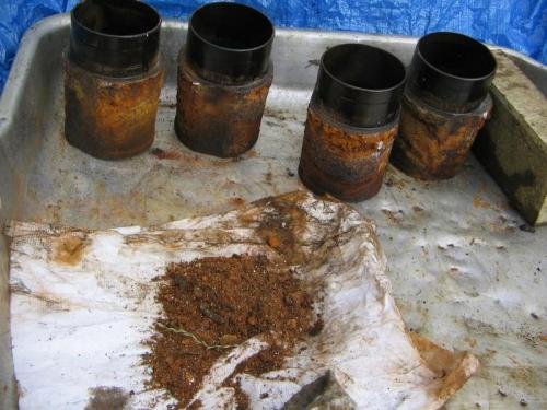

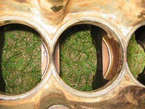

Telf
If you have a look at my engine build thread you can see the amount of crap that collects around the water jacket, around about page 3 or 4 ... The block in question was scrap due to corrosion between the liners/block and probably hadn't been maintained with the correct coolant. I can imagine that the gunk I found is what causes your coolant to discolour.
Worth noting on my rebuilt engine that's now done about 3000 miles the coolant is still bright blue( yep I've currently got a leak !)
SootySport
38 minutes ago, Telf said:
Found the pics.
Must have been a struggle removing those liners:wacko:
Telf
Actually no they came out ok. The interface between liner and block was completely wrecked though. Had to scrap the block
