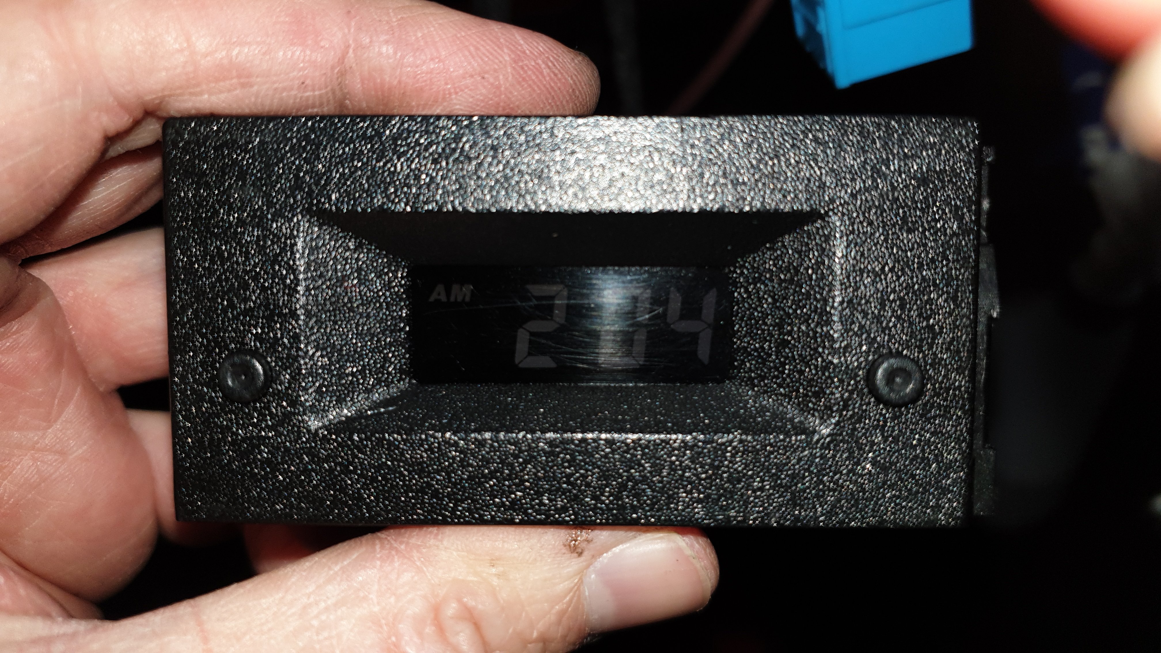

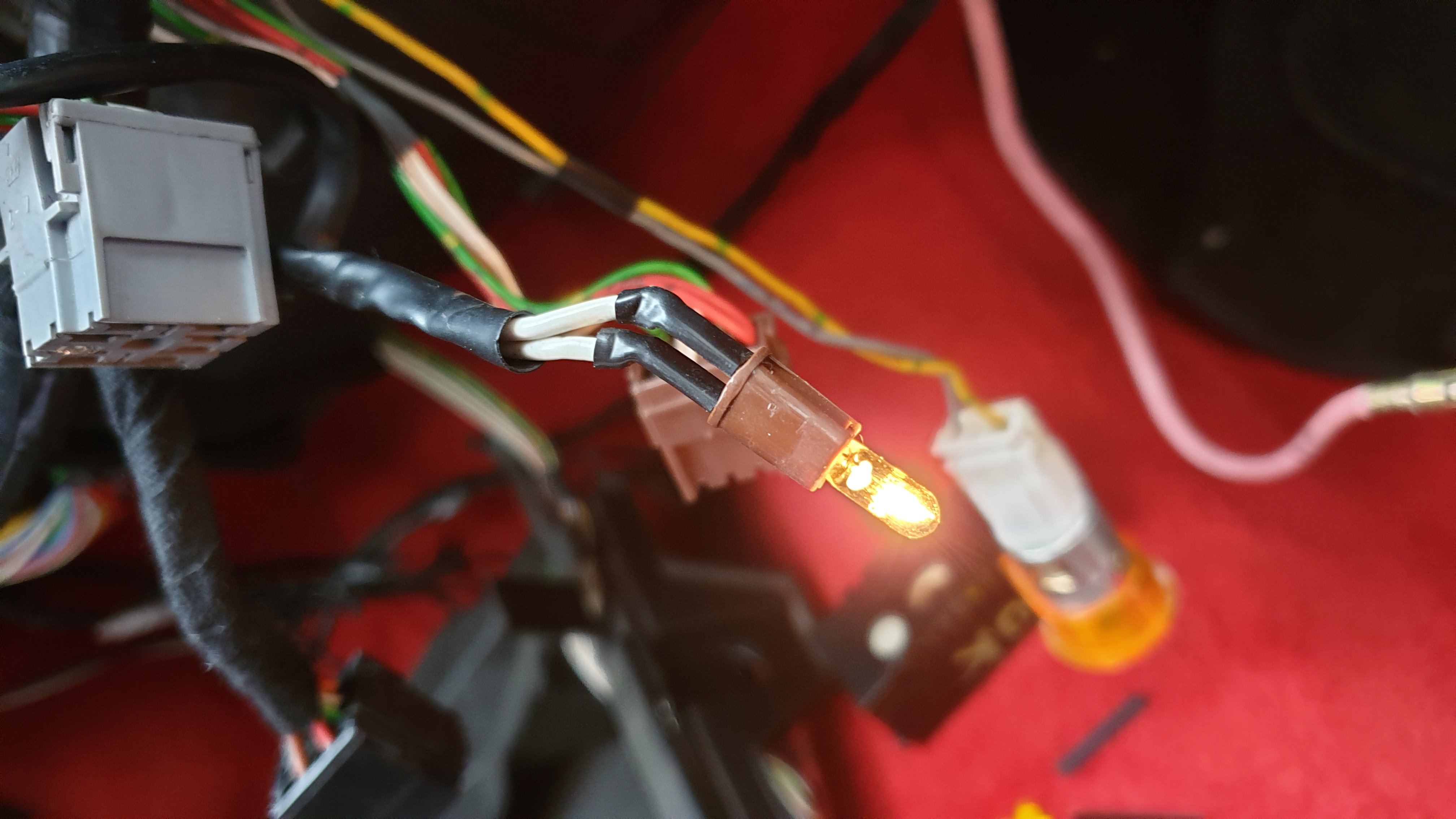

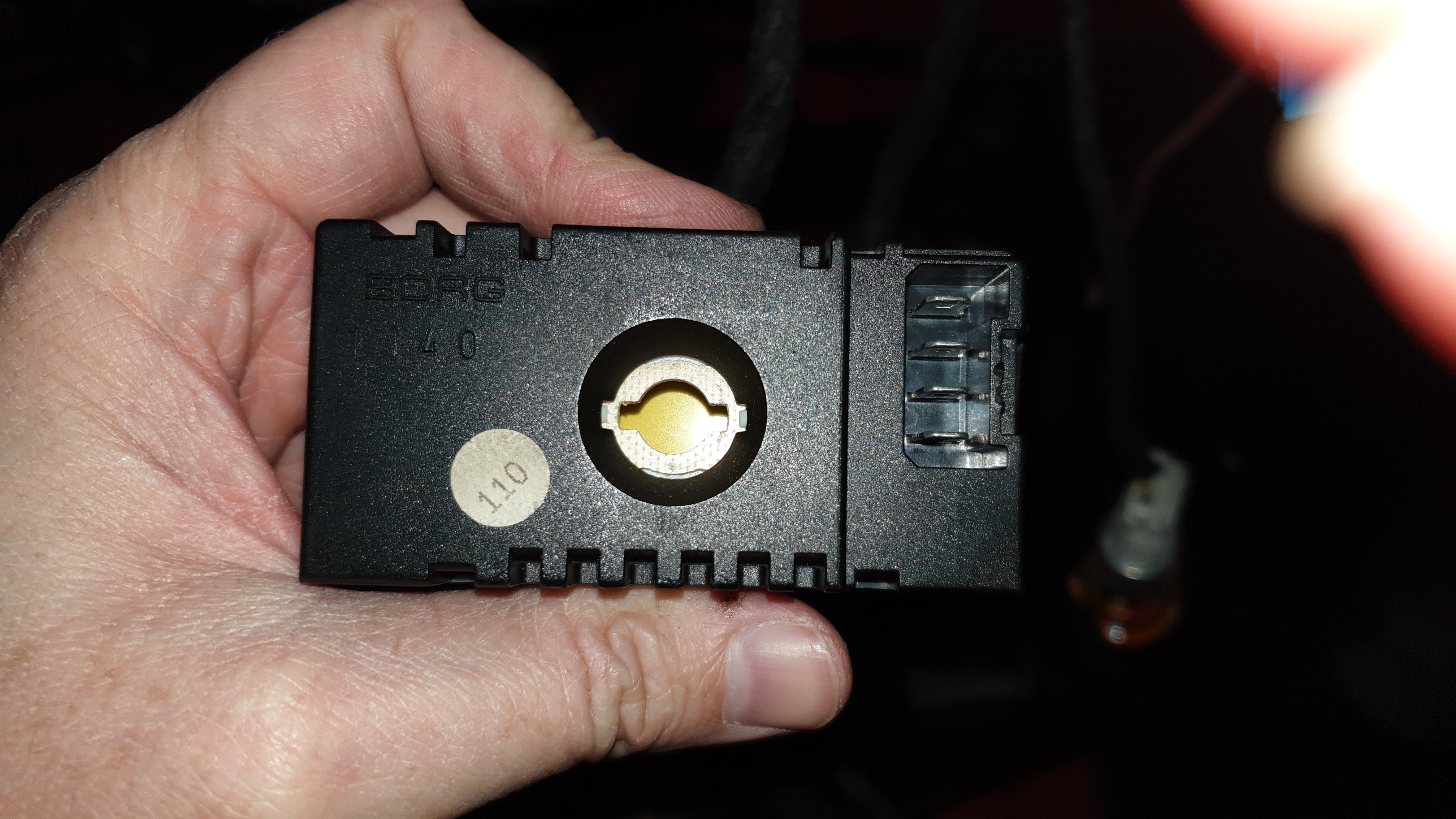

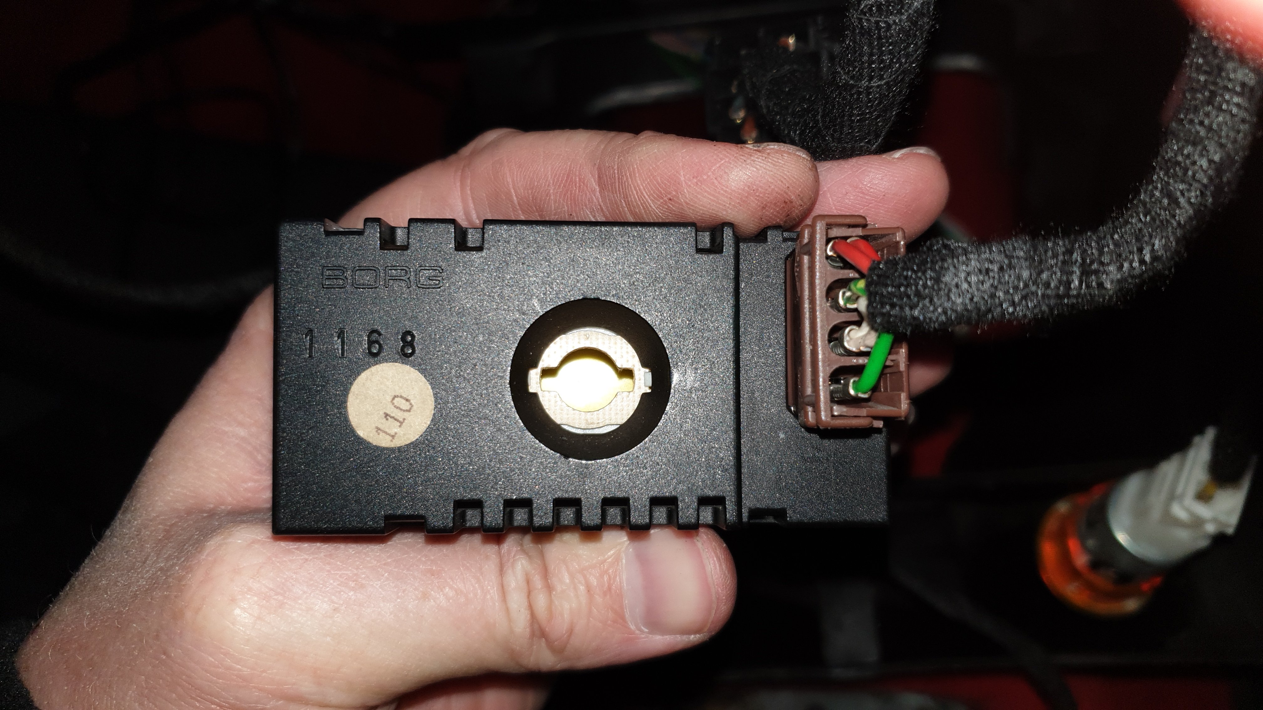

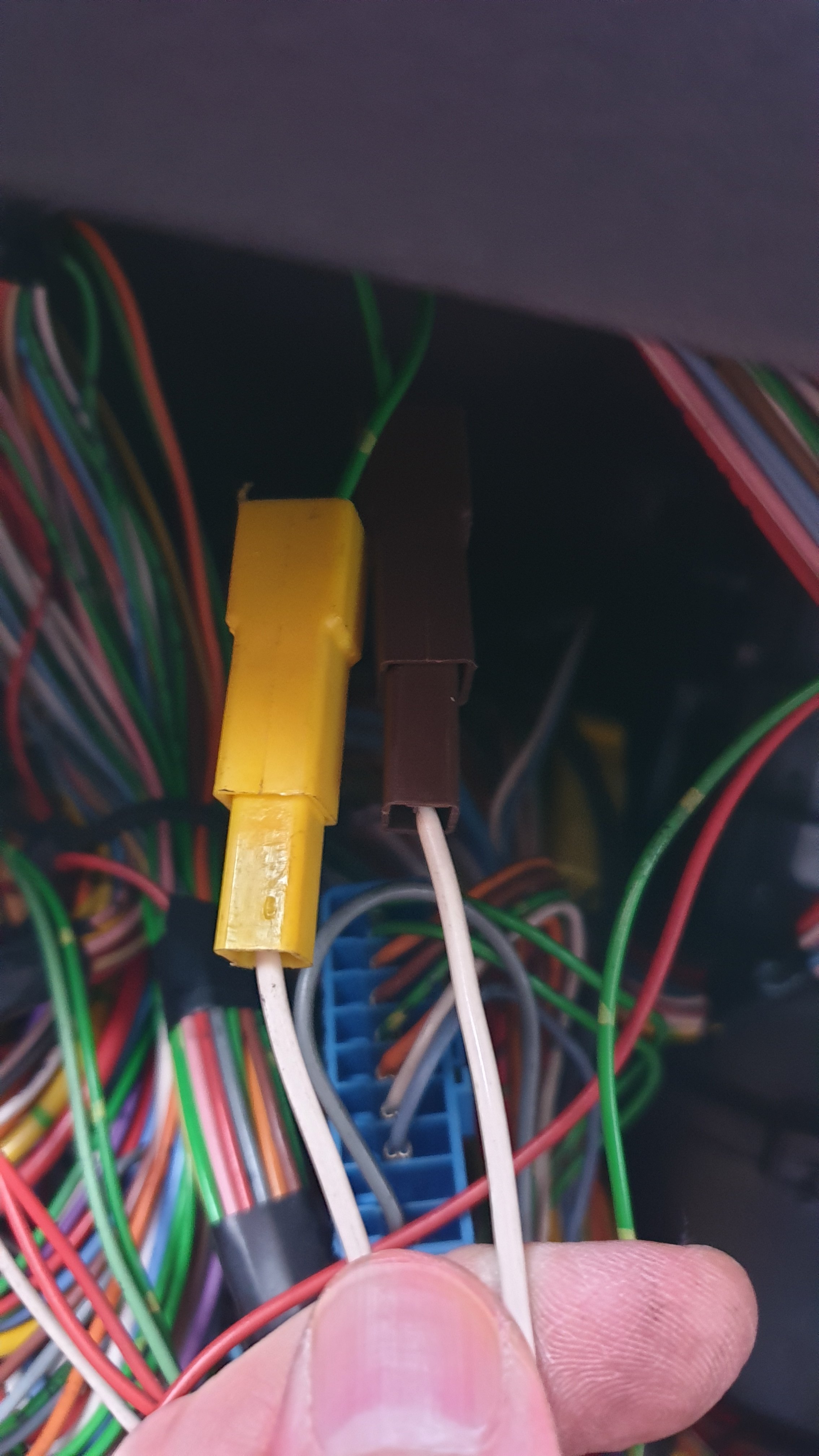

I bought a replacement clock and was a little confused about the back of it. It has a twist out bulb, looks like a 509T. Mine has a bulb on a cable going back to the fuse box area. See pics. BUT, mine was cable tied into the clock so I suspect a bit of bodgery, although the connectors look factory.... have they used the glovebox harness and bulb or something?

Do you have any pictures of the clocks? There may be more than one manufacturer but it's strange to find another wiring loom.
Or maybe just like the 309 the full transition from what we call "phase 2" took more than one year.

I can't find a bulb for the glove box though..... I might reassemble that side first.
SRDT
With a 4 pin clock like that you don't need any extra wiring harness to power the bulb and dim it.
I think I have seed this kind of bulb somewhere, isn't that the one from the cigarette lighter socket?
Your clock needs a bulb and holder in the back of it. The floating small
bulb should illuminate the ashtray.
