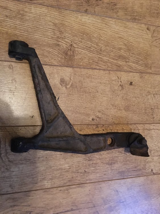

SootySport 23 Posted November 18, 2019 I’ve given up on removing the old bushes, they are well rusted in so new arms to buy now. Share this post Link to post Share on other sites
Tom Fenton 1,524 Posted November 18, 2019 25mm holesaw, cut through the rubber push the centre piece out. With a hacksaw cut into the steel shell, once nicked through the steel will push out easily. You then need a press or a strong vice will probably do to fit the new bushes. Share this post Link to post Share on other sites
SootySport 23 Posted November 19, 2019 23 hours ago, Tom Fenton said: 25mm holesaw, cut through the rubber push the centre piece out. With a hacksaw cut into the steel shell, once nicked through the steel will push out easily. You then need a press or a strong vice will probably do to fit the new bushes. Yes, done all that but can’t push out the outer sleeve, it’s well rusted in even using the vice. Spent a whole day on them so giving up now and ordered new arms. Share this post Link to post Share on other sites
welshpug 1,621 Posted November 19, 2019 they fall out once you cut the sleeve. Share this post Link to post Share on other sites
Tom Fenton 1,524 Posted November 19, 2019 53 minutes ago, SootySport said: Yes, done all that but can’t push out the outer sleeve, it’s well rusted in even using the vice. Spent a whole day on them so giving up now and ordered new arms. You can’t have done everything I said as the outer steel shells would be in the bin. I’ve done dozens of these bushes and it works every time. Cut through the steel shell with a hacksaw. It will then tap out of the wishbone with little to no effort. Share this post Link to post Share on other sites
SootySport 23 Posted November 20, 2019 There's rust Tom and then there is rust. My new arms arrived today so they are going on, saves time and money, cleaning, painting and buying new bushes. I'm a busy boy, have started on my Westfield winter repairs and upgrades as well. Share this post Link to post Share on other sites
