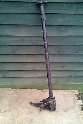

Like Meiron said, this isn't applicable to a 205. A collapsible steering column is something which applies to really old vehicles with a solid straight steering column, like a transit MK1. (see pic below)
The 205 has two u joints in the column which circumvent the column entering the vehicle in case of a frontal crash.
