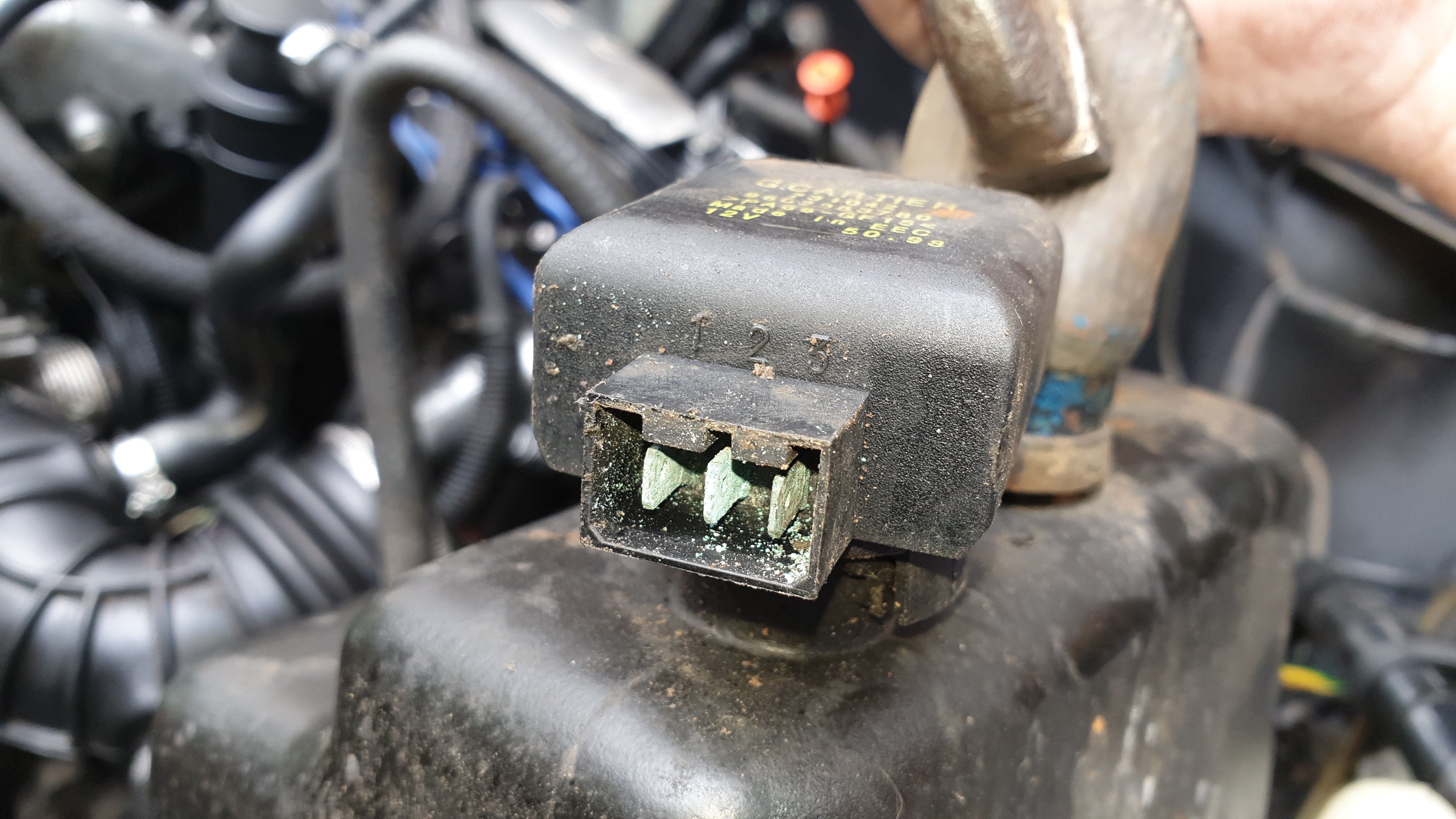

Hi all,
Can anyone please advise how to remove the green corrosion in the sensor for the expansion tank?  I was initially thinking electrical contact cleaner and a toothbrush but thought someone might have a better solution?
Thanks!
DamirGTI
I use nail file , or 500grt sanding paper folded in the shape of stick .. and contact cleaner spray .. scrub with the abrasive each terminal and wash off with contact cleaner , will clean up nicely .

DSYKES5500
Superb! Thanks for that.
jackherer
Once it is clean put some Contralube 770 on it so it stays that way.

DamirGTI
Back in the days , i used copper grease for the connector terminal protection after clean-up .

jackherer
Isn't copper grease conductive?
Vaseline is a good alternative to Contralube 770 but I can't rate Contralube highly enough, all my indicators and foglights etc worked for over a year (2 MOTs!) for the first time since I've had a 205.
SootySport
No, don’t use Copper Grease, it’s not a good conductor, Contralube is the best, although £25 a small tube but it does go a long way, use sparingly.

jackherer
Contralube is an insulator! It protects the electrical connection between the metal terminals but it isn't a conductor itself.

SootySport
Thanks for that, I thought it was a gel to improve conductivity,  live and learn eh!
