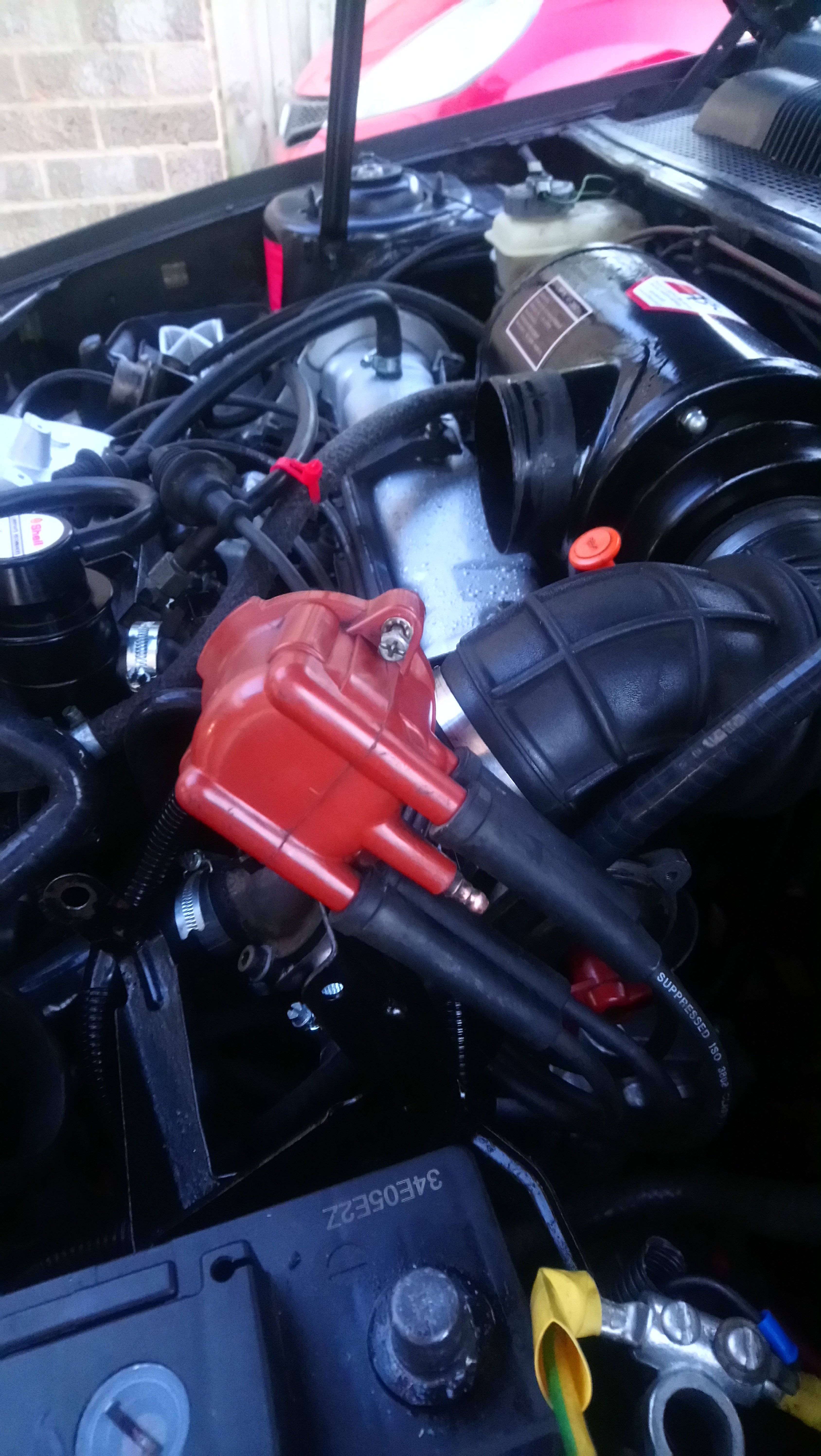

Hi, I'm new to this site and I'm in need of some help. I have a 1.6 1990 with  xu5j engine and need help with the firing order, I know its 1-3-4-2 but need to know locations on the distributor cap, if anyone can help I would appreciate it.
Image shows an Mi16 but lead positions on the cap & engine is the same, not forgetting that #1 is at the flywheel end (nearest the dizzy).

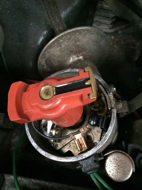

Just to add: on the distributor (with the cap removed) you'll notice a small notch (+/- 8 o'clock position in image) as in the image below. This indicates cylinder 1 on the dizzy itself.

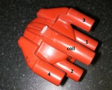

Thanks for the help guys much appreciated but I'm just not 100% sure/confident on where each one goes based on the first image compared to mine.
The only difference between the image & your cap is the king lead from the coil is facing the opposite way, other than that the leads to the plugs are in the exact same order.

Ren89
OK thank you I've got it now cheers.
