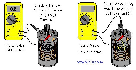

Test a coil with a resistance meter,
the primary wants to be a small resistance eg half to one ohm`ish
the secondary wants to be a higher resistance eg six and a half to seven and a half Kilohms`ish
A functional test is to connect one coil terminal to earth and "flash a positive to the other and you should get a small belt, even a spark if you put a lead from it to an earthed spark plug, crude and a basic "does it make a spark" kind of thing

Thanks all. The coil had failed. Both primary and secondary windings had reasonable readings but swapped another and it fired straight up.

I disagree. It clearly tells You if the coil is either open circuit or short circuit, both meaning bin it and dont look any further.
How is that a waste of time?
How many dead coils have you actually come across that are open circuit or short circuit? They are not common failure modes for a coil in my experience.
Ozymandis
Since January this year  just one, a 1994 Honda Del Sol JDM coupe the  leads had come loose, poor quality Sovereign branded pattern parts, and was leaking HT all over the head and the primary went open cicuit I think it overheated and flashed over internally.
Rover coils do it commonly as do many engines with that style of dry coil, when they have significant HT leakage, eg chaffed/ abraded or loose leads.
This was a common thing.
I have seen I think 3 other dodgy coils in the same time, yes all measured fine but flashed over under HT and failed to give good spark
So detecting a quarter of the failures I have dealt with in the last year to date certainly isnt a waste of time.
This does not include modern coil pack type plug top ones, or wasted spark types.
Just traditional distributor cap/rotor arm ignitions.
Last year I had a 1981 MGB based kit car an NG, with no spark and the coil was short circuit, it had a ballast resistance type coil with a direct 12V feed I think the windings melted and shorted
I shall always check the coils resistance as it does detect some bad coils.
I also use a Techtronix scope  , but the simple tests dont get overlooked.
If You choose to diagnose by "throwing parts at it", fine do as You like Sir.
