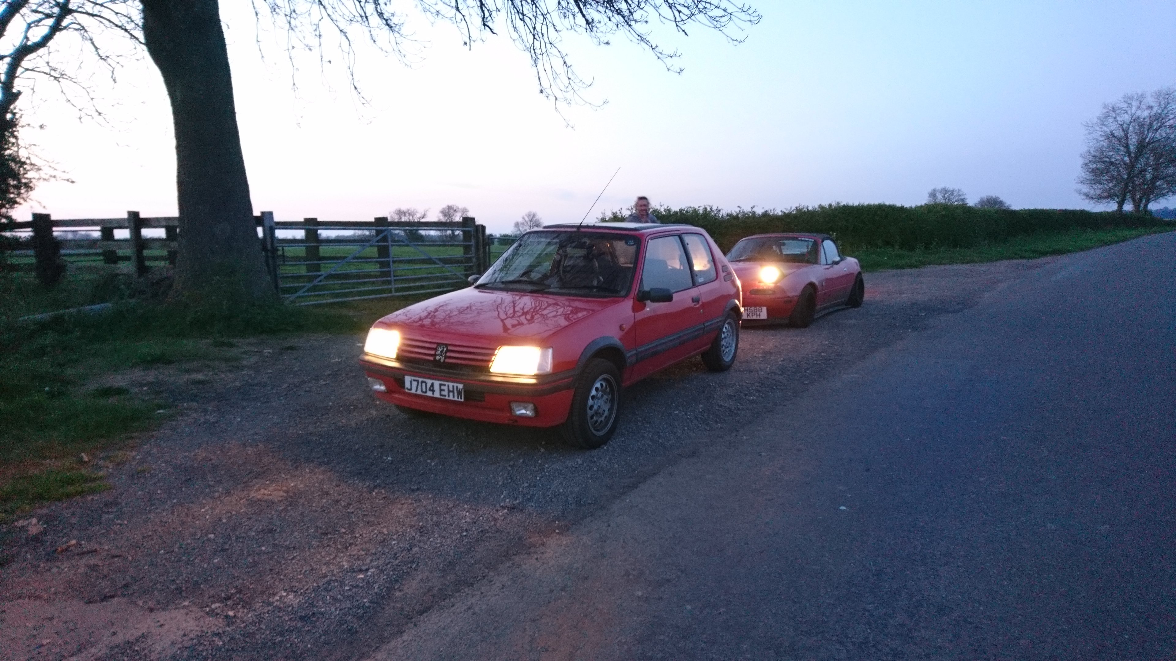

Hi all. I have a 1.6 gti, 1991 and I'm told it has a high lift cam, can't confirm right now, assume it doesn't. And twin 40 weber dcoe carbs.
Now, it runs like a pile of poo when cold, and 1-2500k is a bit lumpy if you floor it.. Past that it takes off like a stabbed rat, and really does go.
I've never bounced it off the Rev limiter so no idea how high it would Rev, I don't trust it not to fire a valve through the piston like I trust my good ol 4age engine.
Any idea what sort of power it would have over the standard 115bhp?
Engine is really well serviced by yours truly and uses no oil or water. And it towed a broken down mx5 with no issues atall.
