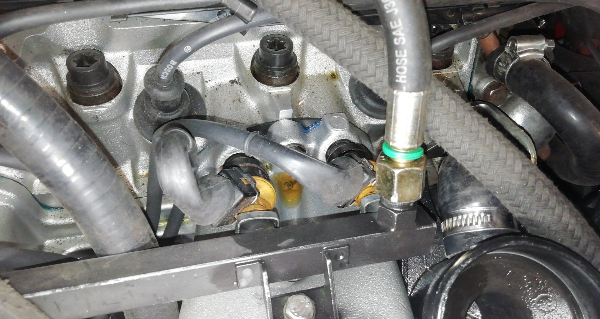

Also I've got oil collecting on top of the inlet chamber as pictured, the filter cap wasn't fully down but does the breather circulate much oil?

So today I had another look. Seemed to have stopped the oil leak. When cold the gauge is across at the 4th mark and as it heats up it moves over and is now sitting just above the first mark. Low px light doesn't come on, radiator fan is tripping on and off. I left the car to idle for 20 mins again and it stayed like that.

Yeah I kind of figured as much. It's been almost 2 years since it's turned a wheel and I couldnt remember what it used to do tbh. The oil loss seems to have mainly stopped since I fully engaged the filler cap.. I didn't think it would leak as it was semi engaged but not fully pushed in. Seems I was wrong!!
