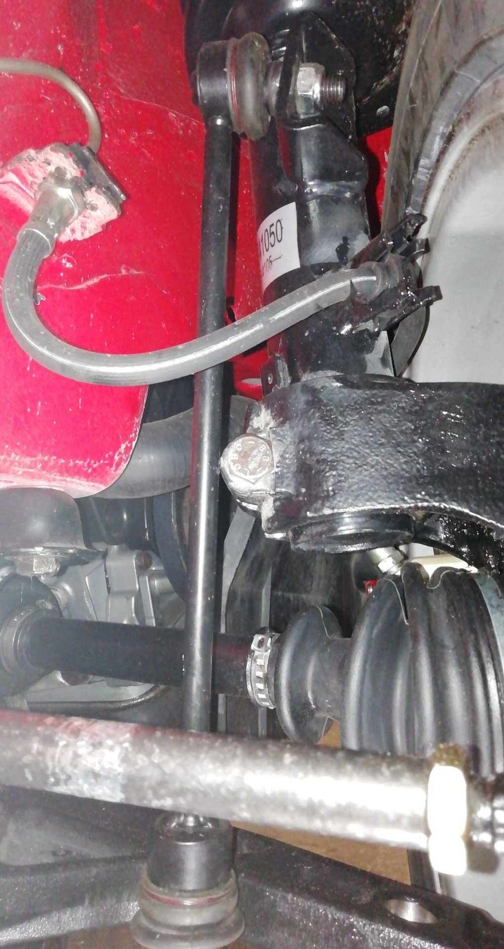

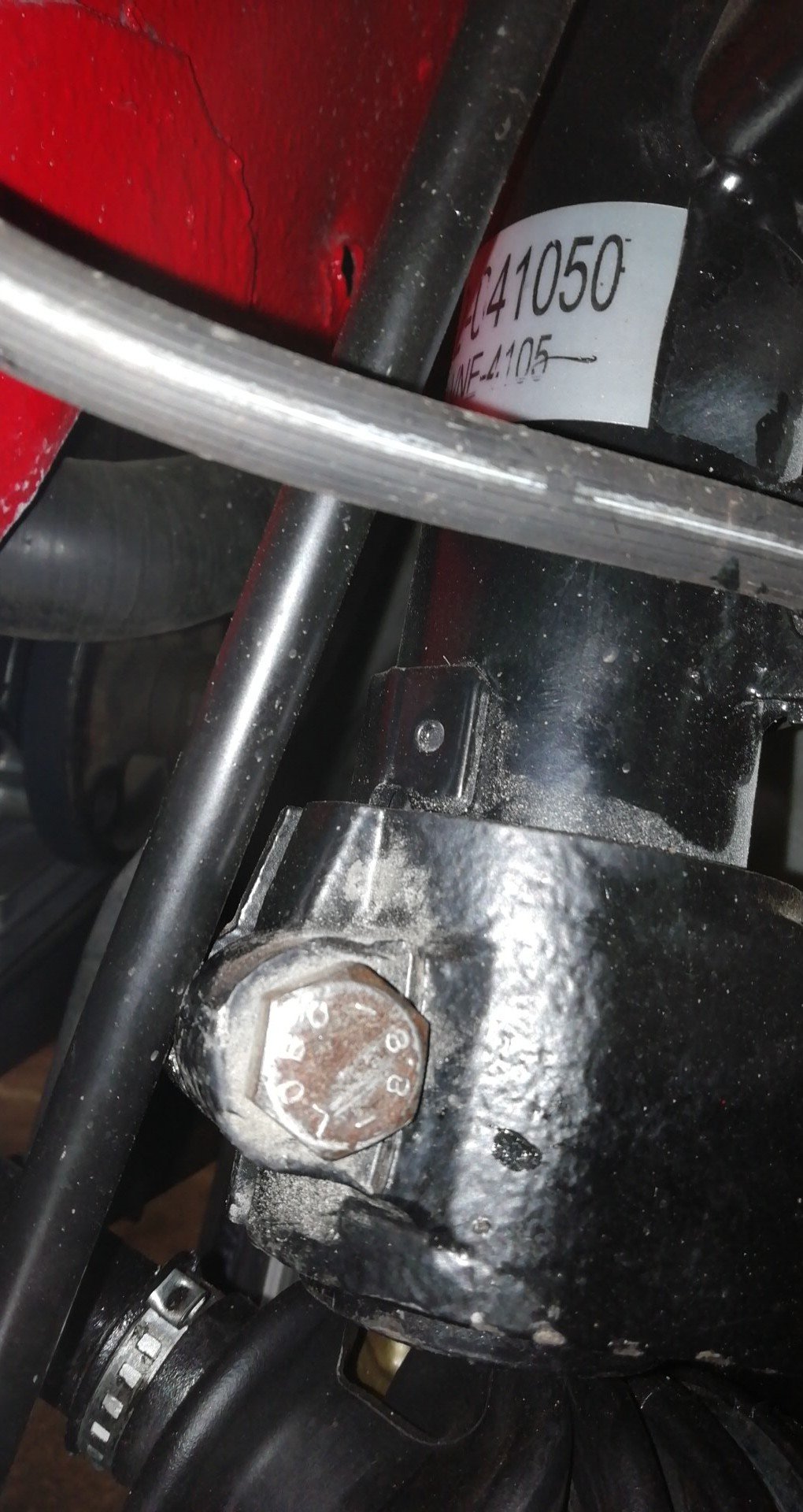

Telf 222 2 Cars Posted April 27, 2019 My drop links are touching the suspension strut where the strut meets the hub bolt. See the picture Major confusion! Anybody any idea what the hell I've done wrong? I've spotted it whilst I am check torquing everything. Share this post Link to post Share on other sites
DamirGTI 322 Posted April 27, 2019 Nothing "wrong" , it's the aftermarket links .. had a few of them doing the same thing . Just shim the top (strut) side of the link with an couple of washers till it clears the hub , and it'll be fine . D Share this post Link to post Share on other sites
jackherer 543 Posted April 27, 2019 OEM droplinks were tapered specifically to avoid this: Share this post Link to post Share on other sites

Tom Fenton 1,518 Posted April 27, 2019 Only really happens on full droop eg when the car is jacked up. Put it back on its wheels and you will probably have adequate clearance. 1 Share this post Link to post Share on other sites
Telf 222 2 Cars Posted April 27, 2019 Ok cheers guys. On wheels it still isnt clearing properly. I'll shim it out Share this post Link to post Share on other sites

happypatrol 5 Posted April 30, 2019 I can confirm i had the same problem after replacing drop links and arms. Tried everything and in the end packed it out with a couple of washers. not had a problem since. Share this post Link to post Share on other sites
