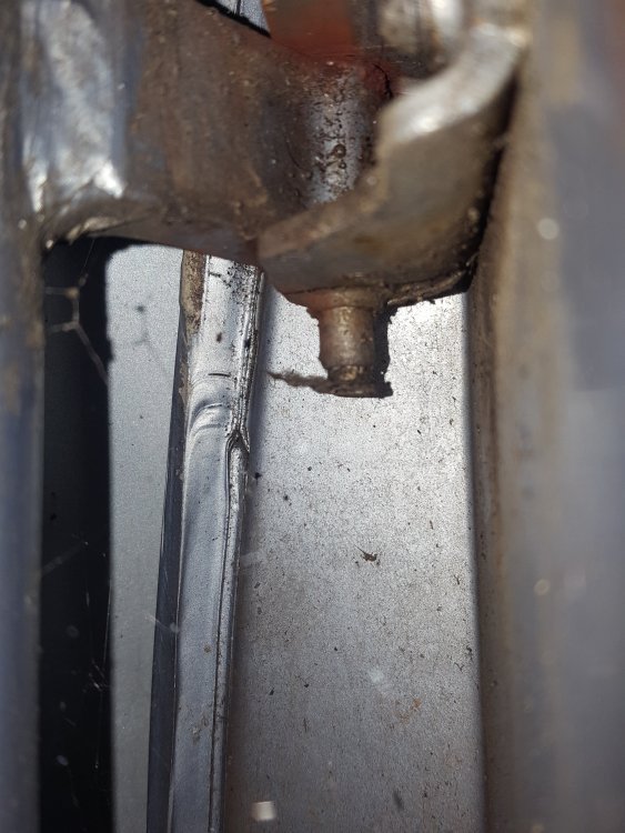

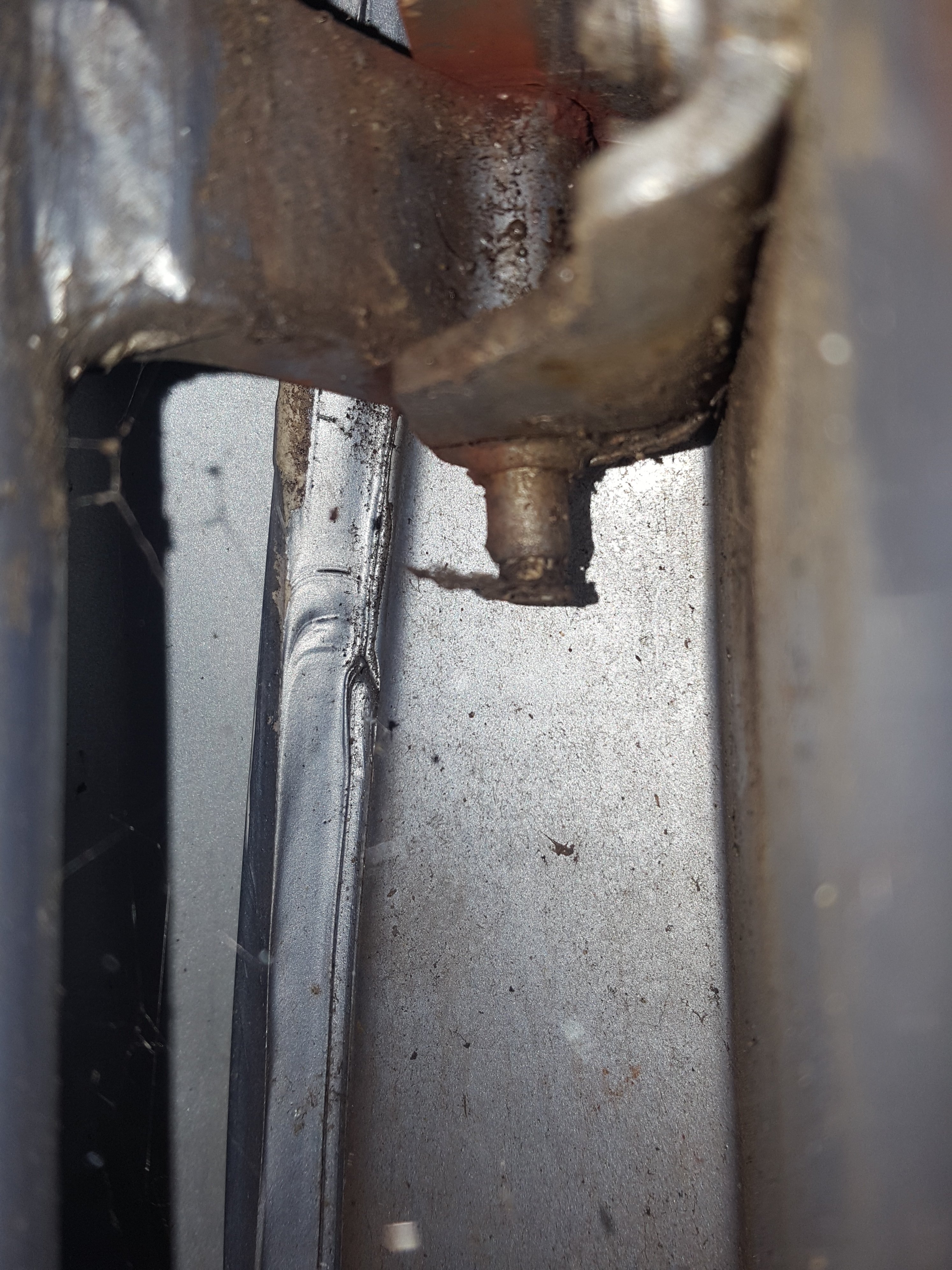

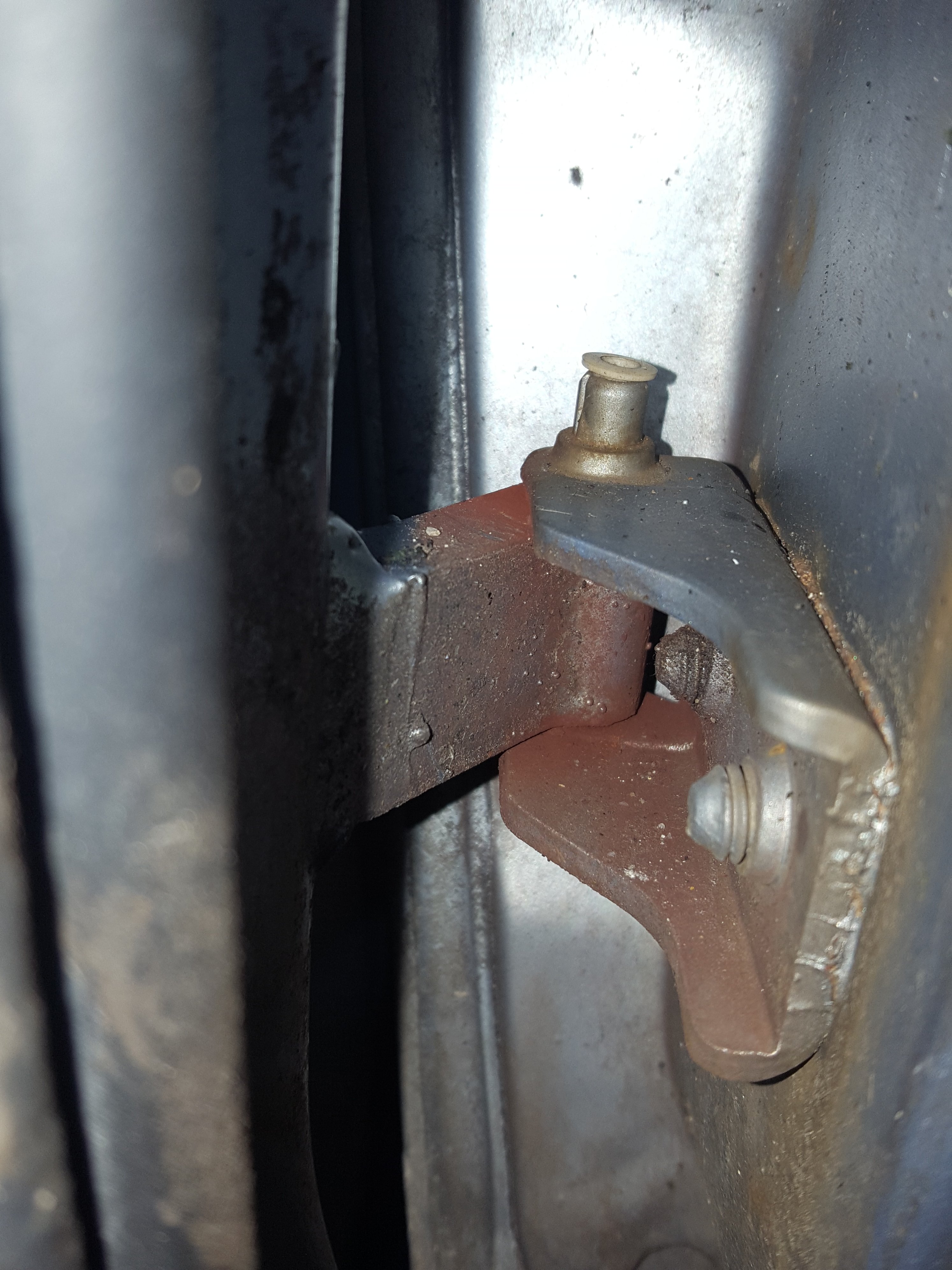

beyada 0 Posted April 23, 2019 My 205 XS needs new door hinge pins but cant identify the ones that are on the car. Attach some photos. Can anyone help and let me know where I can buy them. Thanks Share this post Link to post Share on other sites
Archie's mid life crisis 0 Posted April 23, 2019 Those look like the roll pin type. I recently did this job and I couldn't source original Peugeot replacements (part number 904430). Full hinge sets are available on fleabay, tho. I used standard 7 X 50 roll pins and they have worked fine apart from one hinge where the hinge bracket had worn excessively. For that one I welded up the bracket holes and re-drilled to the correct size. It's worth pointing out that the original Peugeot pins had a raised lip that engaged in the hinge bracket that made sure that the pin rotated in the body hinge only. If the hinge bracket holes are a bit worn you may find that the roll pin wants to turn in the bracket rather than the hinge. Share this post Link to post Share on other sites
beyada 0 Posted April 23, 2019 12 minutes ago, Archie's mid life crisis said: Those look like the roll pin type. I recently did this job and I couldn't source original Peugeot replacements (part number 904430). Full hinge sets are available on fleabay, tho. I used standard 7 X 50 roll pins and they have worked fine apart from one hinge where the hinge bracket had worn excessively. For that one I welded up the bracket holes and re-drilled to the correct size. It's worth pointing out that the original Peugeot pins had a raised lip that engaged in the hinge bracket that made sure that the pin rotated in the body hinge only. If the hinge bracket holes are a bit worn you may find that the roll pin wants to turn in the bracket rather than the hinge. Thanks for the reply really useful info. Share this post Link to post Share on other sites

farmer 327 1 Cars Posted April 24, 2019 Hi No, but you will get them from a dealer, part number = 6983 23 £5 per pin plus post ( post £1.10 ) Last Peugeot price was £5.86 per unit Share this post Link to post Share on other sites
