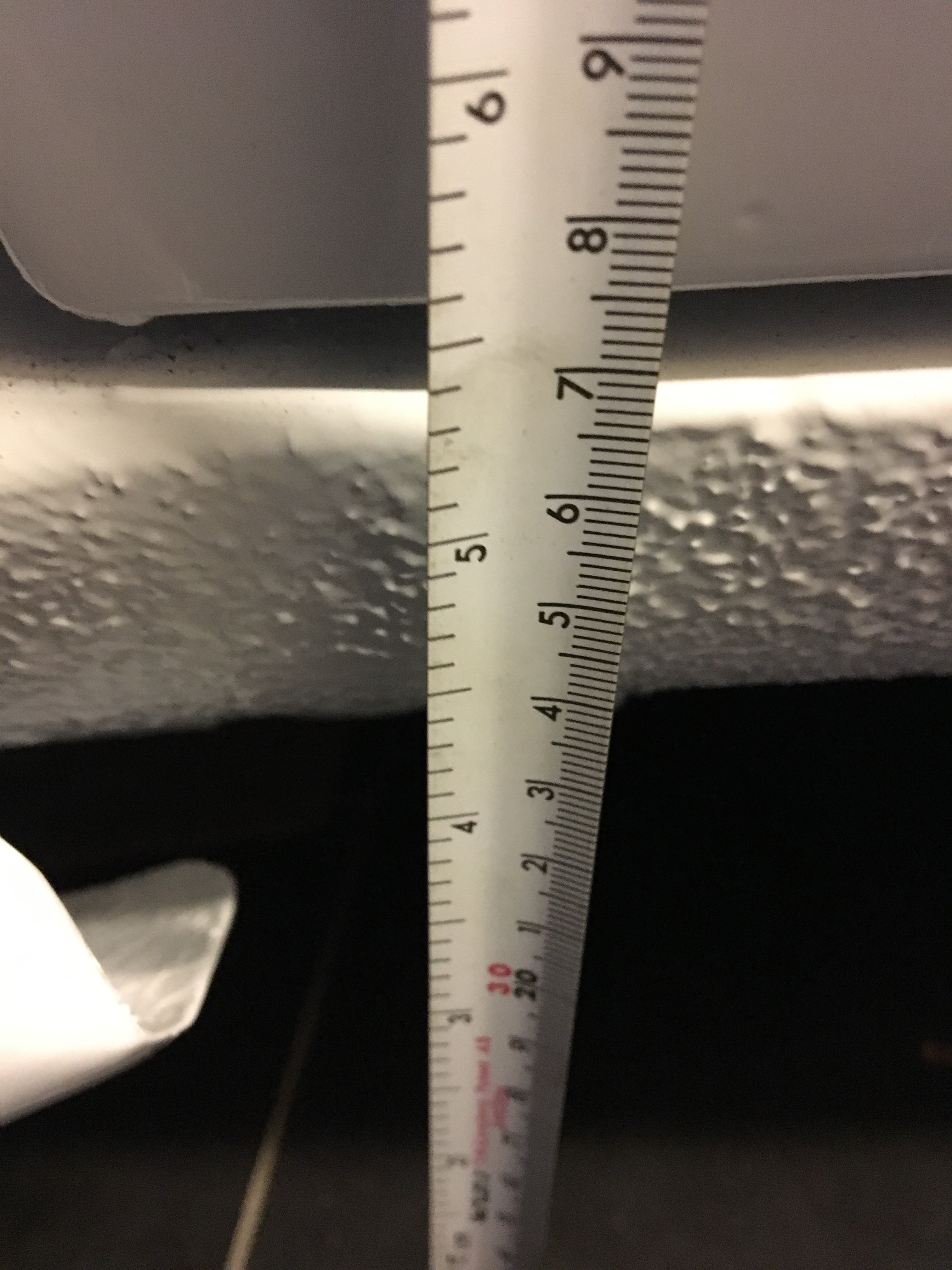

I’m setting up My suspension on My race only 205. Due for some corner weights in a weeks time.
Trying to find the right relation between front and rear height. It needs to be a little higher in the rear....but How much higher? Right now it is approx 2cm higher in the back.
Any thoughts/pointers Would be appreciated. Thanks.
20-25mm is correct
mmt
Thanks Peter. Where do you measure please?
Either end of the sill. It will vary a bit after it's corner weighted.

Regulations says min 50 mm Ground clearance. It is not going to be that low on std. Wishbones.
