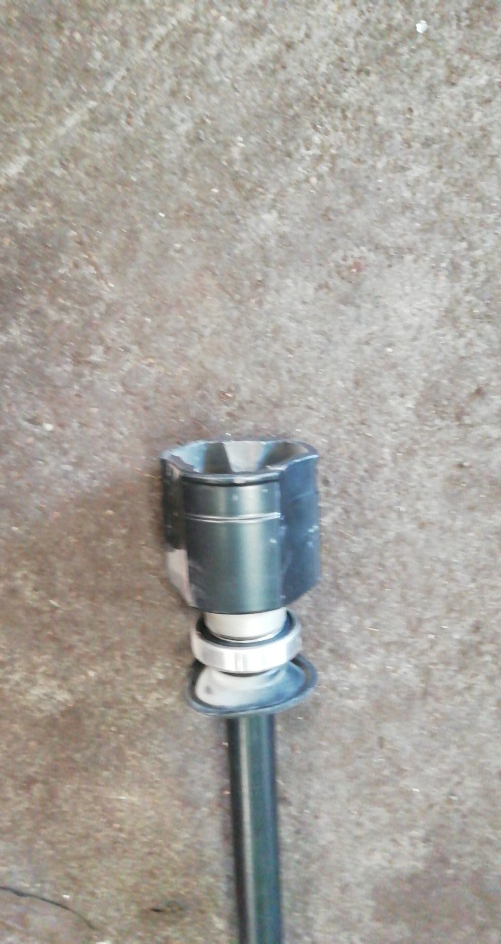

I'm tearing my hair out trying to get the correct CV boot for the driveshaft pictured. It needs to be tri lobal
. Does anybody know the part number please?!?

Only ever come across one like that once. I think you’ll struggle to find the right boot. It might be easier to buy a complete shaft....
indeed not seen one like that on a 205 before, they arent especially strong, the expert and boxer vans have them however with an ML box and a larger cup and shaft.
have you measured the effective diameter of the cup and the shaft?
Rippthrough
206's with the 1.4 have them, I managed to get a factor boot the right shape but only after about 10 attempts!

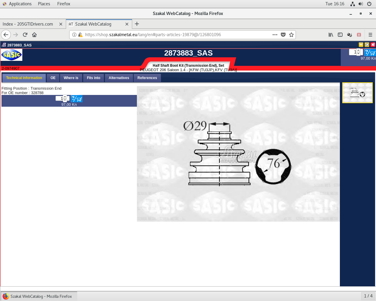

DamirGTI
Three variations of them as it seems .. so one would need to do some measurement before order .
Availabe-made by :
GKN
SKF
Spidan
Febi
