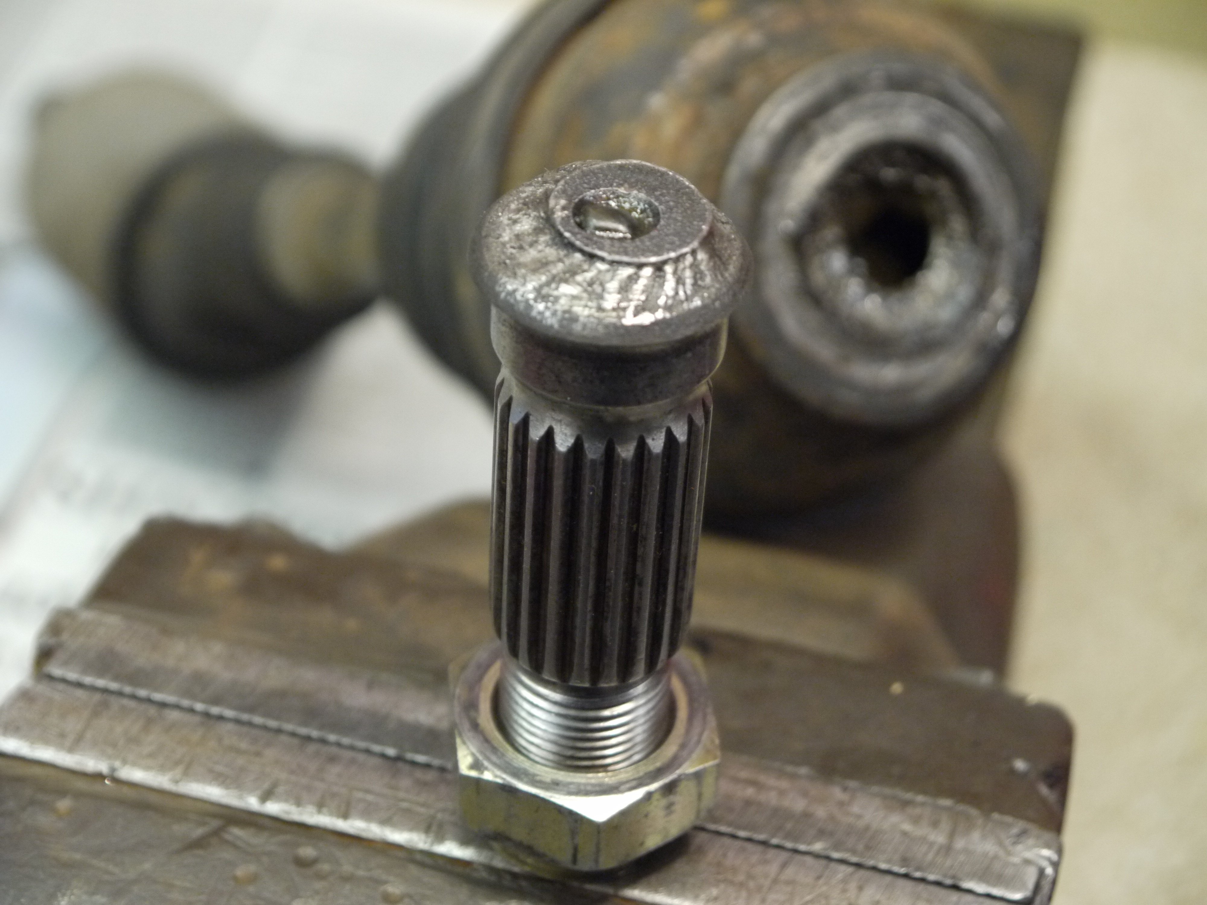

Ozymandis 96 Posted March 18, 2019 I went to rescue her 205 and she wanted me to lend her the 205 I turned up in and wait for the tow truck as she was on a mission, i agreed, she waved bye, then did a wheelspin and slarted me from wooly hat to steelies with mud before dissapearing rapidly, I think I would have murdered her if I could have run fast enough. Share this post Link to post Share on other sites
Ozymandis 96 Posted March 18, 2019 I just thought, weld a nut to it and its useful for pushing cars about with no driveshafts in to clamp the wheelbearings up. Share this post Link to post Share on other sites
Tom Fenton 1,524 Posted March 18, 2019 Looking at the shiny areas, that has been fractured for a while I'd say. Share this post Link to post Share on other sites
Ozymandis 96 Posted March 18, 2019 33 minutes ago, Tom Fenton said: Looking at the shiny areas, that has been fractured for a while I'd say. She said it made "a funny noise" when she set off that morning, in 2nd powering off a roundabout about a mile down the road ,this. Its had a bit of a grinding sat there with the diff spinning that side as I tried to move it off the roundabout and figure out what was wrong. It had a C/V boot at the MOT spot ,they used a 3/4 drive windy gun and I think thats what did it. Share this post Link to post Share on other sites
