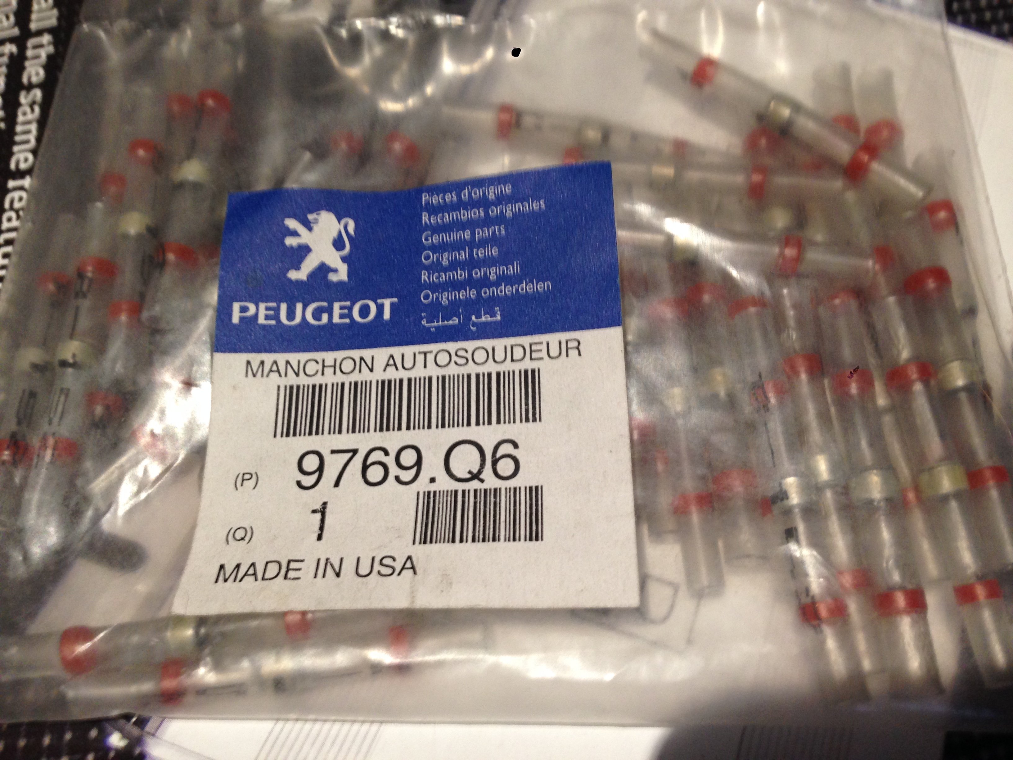

However I do think it's acceptable to splice new wire in using solder sleeves, it's actually the official Peugeot repair method, I have some solder sleeves in a Peugeot branded bag, part number 9769.Q6, they work very well but only on good shiny copper wire. If the wire is corroded you are wasting your time trying to solder or crimp onto it IMO.

Packs of 50 those repair connectors at 2.80 odd each:blink:
Edited by farmer
To be clear that's not what I paid and is not what I'm suggesting!
They are available without the Peugeot logo on the bag for pennies each.
E.g. https://www.amazon.co.uk/SO-buts-Connectors-Electrical-Waterproof-Multicolor/dp/B07H4HN52H/
I've used genuine Peugeot ones and the cheapest ones from ebay/amazon etc and I can't tell any difference.
The difference between these and soldering normally is two factors, firstly they are sealed so water can't cause problems and secondly they support the joint mechanically so vibration can't fatigue and crack it.
