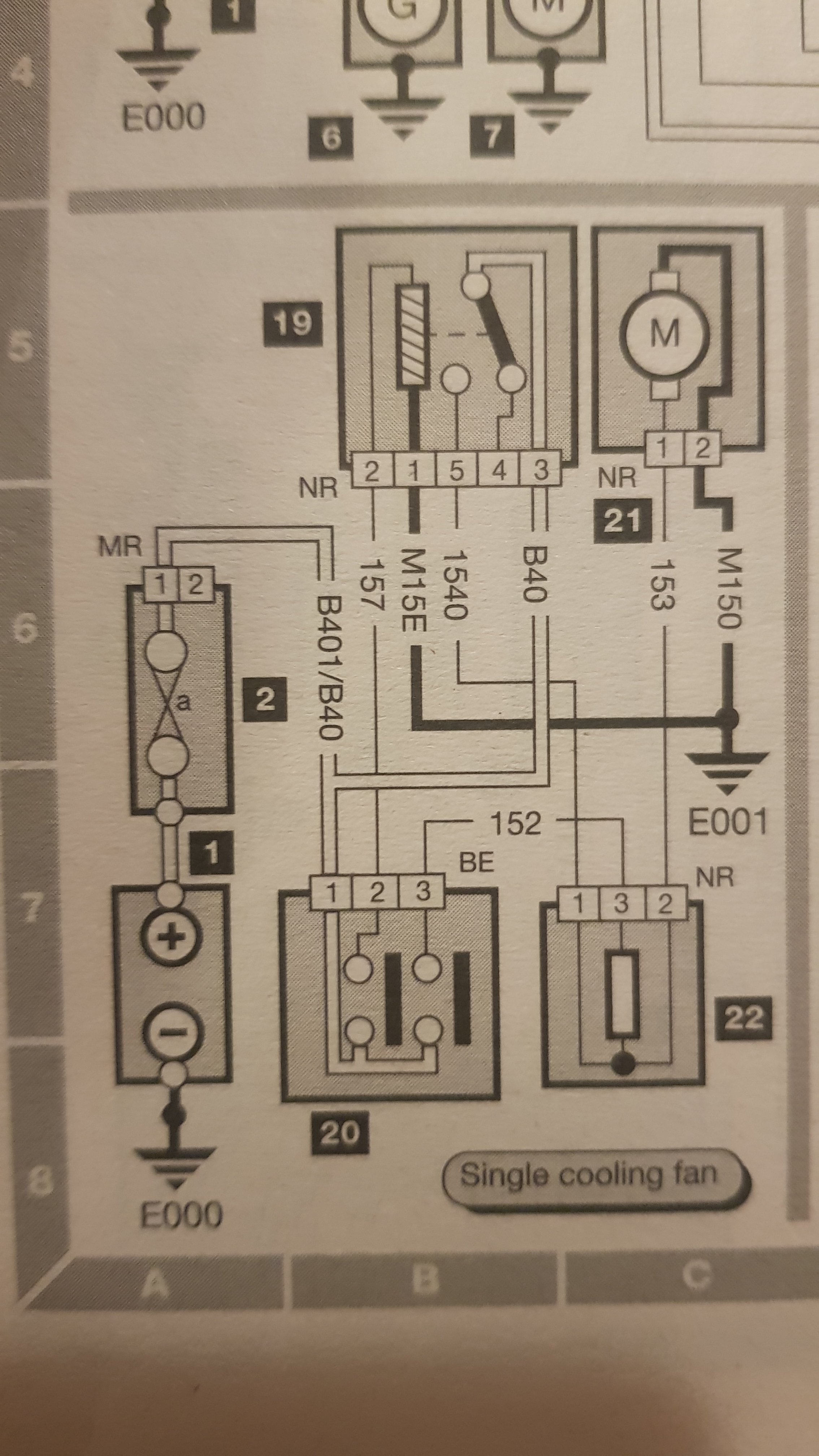

I would try and find a loom from a zx or a 405 single fan two speed, they use a relay  so the full fan current is nor drawn through the thermoswitch, far more reliable than the arrangement the 205 uses.
I've attached a picture of the diagram shown in the haynes manual for the 405 single fan loom.
looks like pin 1 is input and 2 is high speed via the relay, pin 3 is through the resistor.

Many, many thanks for the replies guy's. That helps loads, sounds like a relay is the order of the day here.
Just to be a complete pain and push my luck a little further here gents. Has anyone got a picture of the pins on the switch which shows which ones are number 1, 2, and 3, as I literally only have 3 wires (supply, fast, & slow.) and 3 pins on the switch to work with at the moment.
