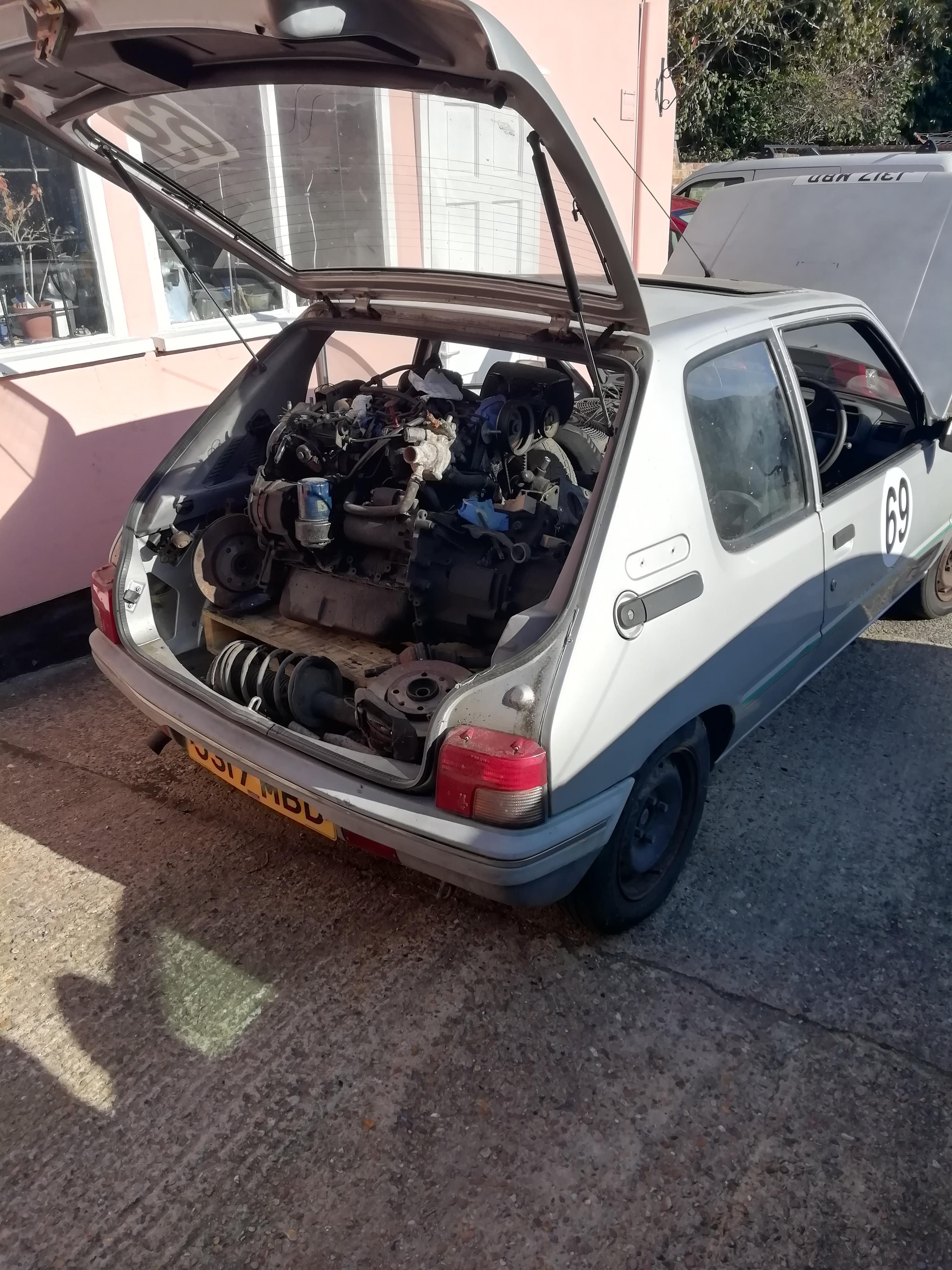

Hello everyone. Im new. well sort of i was on here about 6 years ago and also used to be a member of 306oc for a while so some of you might recognise the username. Ive massively been into xuds for a while now had a few in various configurations now.  However ive never had the opportunity to do this. Something that sparked my love of xuds. If youve ever seen the build joey on here and 306oc that was it.

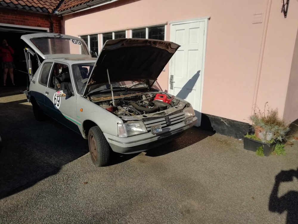

So anyway the opportunity arose when i needed another svo car. So i promptly sold the 2007 plate fiesta I had as a daily and delved into many ads of 205s. This one came along from a fellow 306ocer. It was bought for a stag do to Scotland and then was driven back and left in a workshop. The bloke had planned to do a xud7 turbo lump into it and had full stdt running gear on the front end with it. So a deal was struck and it made its way onto a friends transporter and on the way back. This was it when i went to view and put the engine in the back to get her home.

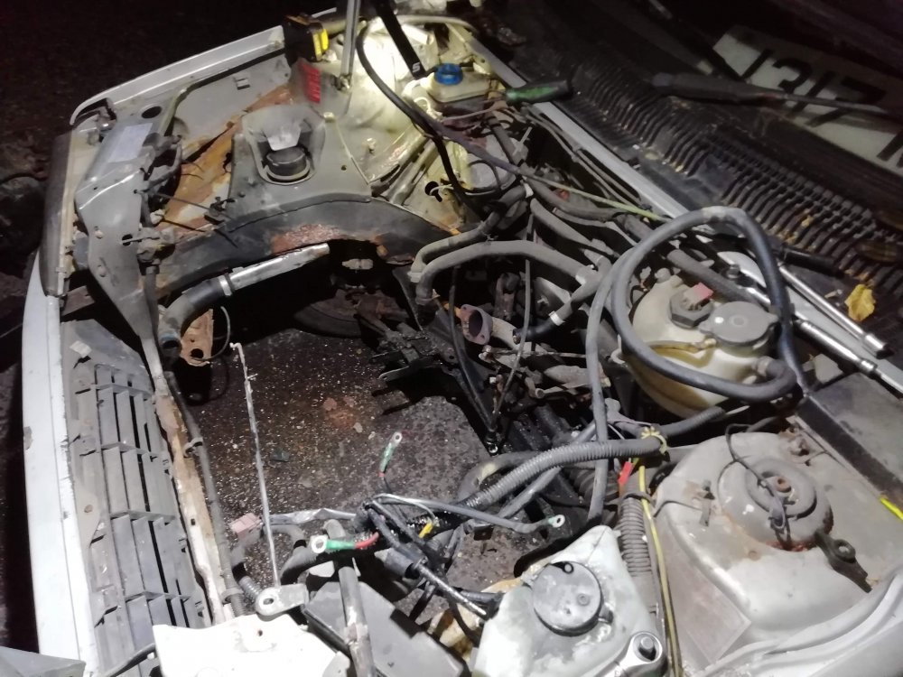

So anyway it came back and i booked it into its mot a week tuesday. Plenty of time to whip the engine out and check round. So i set about pulling the engine out. IMG_20181021_165522.thumb.jpg.71e183c3b7495aec3df476c53f3ea3f0.jpg
IMG_20181025_182801.thumb.jpg.7e875b0860a1195217dd610f3a2d6146.jpgIMG_20181025_182847.thumb.jpg.5f869cabc430e5b6f8fd5f2687c3347e.jpgIMG_20181025_182938.thumb.jpg.7a5685f48e3f3fb574d2b5057e44f7b0.jpg

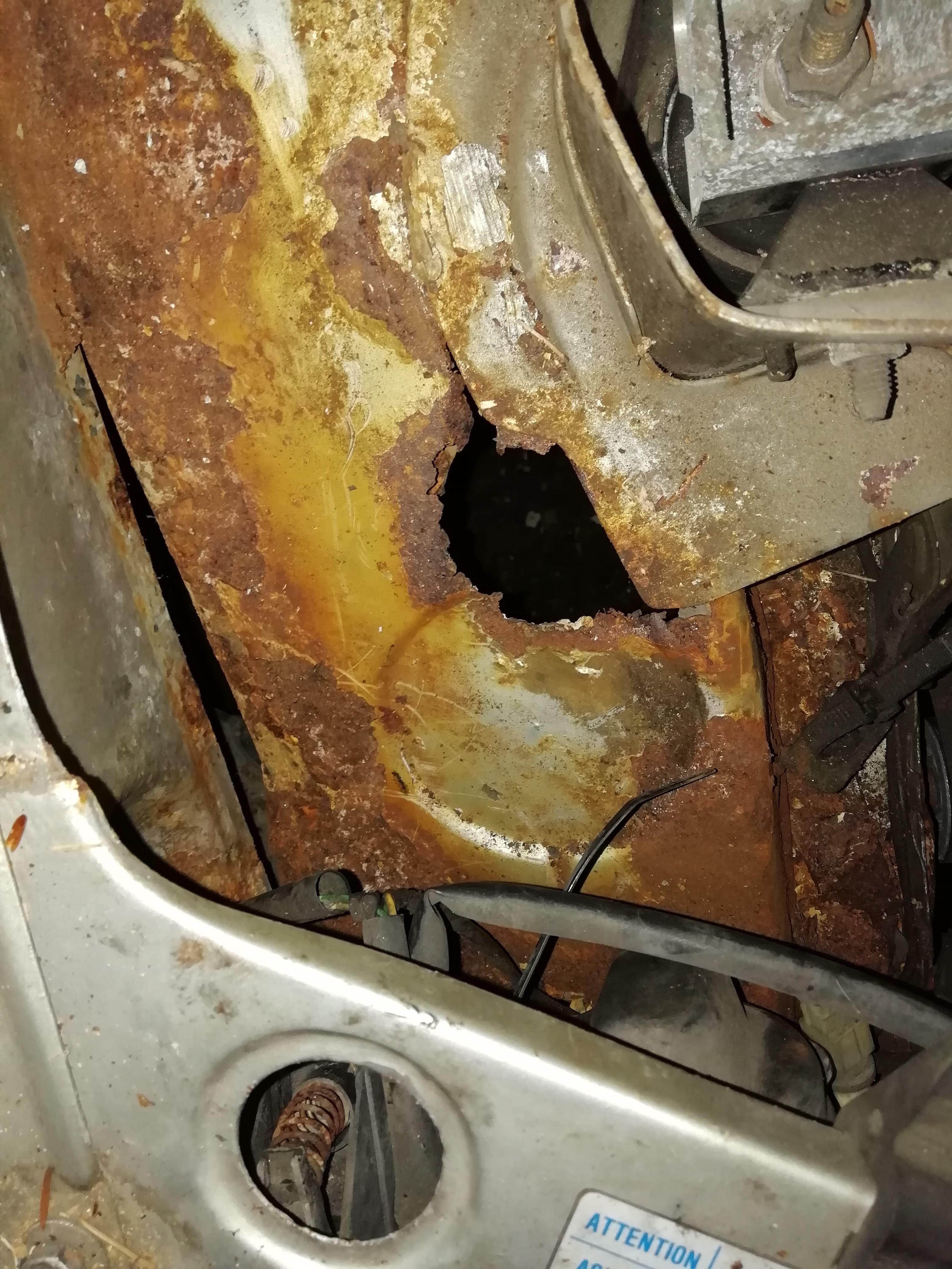

so as it stands at the moment the turbo engine is now in the car and wierd up. We test fierd it last night and it ran on what little diesel we gave it.  Ive done the "small" piece of welding as well. IMG_20181024_202416.thumb.jpg.ee94e46bea3789e38e8d11aca774c7ea.jpg
Due to time constraints its a get on the road and running before we worry about performance and looks. Though it needs a bloody good paint! something ill get sorted at some point i guess.

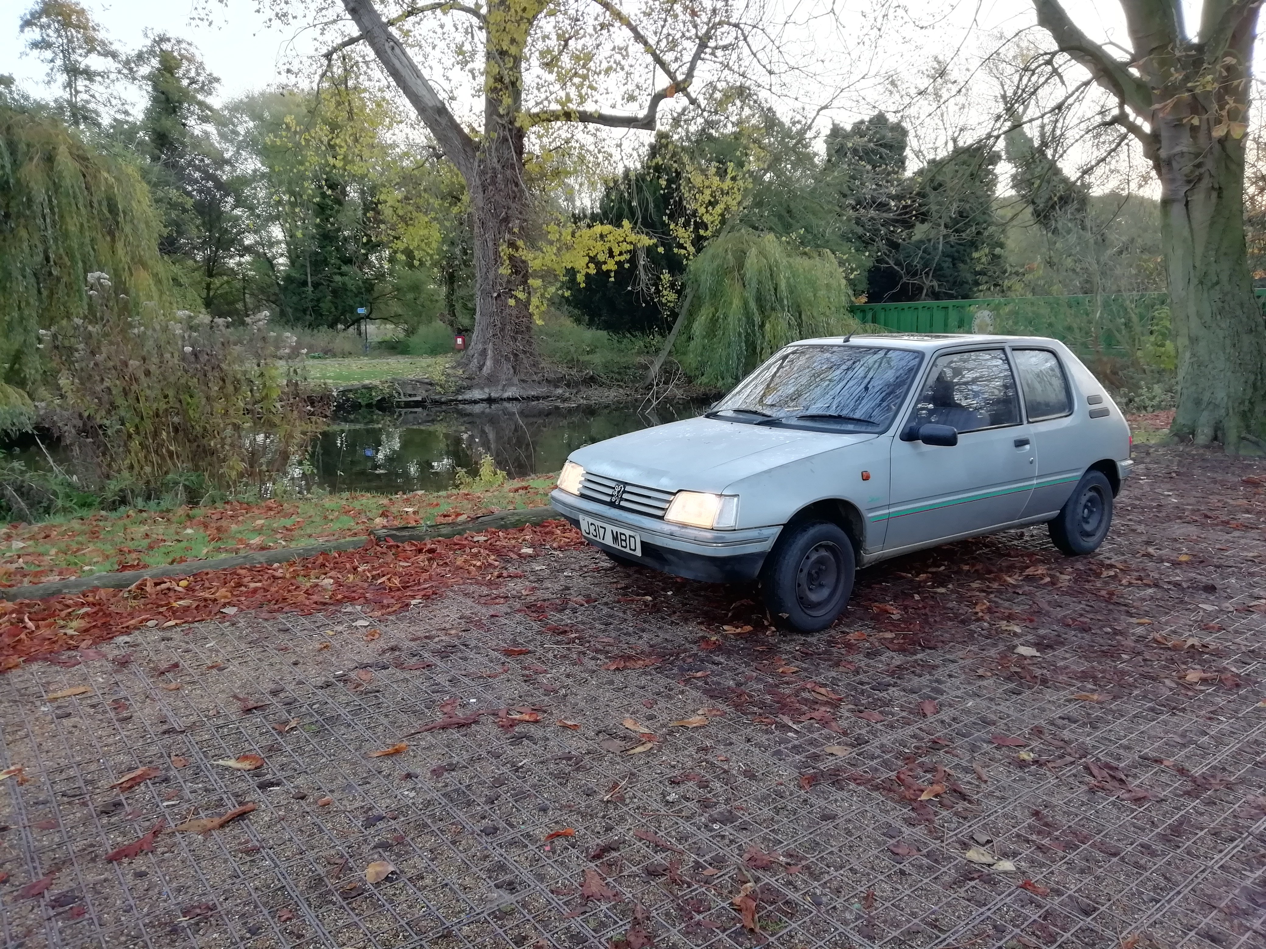

Bit of an update on this. It's now Insured moted taxed and on the road. Had a few issues. Mainly with air ingress and a dead fuel pump. A fuel pump has been built for it to go on by myself. It's a combination of an old jx T3 camper pump and pug parts. Once it made the road the feckin heater matrix blocked up. So that's been replaced as well. Managed to find a genuine Peugeot one. Need to still do loads but here a picture.
