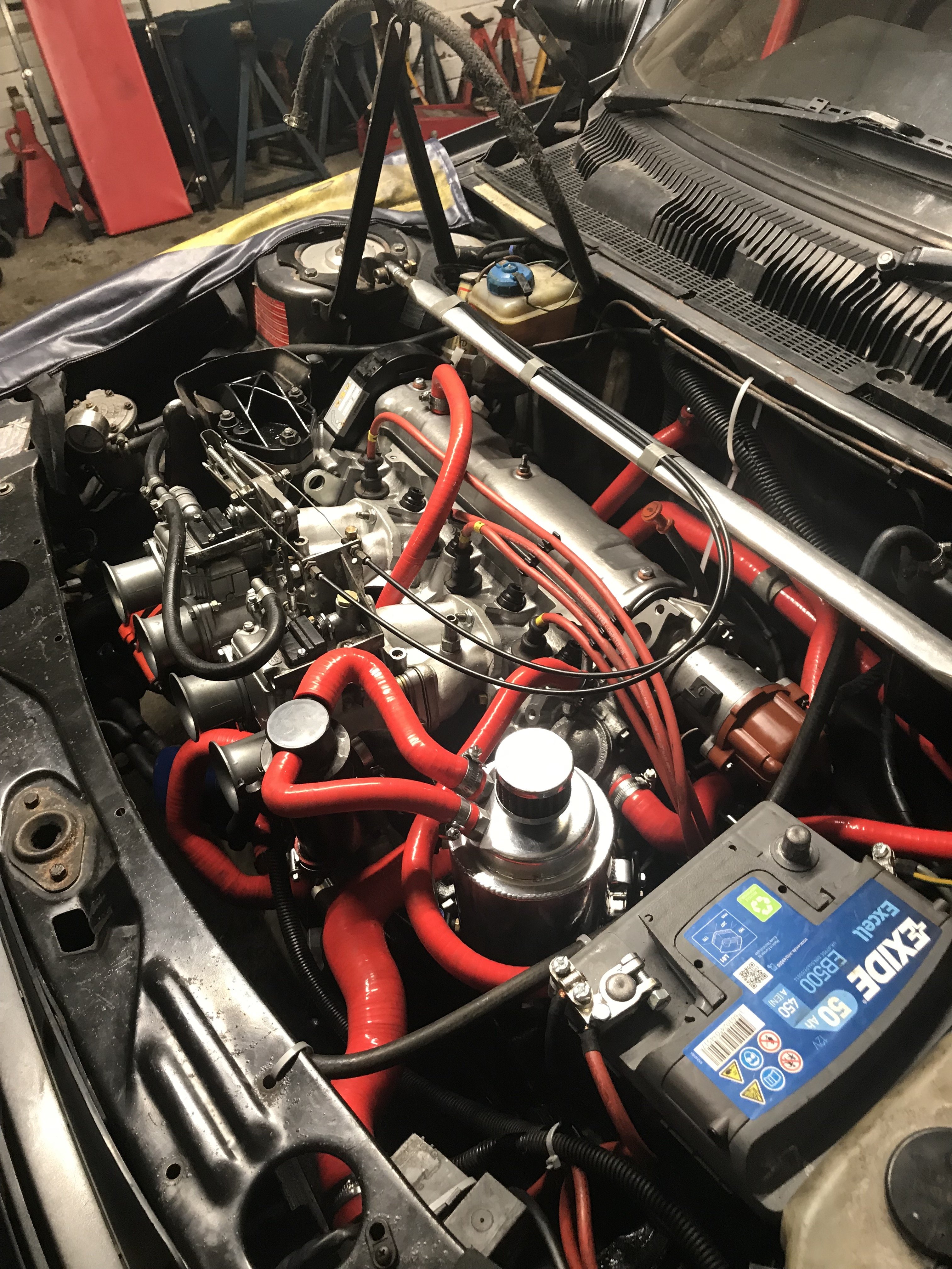

i've just started running the attached photo setup... early days but we should compare notes when I have put some miles in...
Thanks for photo of your setup, my catch tank is in similar position.
