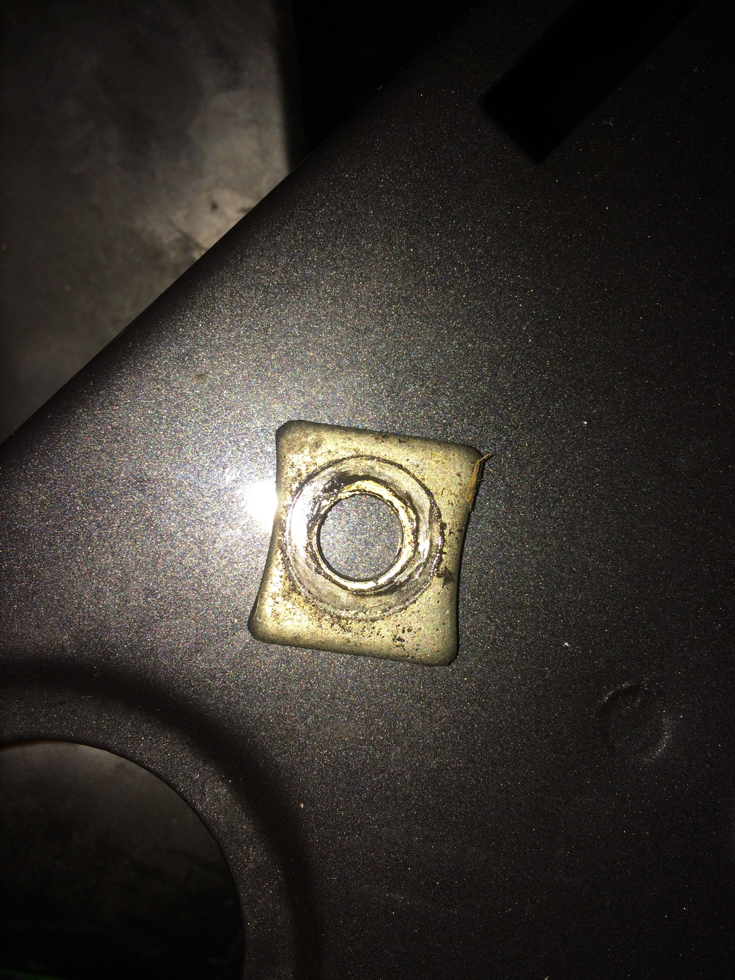

Also when removing the dizzy this fell... is it on the top or bottom mount on the inside or outside? Should there be 2?

The washer you show a picture of should be fitted under the fixing nuts upper and lower clamping the dizzy body. They often are missing.
