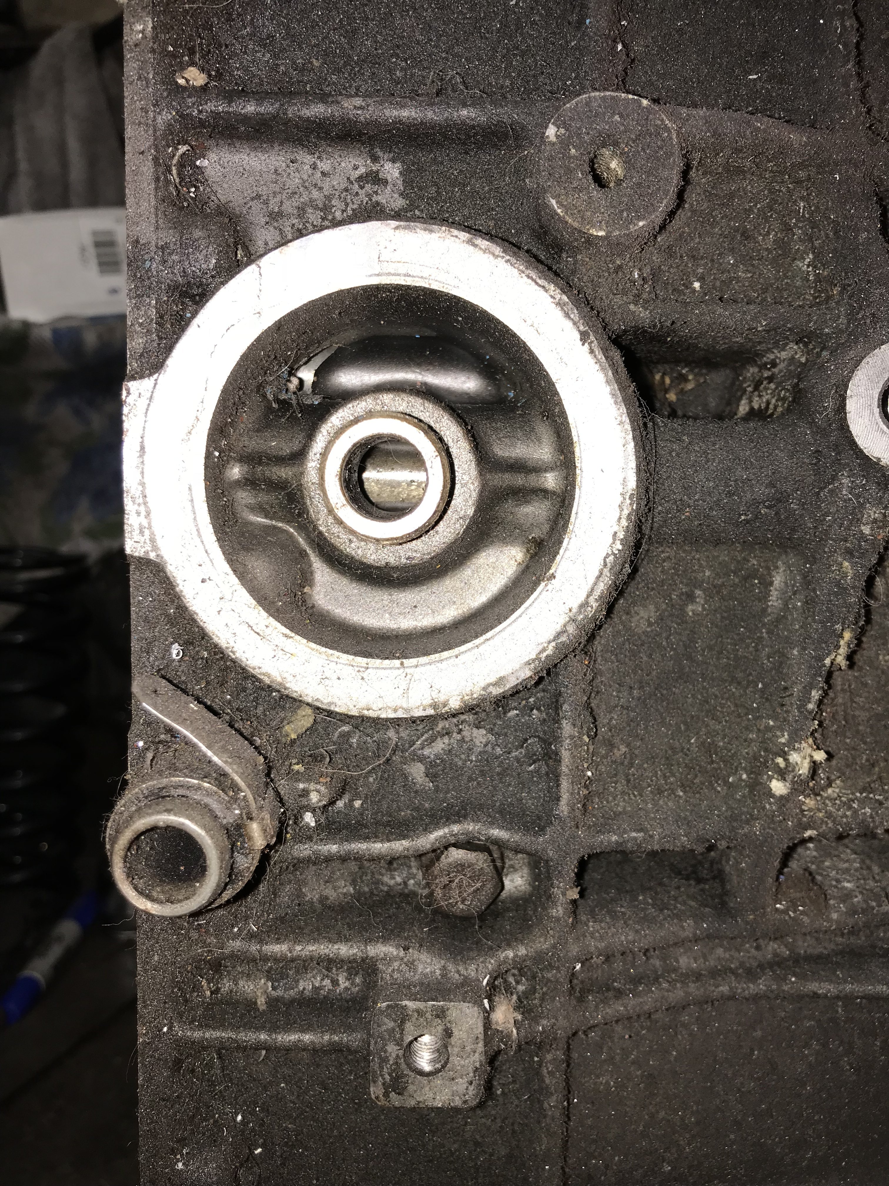

Not sure what you are looking at in the Haynes book but I’m sat here looking at my spare XU block and there is absolutely no way the filter can bypass. The oil comes from the pump straight into the outer cavity of the filter housing. It passes through the filter media and then passes back into the block via the centre threaded pipe. That pipe feeds into a gallery that runs “north/south” which then links up to the main oil gallery that runs “east/west” along the entire length of the block, just above 1/2 height of the block.
I’ve just looked in my old Haynes book. That bypass valve isn’t on the XU engines. It’s on the old XV XW layback 1100/1300 Simca engines fitted to early base model 205’s until the TU engine came along in 1987 (-ish).
