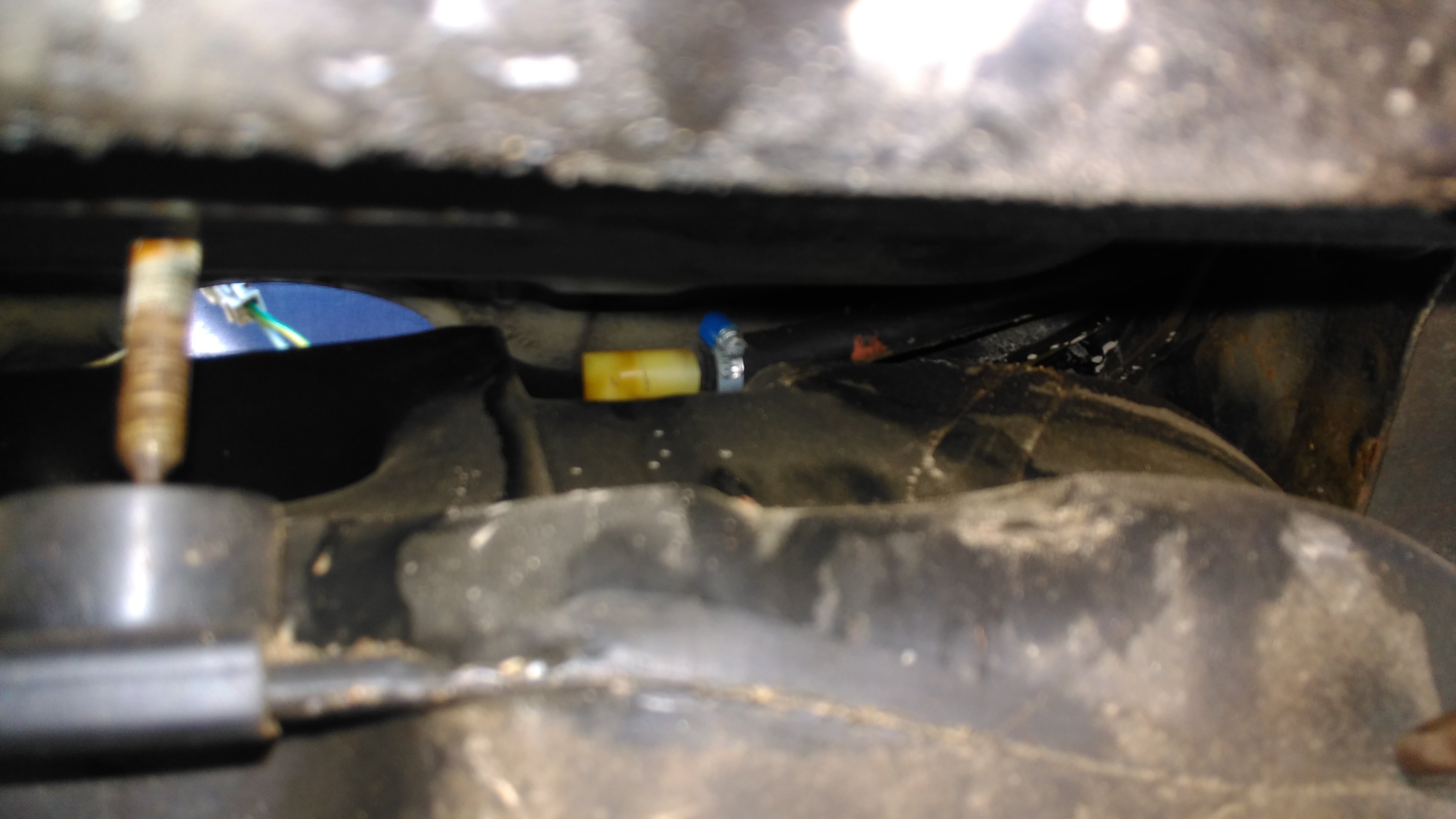

If you remove the system under the left wheel arch, should you close the line to the tank completly at the tank or under the wheel? And should you close the line on the valve also completly? i have fuel smell  on  both gtis, and iam  pretty sure its from this system.

MrStock
Thx for your replies,
@Thijs i replaced all lines from tank to fuel injectors with baker pm parts, but it didnt help. The canister looks very rusty and damaged, so i think this could be the problem.
If i remove the System as you say, where do the vapors go than? Dont they do a positive pressure in the tank? Or go the through the rear arch lines?
Thijs_Rallye
The fumes will go out the top tank breather (near the filling neck) if you close up the EVAP canister connection. If it has a really strong fuel smell in the back of the car I would suspect the top breather hose, for which the tank has to be lowered if you want to inspect it. Mine had slid off during reassembly of the tank a while ago. But I was leaking fuel as well when the tank was filled to the brim.
