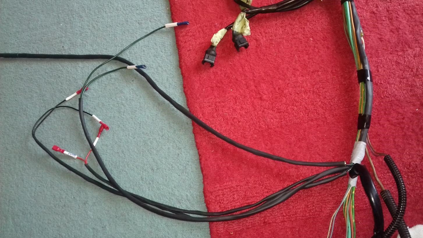

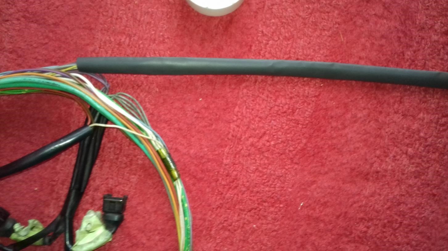

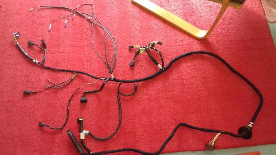

So after a few hours of cutting, splicing,heat shrinking and attaching new tags I now have no more brown plug!

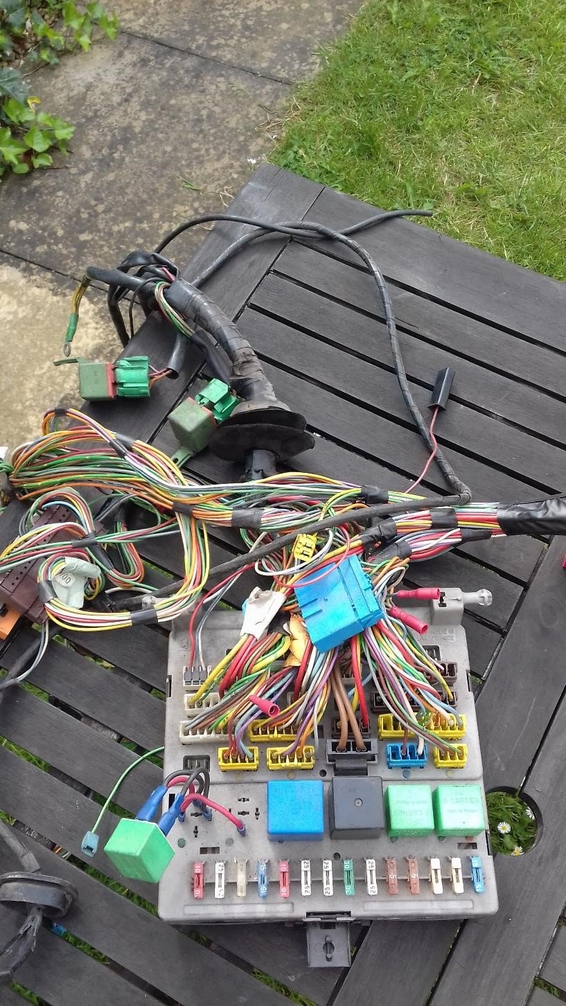

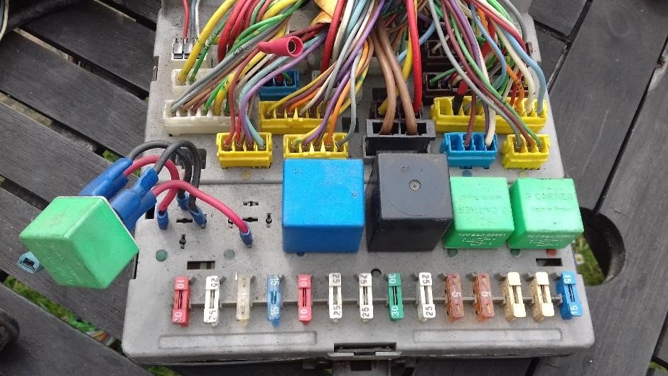

I've now set to work on the wiring and cables attached to the fuse box.
Seems on first inspection to be in reasonable condition

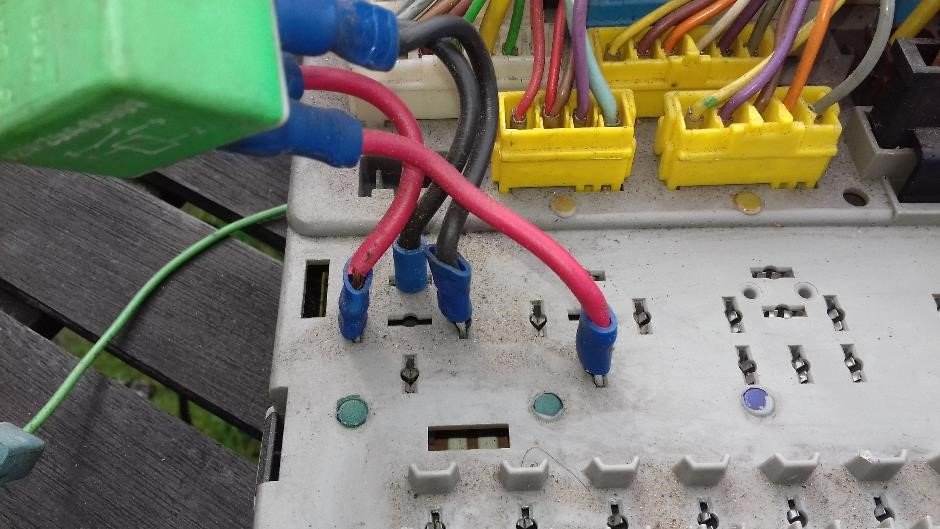

So I've stripped the plugs off my fusebox and discovered its had it. Scorch marks on one of the plugs and also the main beam/driving light relay is gashed in with jumper cables- does anybody have a serviceable item they can sell please?
you can probably repair the damaged track on the board quite easily, looks like a relay stuck open or someone used high wattage bulbs and melted it.

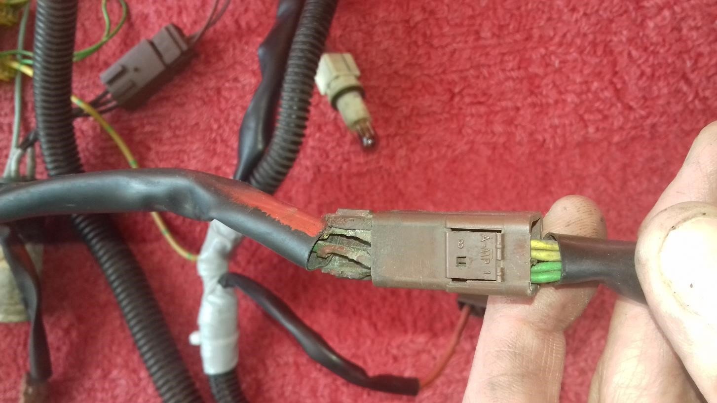

1 x Engine loom inspected, repaired and tidied up. Brown plug gone. Maybe Ill get a car to fit it into soon!

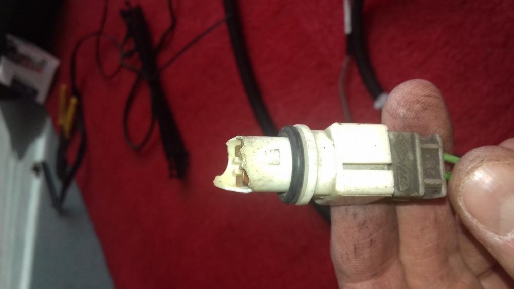

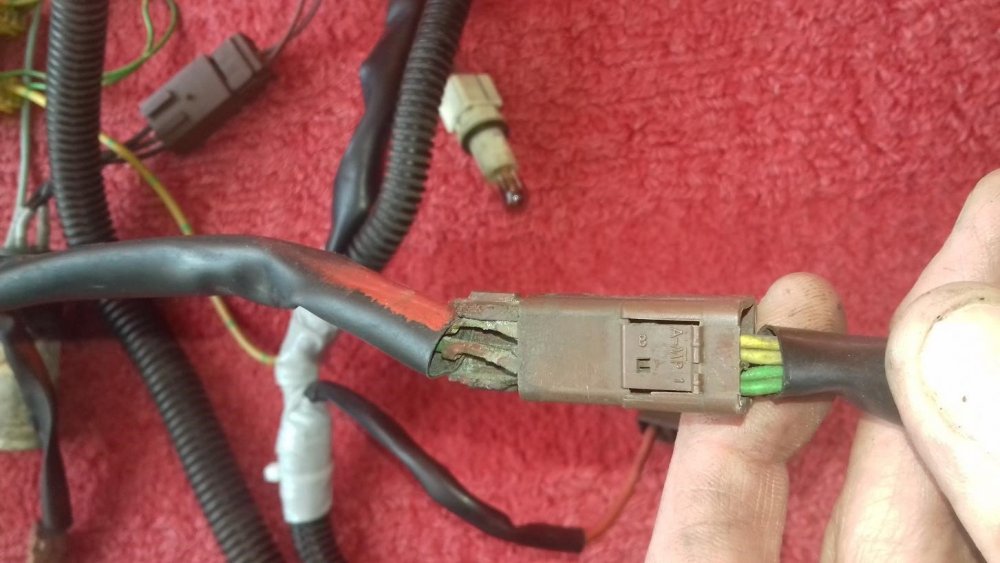

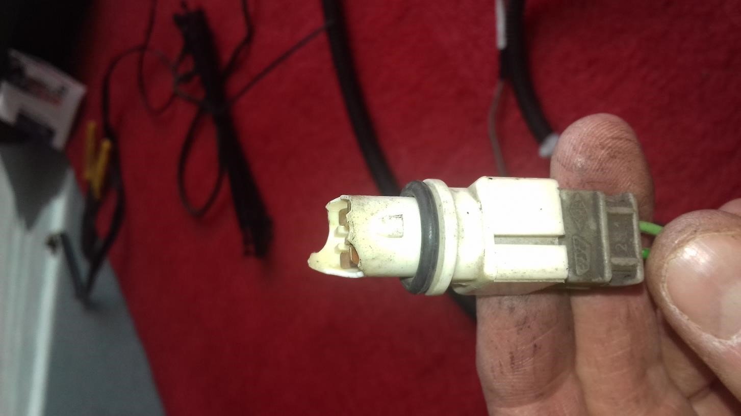

Found some damage on the other loom, does anybody have a side light bulb holder they can sell me please? Also are the brown plugs pictured still available- this one that connects the indicator on the drivers side is in a sorry state!
