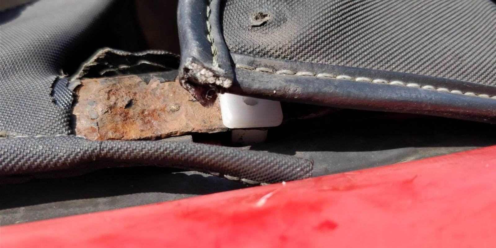

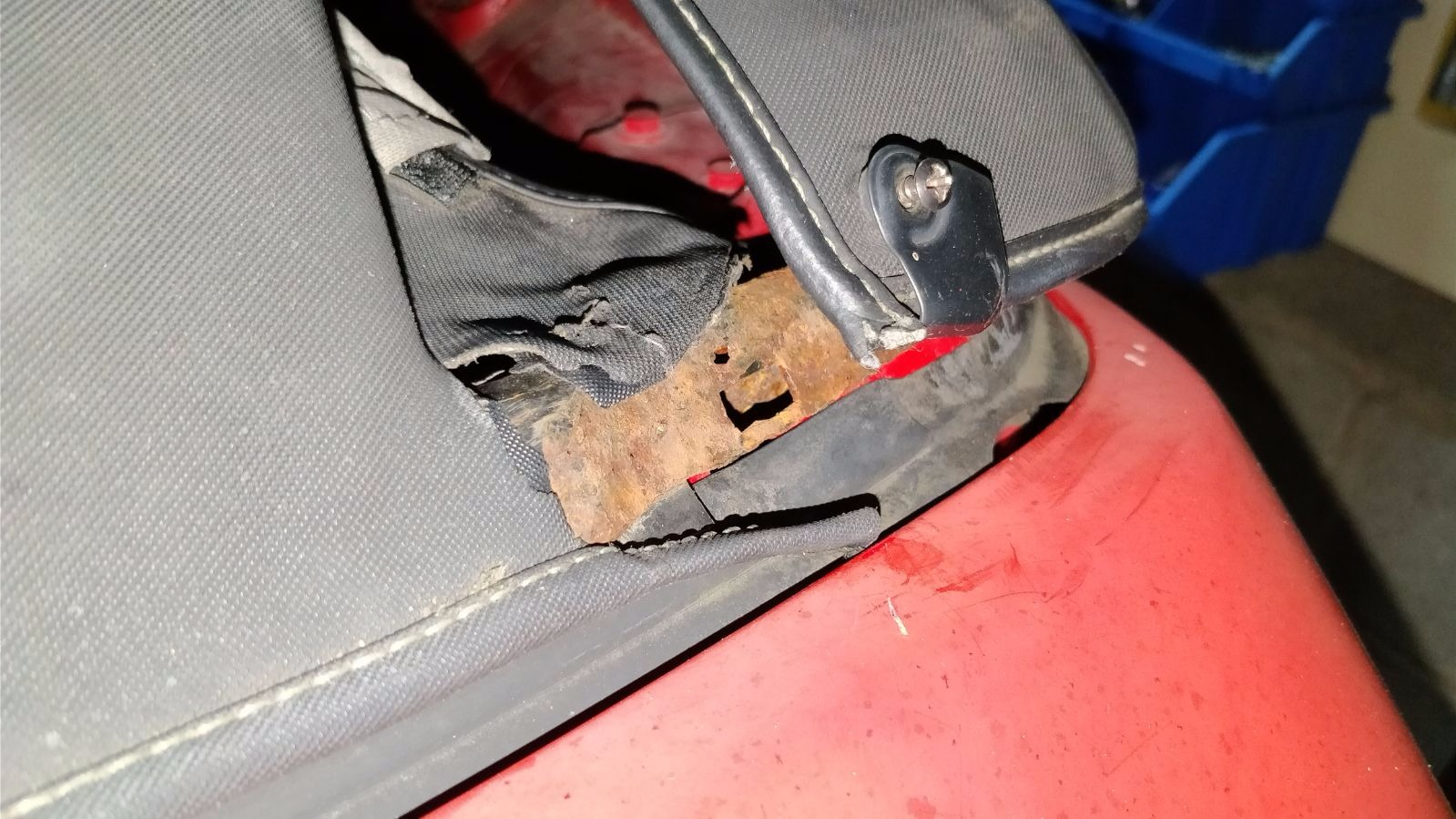

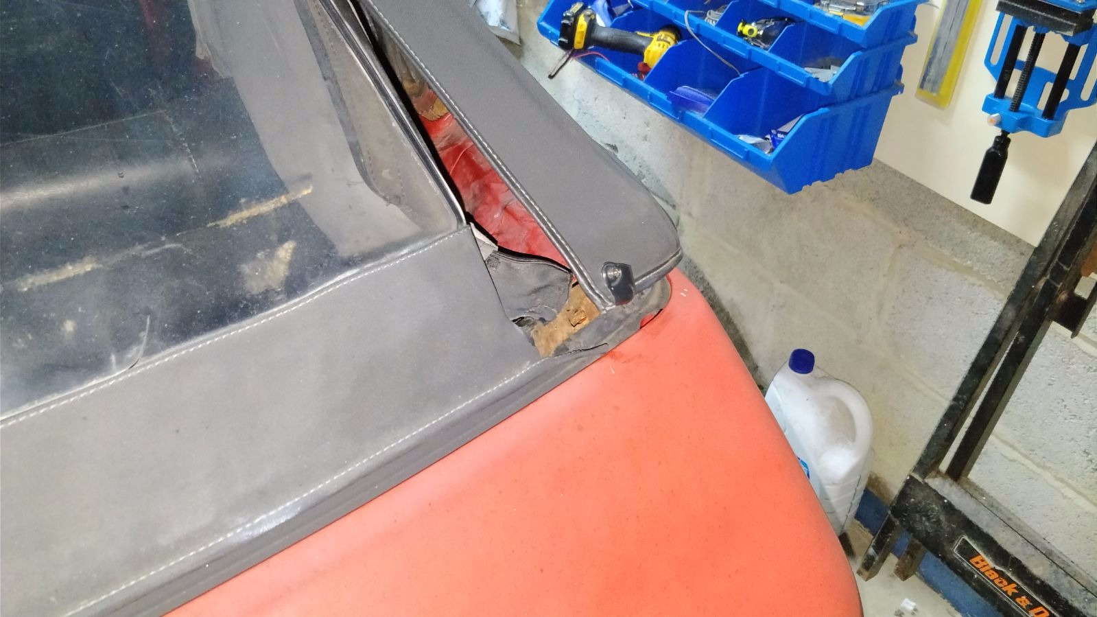

Please help identify missing plastic clip from CTI
johnyma22
Zoomed out
Zoomed in..

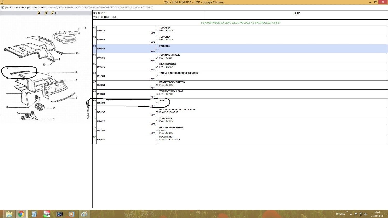

Usually the screw screws into a plastic snap in piece.  I'm struggling to find them online!
Any ideas for any sources?
Thanks!
johnyma22

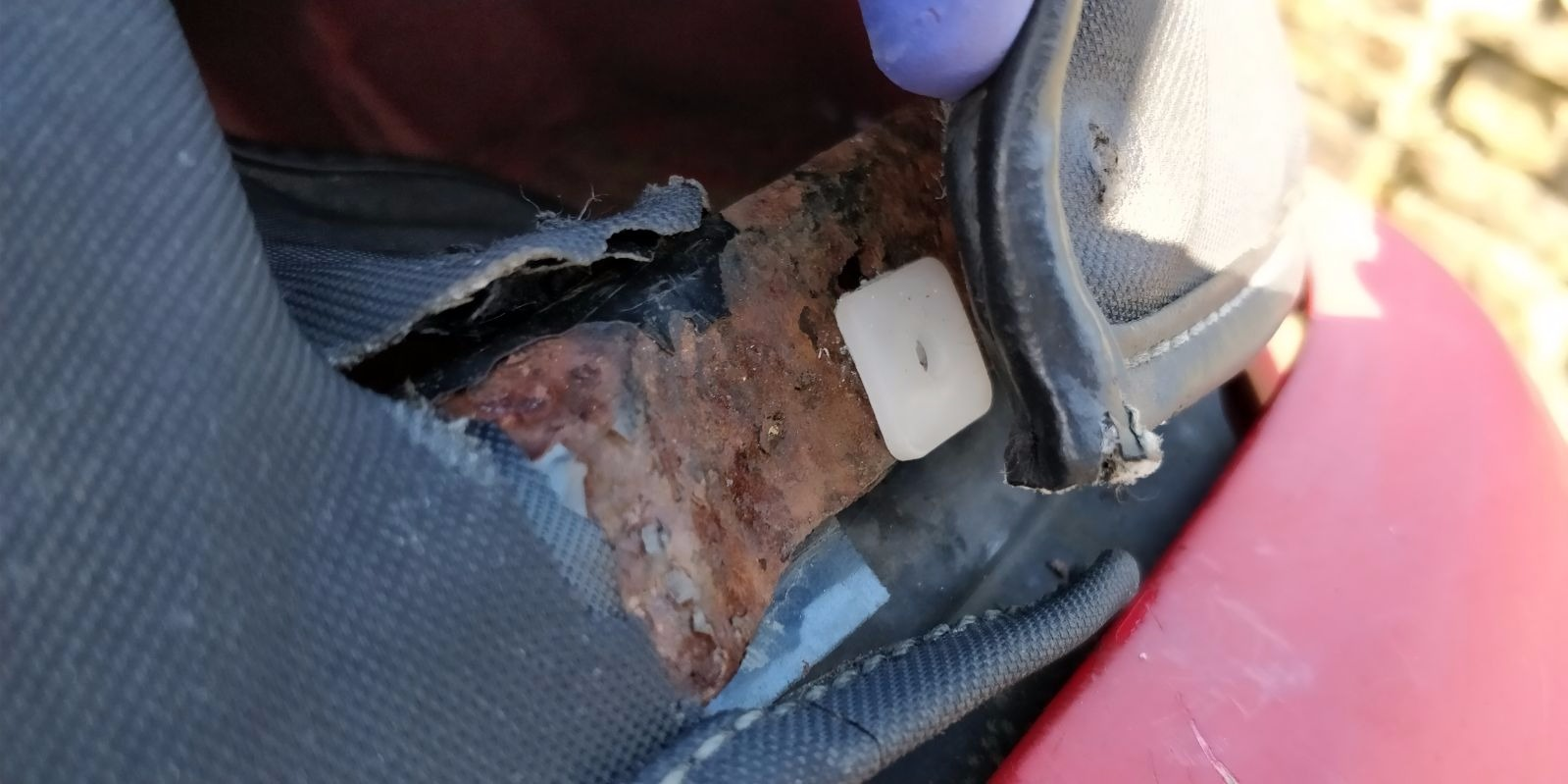

I managed to source an original soft top roof clip from another of my 205s.  I also managed to find a suitable similar clip from a pile of 205 clips I had lying around.
I uploaded some pics of the original (brown) and alternative (white) clips.  See https://imgur.com/a/ikZPm
Can anyone help identify what this clip is from? https://imgur.com/MfXfLC6 // https://imgur.com/7vJRkMI // https://imgur.com/vndkecs
I found some eBay similar items:
https://www.ebay.co.uk/itm/10-x-13-5mm-Square-Head-Plastic-Rivets-Fastener-Car-Bumper-Push-Screw-hold-Clips/222369248669?epid=935922776&hash=item33c63d759d:g:0zcAAOSwEzxYb2w8
https://www.ebay.co.uk/itm/10-x-White-Square-Plastic-Bumper-Fixing-Clips-Rivets-Button-for-Car-Bumper/162984522786?_trkparms=aid%3D222007%26algo%3DSIM.MBE%26ao%3D1%26asc%3D43630%26meid%3D96bf5eb801d54e6a8b815cbc41190dc4%26pid%3D100005%26rk%3D6%26rkt%3D12%26sd%3D282493380405%26itm%3D162984522786&_trksid=p2047675.c100005.m1851
But both are square and not rectangular..  It's a start and might help someone I guess..
Edited by johnyma22
johnyma22

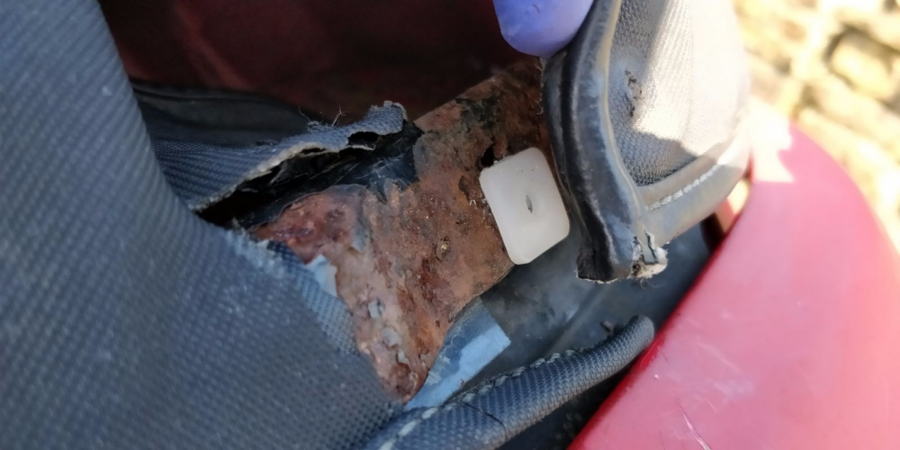

Right guys those clips came from eBay and after a tiny amount of machining down(using dremmel-esque tool) I was able to get it snugly into the hole.
image.thumb.png.9fdeb8afa92b87b8950948e2cbbfd7cf.pngimage.thumb.png.299e76d419825f0cbfed52bcdc8913bd.pngimage.thumb.png.291127464f2bd87fc318fdea42a25137.png
Hope this helps someone else in the future who has to replace their clips.  Good luck and I hope the metal isn't too rotted around them else you are a SOL (this is the case on some of my CTIs).

Finally found the full Peugeot part code..  6992 80...
