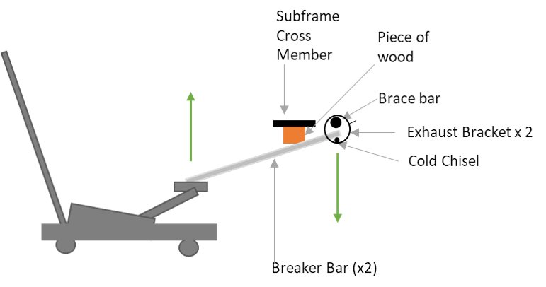

Have the same DP and likewise, mine was touching the subframe brace bar.
The brace bar pushed the downpipe up and caused the same issue - angling the end of the downpipe up too high. The cause for me was that the brace bar was bent upwards, this in turn pushed the bottom of the downpipe upwards aiming it at the top of the tunnel.
I pulled the brace bar back down using a couple of breaker bars attached to the brace bar, levered against the subframe cross member by a trolley jack.
See highly accurate diagram below...
