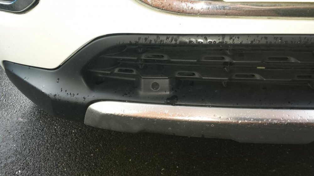

Hi all,
Been a little while since I've been on the forum... I was wondering if anyone had any experience in changing a front parking sensor on a 3008? I can't seem to find a way on getting my hand on it, any clues would gratefully be received.

Can't say specifically for those but most stuff is bumper off I'm afraid.
davev
If you don't mind working blind you can just about get to them if you remove the underside bumper fixings and pull the trim down.
