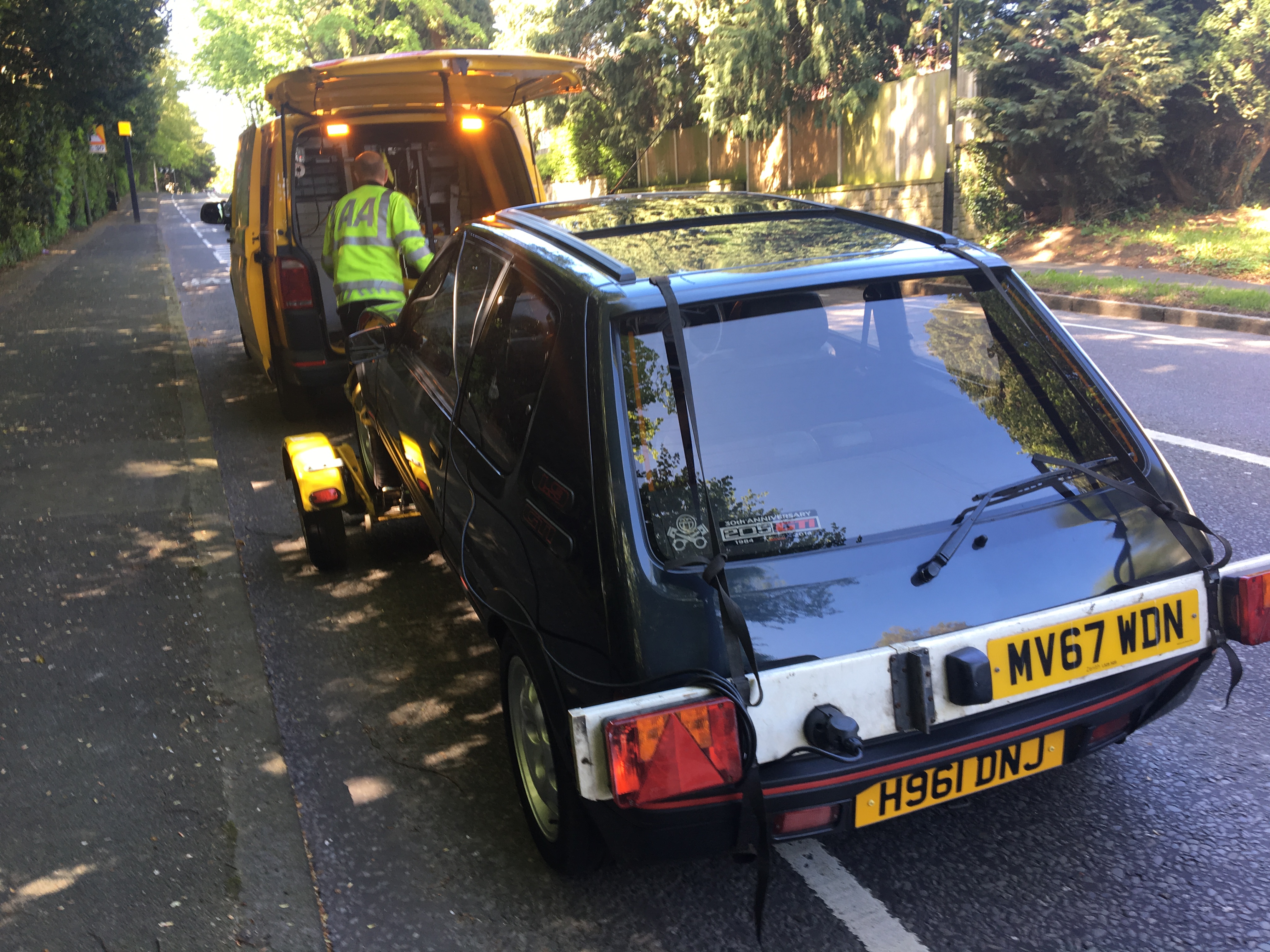

Funnily enough the AA said it could Be fuel.
I’m going up in the loft later to dig out the old laptop to check everything else.
Simes
Knackered fuel pump, all resolved.
Simes
Not true, it died after a bit of celebratory WOT on the way home from the MOT.
Same AA man as before. Car only wants to idle any throttle it dies.
i revved it for ages and it felt it was on a limited, then it finally gave in and fixed itself. Bugger.
Now thinking injectors aren’t letting enough fuel in, all the mechanical checks are ok so suspect it’s the ECU.
