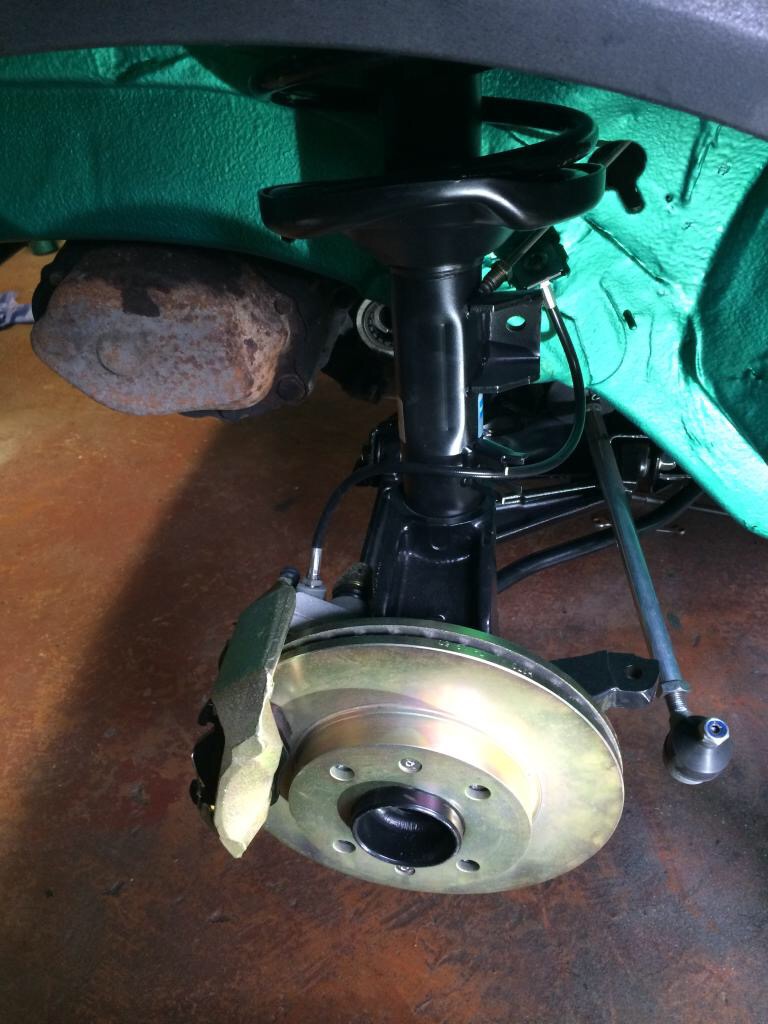

Tom Fenton 1,524 Posted January 5, 2018 Not the best pic but here are the fronts I did. Share this post Link to post Share on other sites
