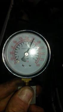

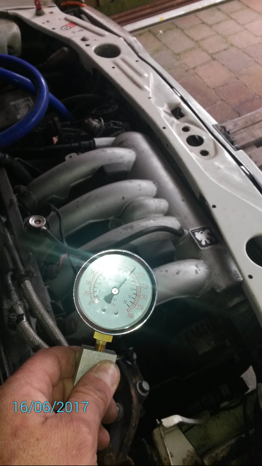

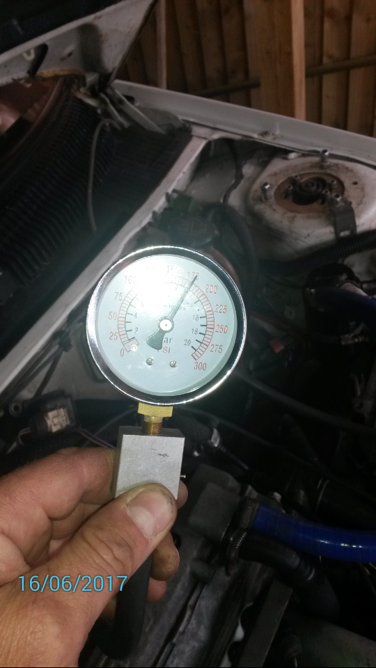

Hi , I've had a full check over on my 205 at ******* and one of the issues they said was wrong with my car was a blown head gasket.
Now there is no water in the oil whatsoever and I have been lead to believe that this may not always be a symptom of a blown gasket.
I took 8 readings on a brand new compression tester today, four when cold and four when car had ran until the fan cut in and these are the results.
These are 3 of the 8 pictures I took after every test and they all read almost identical figures.
Now as I'm only just starting to dabble in my own mechanics, are there any other symptoms I can look for to check because as far as I see it my car hasn't got a blown gasket.

Another symptom of a failed HG is your water system over pressurising caused by exhaust gases getting into a water way, and you usually loose water via expansion tank overflow pipe and/or lid.. Pipes can balloon with the pressure too.
I "think" your compression results look good, and if you've no white smoke or loss of water then your HG looks to be fine.
