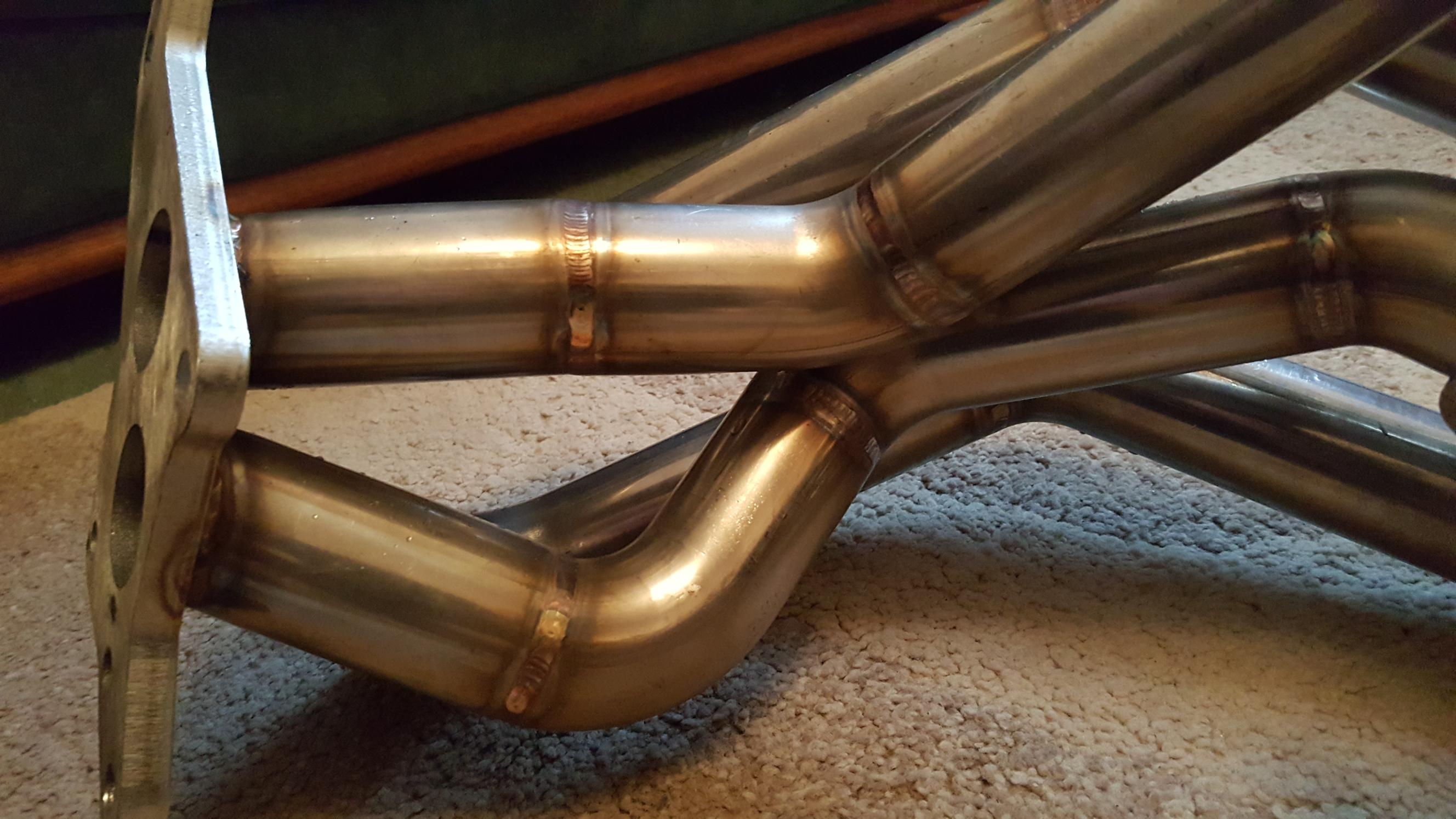

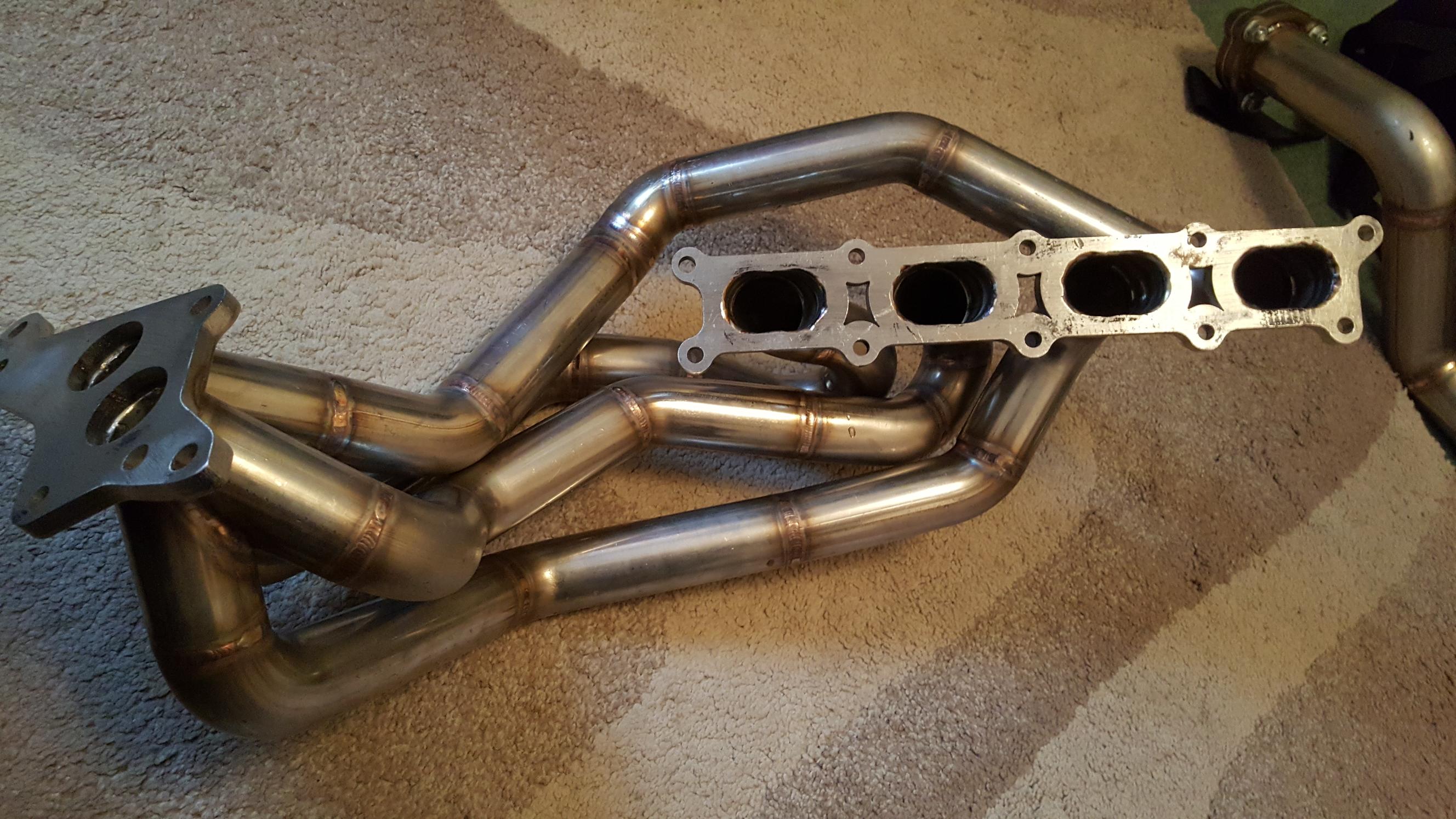

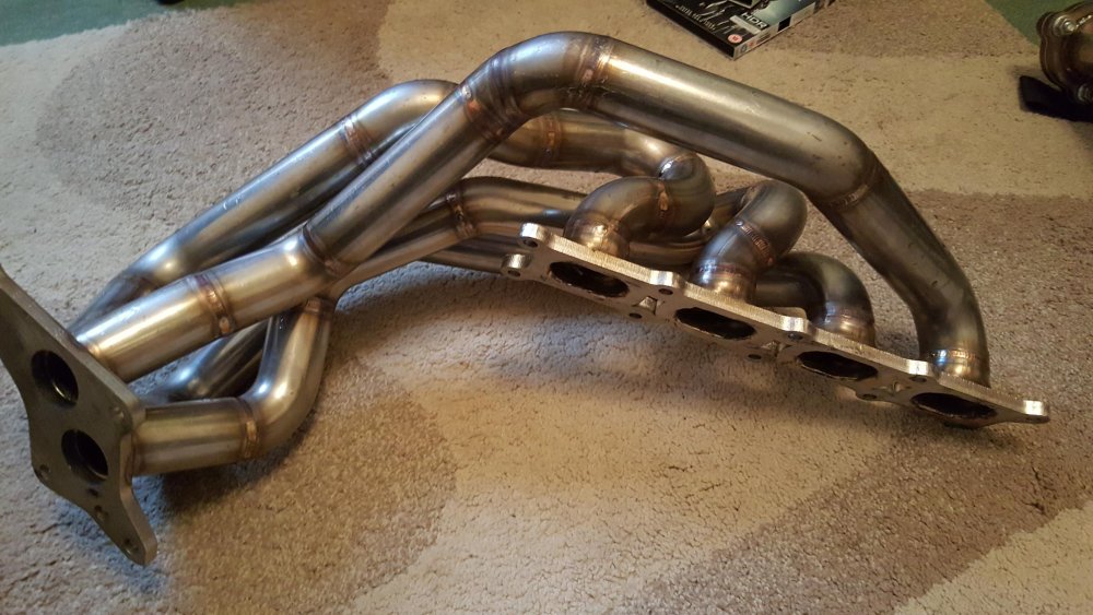

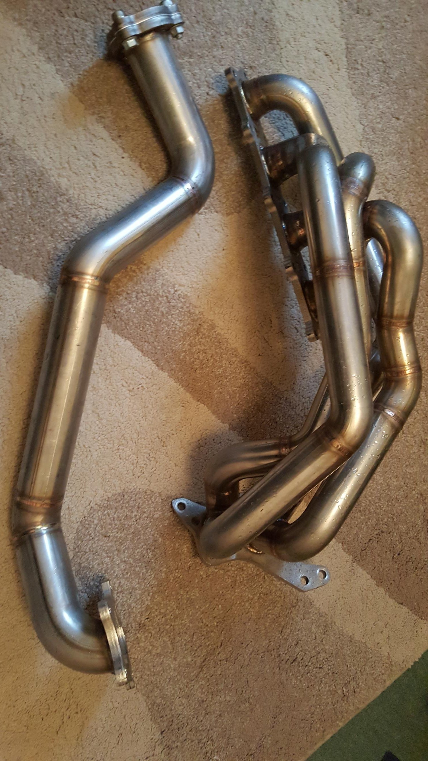

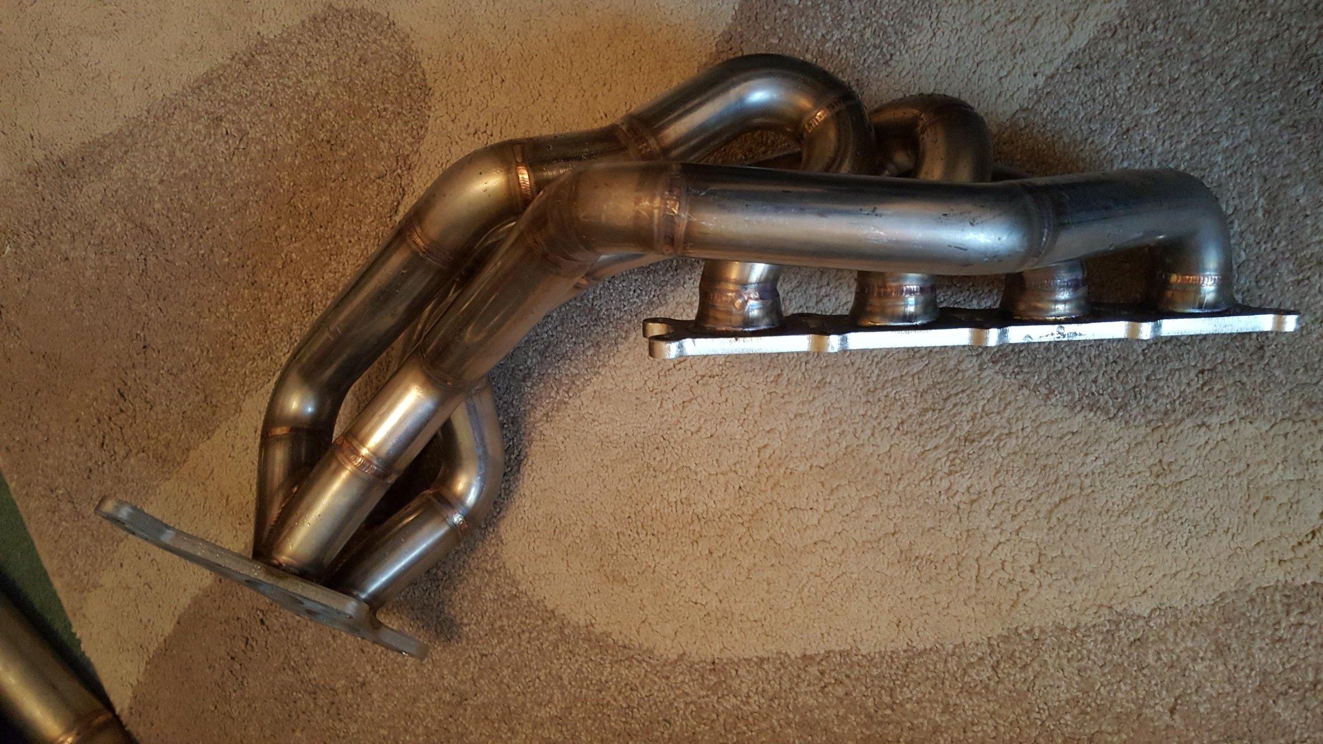

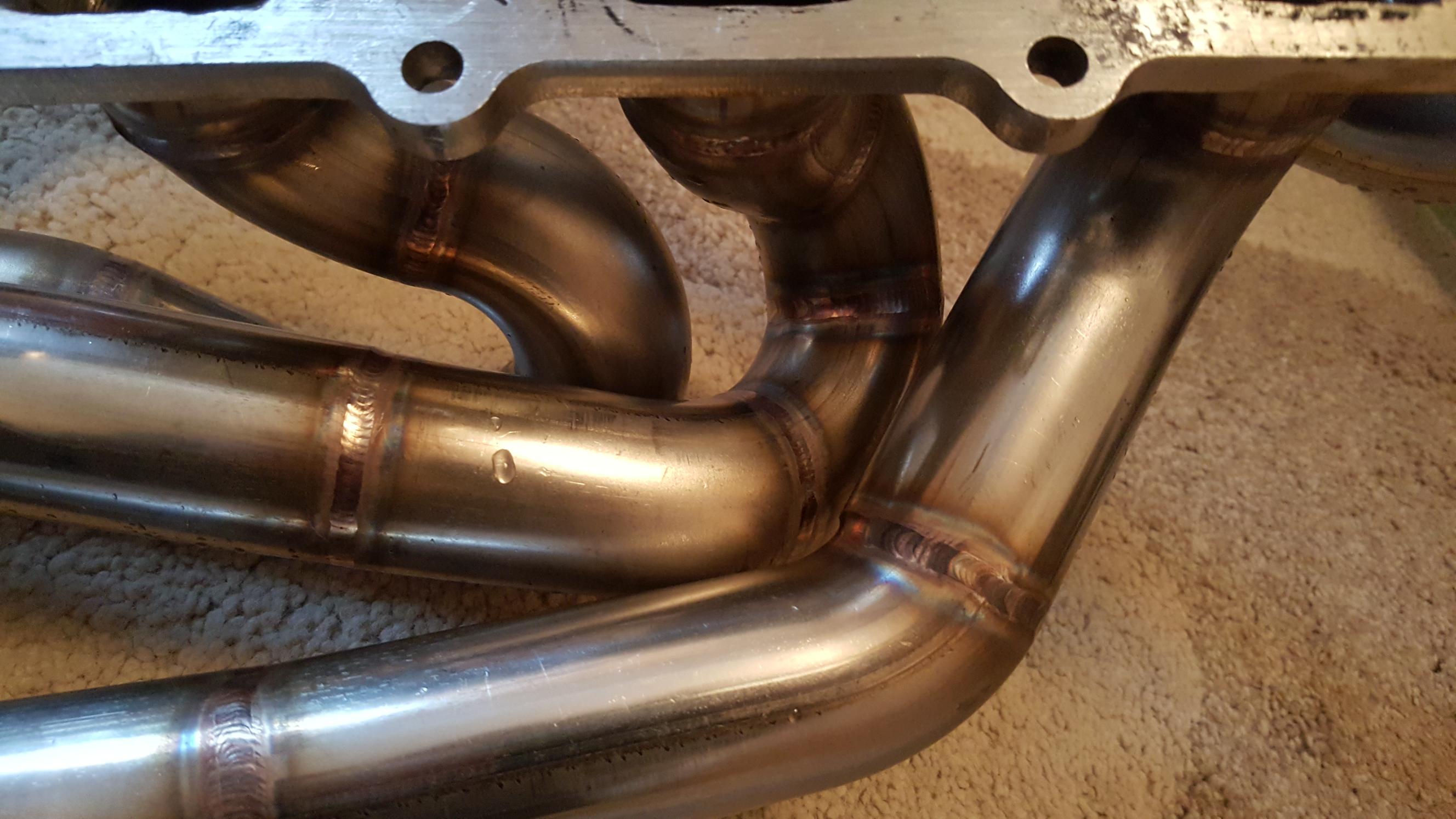

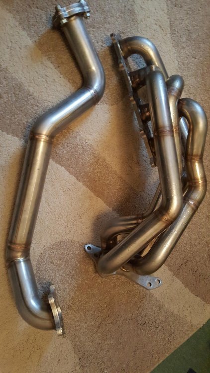

Quite a lot of weight for the runners to support. It also means the turbo or manifold can be removed independently. Plus it all moves together, which overall means it should all last longer.
Fair enough, different ways to skin a cat and all that! Was more curious as there’s obviously 2 sealing faces/gaskets now but it’s fair reasoning.
We made a bolt on affair to the manifold flange.
Looks a hefty turbo, really looking forward to the results with the twin scroll set up, crack on! :P
johniban

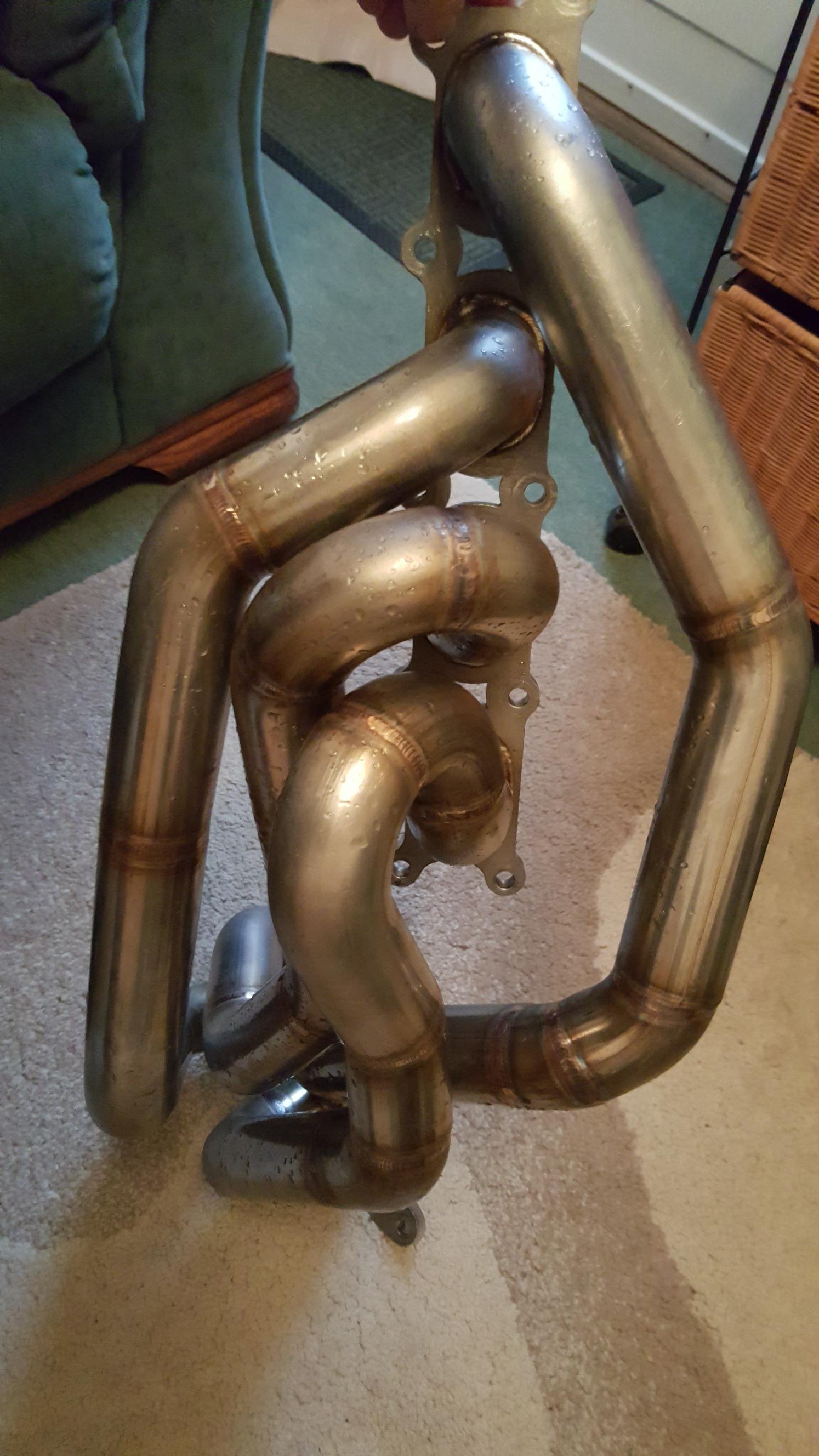

Very nice manifold! you'd do well to mock up a few  more of them for sale!
wicked
Nice progress!!
Must say you have a lot of space under the hood (being a xsara and RHD).
I've been working on a similar setup and don't think this manifold will fit in a LHD 205 (smaller engine bay, break booster and steering column taking space).

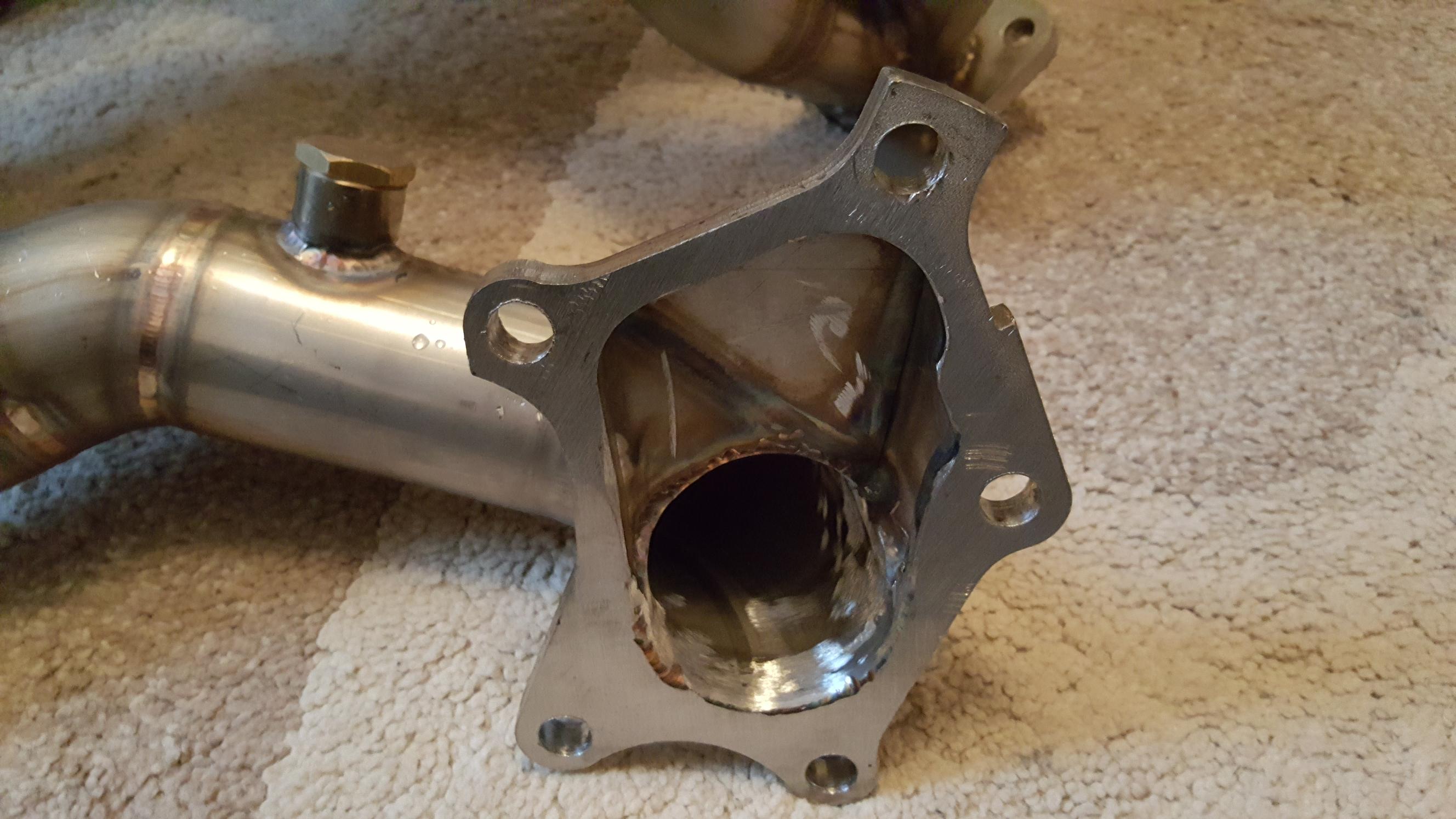

Regarding the lambda bung; seems to stick out a bit far? Will the sensor be long enough?
Edited by wicked
DrSarty
Mike's assured me the lambda bung is fine.
One reason I went Xsara (or considered a ZX or even BX for that matter) was giving me space to work in versus a 205. It's luxuriously cavernous in there!
When I get the manifold out I'll measure it so you can consider it for a LHD 205. Be aware that it cost £1,200 before you get excited though. Type/grade of steel used, inclusion of downpipe, matched runners with pairing etc contributed to price BTW.
Thanks for your comments.
Edited by DrSarty
wicked
If Mike checked it, it will be ok. Would be a pity if it was overlooked and you would end up with strange behavior because of bad AFR readings.
Don't bother measuring it; from the pictures/down pipe routing it will be a big no-no for LHD. Keep it a your DrSarty's one-off manifold.
