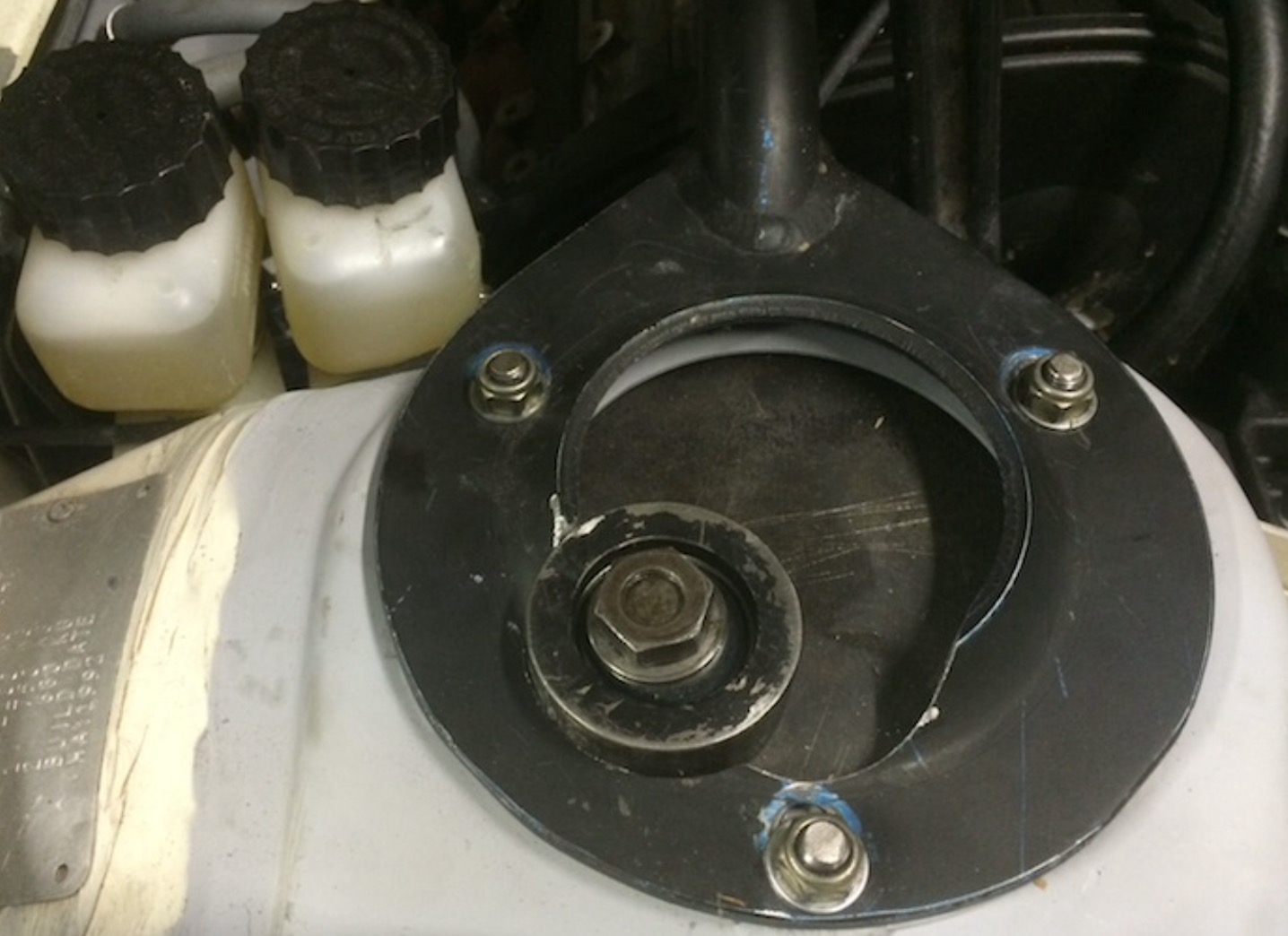

What front arms do you run? You need to dial in as much caster as you can. Do you think this is within the rules?
Edited by petert
SweetBadger
We run 309 front arms combined with hubs machined for -ve camber (Bridgecraft).
So approx 3 deg -ve camber.
Caster is set to the max possible using the eccentric top mounts. i.e. pointing towards the rear of the car. Not as much as shown in your pic though!
I think that'd be allowed within regs as it's still the original pickup points.
sounds like you may well benefit from something like a satchell front end, they do one for a 205 using standard pickup points and damper positions but with revised track rod and wishbone angles, wishbones are adjustable so you can add castor and small adjustment in camber.
If you want a reasonable amount of caster however, you have to move the top back. Otherwise the tyre hits the front spoiler. You'll be lucky to get past 4 deg. Even then you need to do some creative body work. If you look closely at pics of Colin's car, you'll notice the strut top centres are way back.
