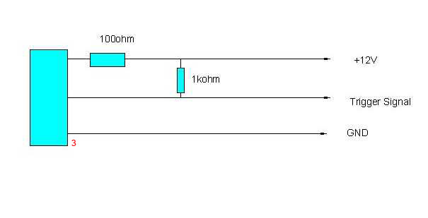

But somehow I found this file on my PC that Petert have made sometime in the past.
Adding some resistors to the wiring. Is this a general way of wiring such sensors, also applying for the MS3 Pro, or should it not be necessary?
Are anyone able to shed some light on the topic?
The 100Ω is a current limiting resistor. I don't use it anymore with the XU10J4 sensor. It's proven to be reliable taking a straight 12V input after many years of service. The 1kΩ is a pull up resistor, designed to hold the trigger input at +12V until it's grounded by the sensor, helping to create a very square input wave. I don't use that anymore either, as my ECU has it as a check box input option. I have no idea with the MS3 Pro but it was necessary with older Siemens hall effect sensors and older ECU's.

I would be shielding it as a matter of course. Earth the shield back at the ECU. Having just the 1KΩ resistor can only improve the situation, if it's not already toggled in the software. Adding the 100Ω resistor will slightly decrease the voltage available at the sensor.

Sorry, I didn't mention, but if using the current limiting 100Ω resistor, it needs to be at least 5W. Otherwise it will quickly self destruct. I don't think the actual trigger position is vitally important, provided it is happening before #1 trigger event, which is approx. 112º BTDC? It's a question you'll need to ask on an MS3 forum.

I would remove the 100 ohms from the supply line; in general it's not good to have resistance in the supplies.

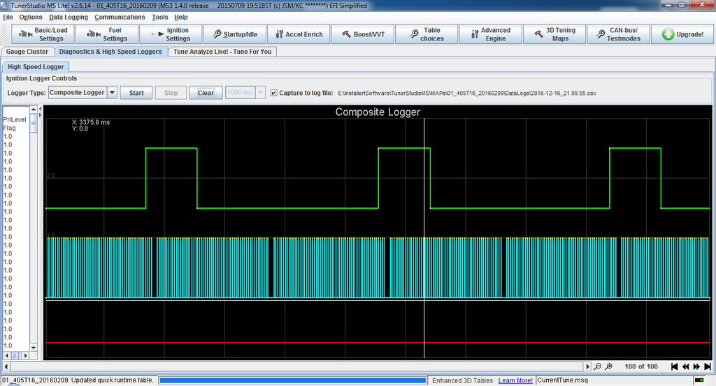

I did some investigations today, and did some minor adjustments in the software setup, including adding some software based "filtering" to the signal.
Now it looks like this and works with proper Coil On Plug setting.
Is this correct then, the CAM sensor seem to trigger just before the 60-2 wheel arrives at the missing teeth.?
Yes, that would be correct. If 60-2 setting is 115º BTDC, then cam sensor should fire at 120º for example. In some ECUs, the cam sensor is also the end of the injection period. Meaning you should ideally make sure the cam sensor triggers before the inlet valve closes. With standard mild cam timing, you would want this to occur at around 125º BTDC. You'd need to do some researching in the software and on-line, to determine whether you have software control of the end of injection point.
